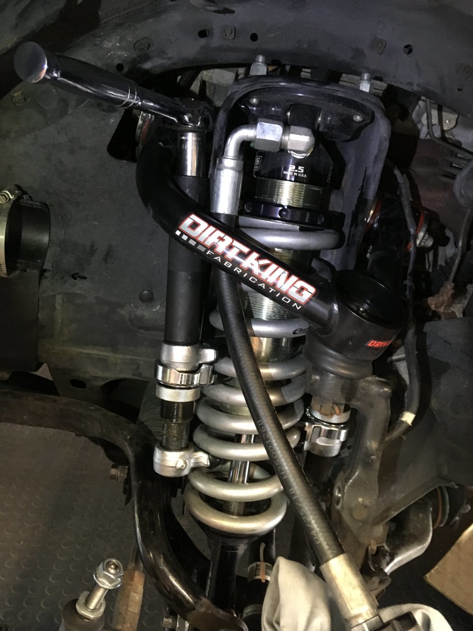

    Finally made the complete switch to ADS. Had the fronts for a while, and just recently got the 12” smooth bodies for the rear. I had to build up the courage to chop and weld in the BAMF shock relocation. I also ditched the BAMF lower axle mounts for some Total Chaos mounts.

    I love me a 12" smoothie of the ADS flavored variety.
