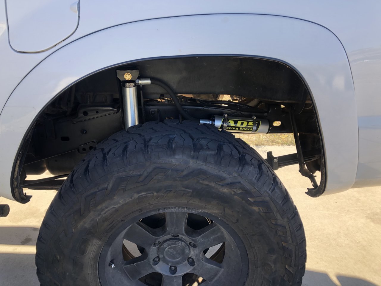

    The OE staggered setup (one shock on each side of the axle) was to reduce axle wrap. Do you notice more axle wrap after the shock relocation?
    TRDguyKC[QUOTED] likes this.

    Kris
    Sierra Vista, AZ
    Honestly I don’t notice any more at all. And I came down to GA which is ~5500 ft lower altitude, so I have been enjoying my new found power with the skinny pedal and still haven’t notice any difference at all vs my previous stock location icon 2.0’s
    ready6delta and 3JOH22A[QUOTED] like this.

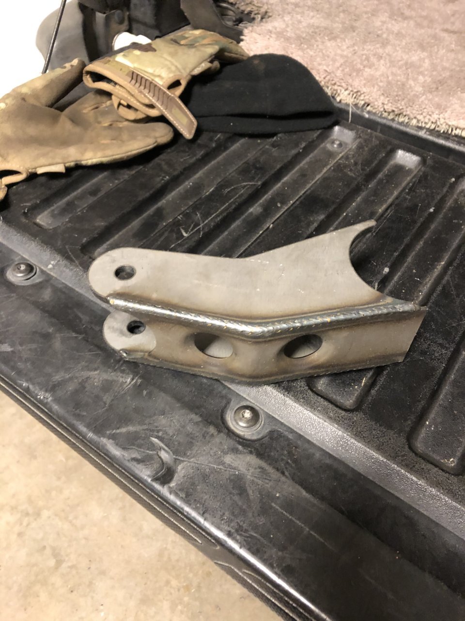

    honestly I like the archive relocation kit better. Just that the BAMF kit was $160 shipped and the archive is like $450. But it’s a good looking shock tower
