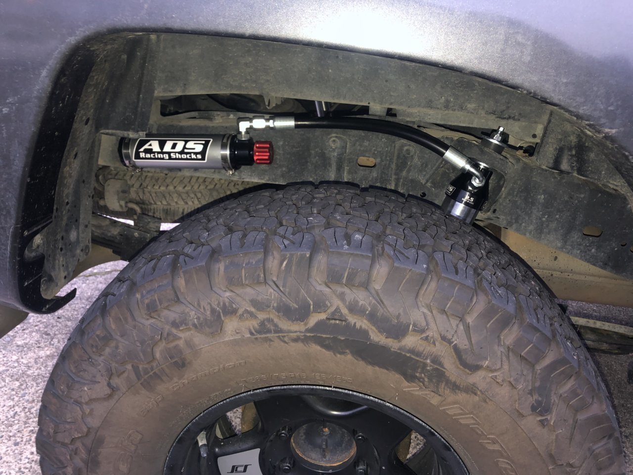

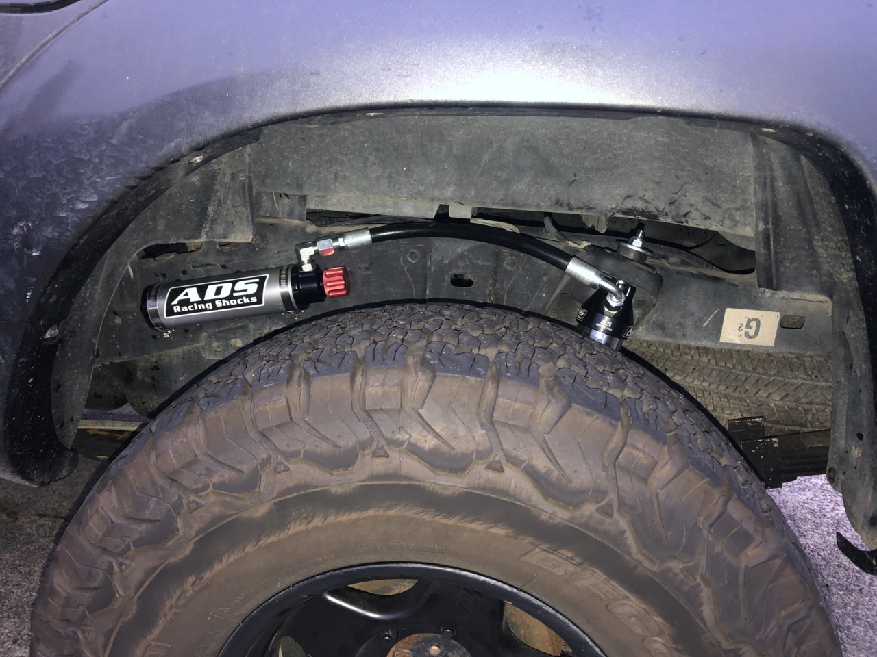

    How’s this mounting look? Pretty much just guesstimated the brackets. Only had time for the rears this past weekend

    Anyone know what size punch fits in the collar for adjustment?

    Pretty sure it's 5/16

    thats what kings are so I’m assuming they should be the same. Thanks

    Regular bumps aren’t adjustable but you can stack washers to get varying height if needed. Once you get your new setup, stuff and stretch it and measure the shock extended and compressed and get a bump that will save it from topping out. Super bumps, Duro and timbrens are all good options. Hydro bumps might be adjustable I’m not sure as i haven’t Even gone down that rabbit hole yet.

    Yep 5/16 should be a few options down below in Amazon links. Or just hit up Home Depot Or something and find a decent handled one.

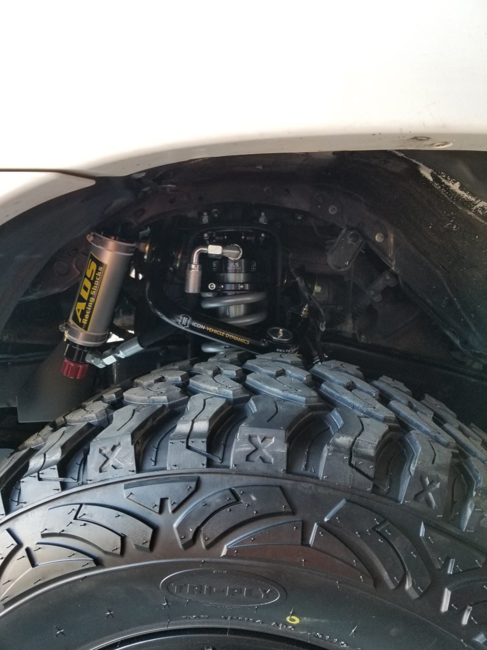

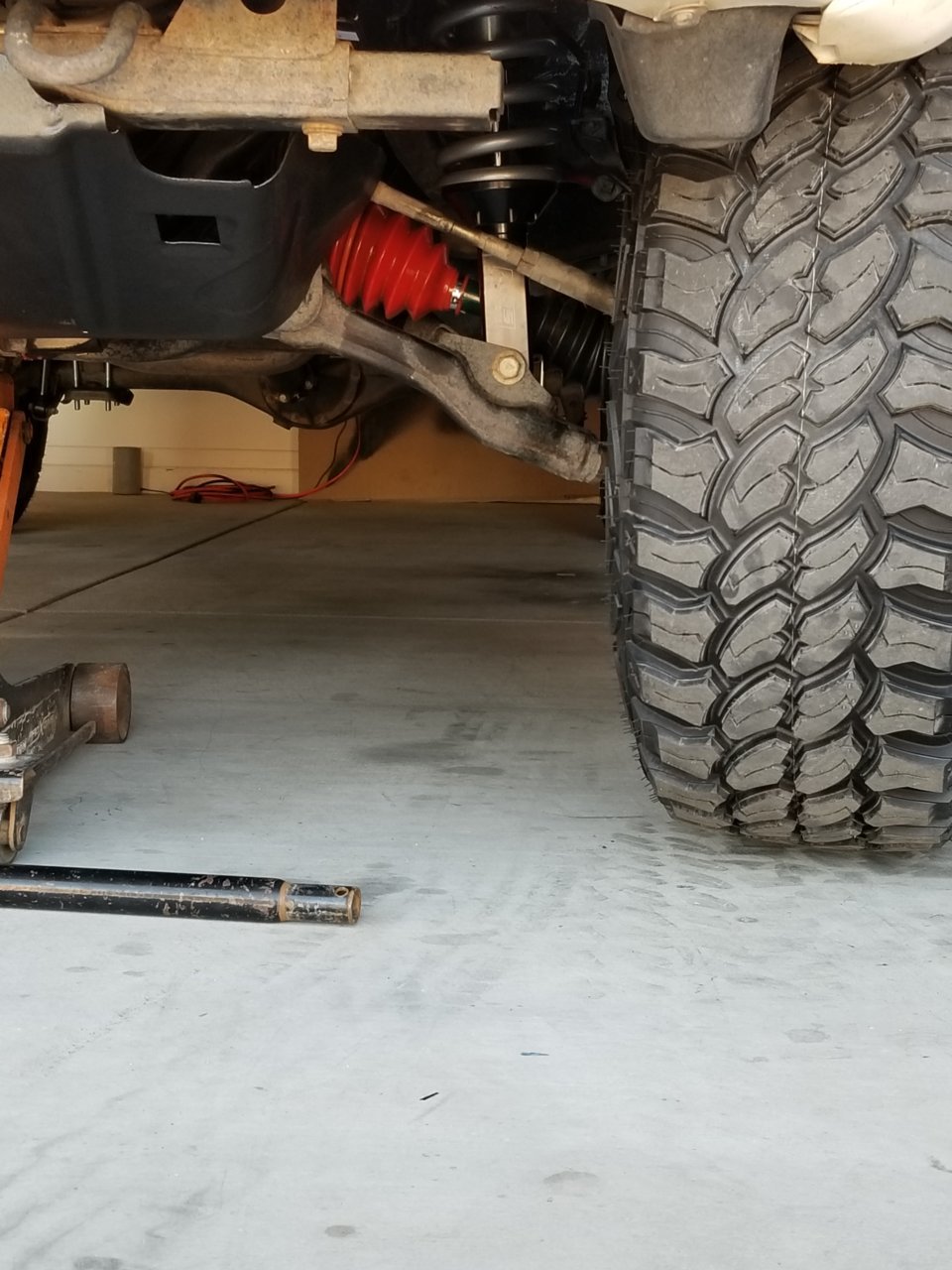

    Just thought id share a few pic on this thread of my current build.
    2011 Tacoma SR5
    Ads's Adjustable's on all four
    Icon UCA's Delta joints
    Icon Add a leaf
    East coast gear supply needle bearing replacement
    CVJ Axles
    SCS Ray 10's Sitting on Pro comp M/T 2 285/70-17
    Crown performance Brake lines
    Timken wheel hub bearings
    Spicer U-Joint's
    And plenty more to come!
