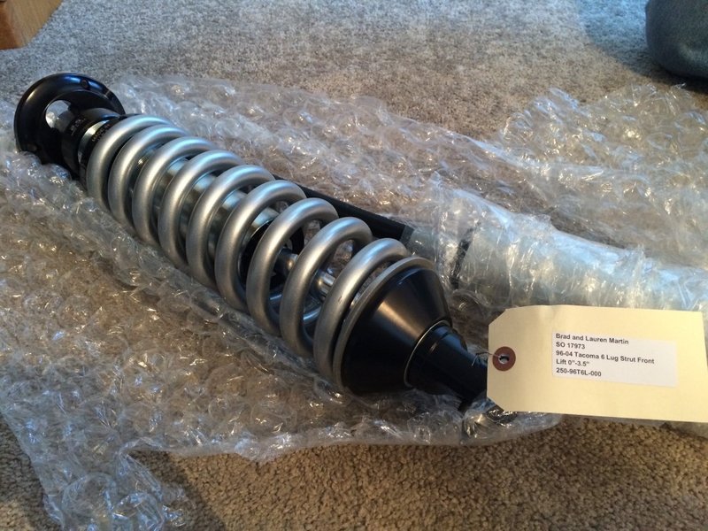

    I don't have the clickers, and I'm not sure what weight the springs are. We just called the owner of ADS and told him what we had planned to do with the truck and things and sent us these. I had Toytec COs previously and while they did me well for years, these thing blow them out of the water as far as ride goes. Here's mine:
    The tag of what I got:
    You'll need UCAs too. My stock ones hit the coils at full droop.

    I've horse I can see just part of the specs on the pic of it mounted and it looks to b 14" springs 3" inside diameter but the last few # r the weight rating and I can't see those , also how much lift and amount of thread showing above the collar ? Thanx

    I have about 2 inches of thread above and below the collar. I just left them as they came in the box which is 2.5". They ride so well I didn't want to mess with it lol I'm just a tiny bit low in the front.

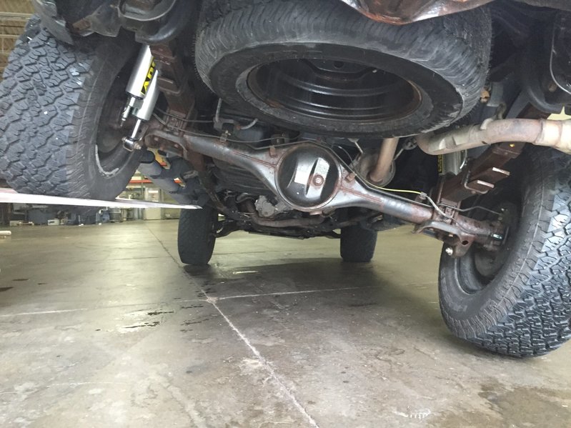

    Also here's a little test I did over a speed bump. My last setup the whole truck would raise with the bump. These ones are sweet because you can see how much they absorb the bump compared to my rear end (which is similar to how my front was). It's cool hearing them hiss over bumps too.

    At the dealer none the less :p
    I haven't had the chance to take it back to this spot yet to compare...my sweet 1" jump haha

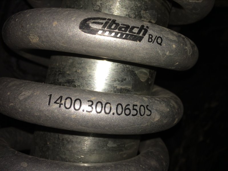

    Those ADS coils have 650# springs. I had too much preload set on mine when I ordered them and had to back off an inch or so because it was too hard a ride. Once I get my plate bumpers and winch and odyssey battery bolted on I will try to set it back up an inch on preload.
