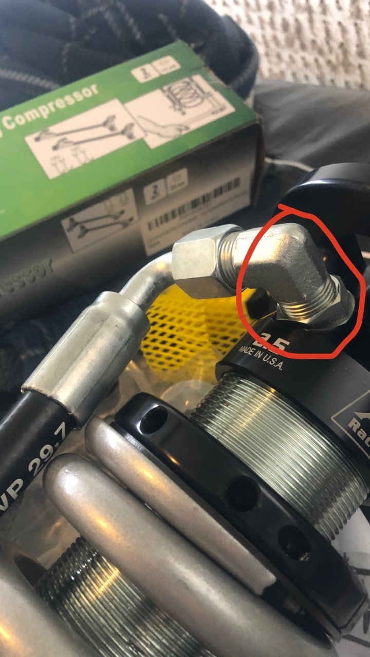

    Anyone have a good way to tighten this bolt? The hose moves up and down pretty easily. Super hard to get a wrench on the bolt. As you an see, is shifted downwards towards the spring

    not a bolt, its a pipe thread. If it does not leak, and is oriented in the direction desired, then its not a problem, otherwise the 90 degree fitting needs to make a full 360 degree turn into the shock, to tighten it more, and get it back to the desired position.

    Hmm okay thanks. Doesn’t appear to be leaking so I’ll probably just leave it

    That's an ORB fitting, the threads are straight cut. Level out the 90 so the hose clears the spring and tighten the jam nut. That fitting should not be loose in any way.
