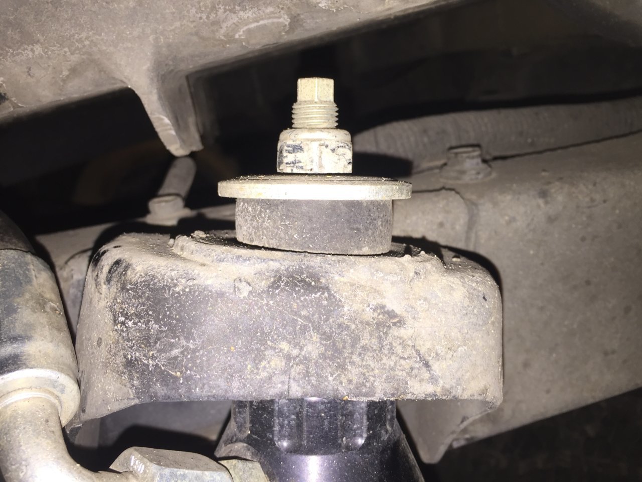

    And check the torque value spec. It is quite low, to allow some angular movement in that mount. The rubber should not be squished by over tightening the top nut.

    You can also compress by hand. Once you get over the initial resistance it isn't too bad. I did and I'm far from beastly

    Anyone else have pics of this to compare to?

    mine looks about like that, from memory.
    I think the torque spec seems silly low, like 15lbs?

    Oh...I’m way above that. I used an open end wrench because I couldn’t get the socket on there with the torque wrench between the bed and the nut. I used a bit of strength to get that but down to that many threads...hope it’s not too much.
    Would that make the rear feel stiff if it was?

    I have no idea, i'm well above 15 as well...haha. I don't imagine it would make it too stiff, the rubber bushing shouldn't be dictating ride characteristics (IMHO)
    I'll step out to my truck and see what it looks like

    Maybe some of the more experienced will weigh in. There was no directions when installing the shocks and when I called ADS they really didn’t seem to know. I mentioned 50-70ft lbs and the guy was like “that sounds about right”...lol

    I mean, it can't be doing any harm. Think about how much weight is on the bushing under the shock mount.
    Granted, the full weight of the truck is carried by the springs but the shocks do experience a fraction
    I dunno, just my non-engineer mind, i really have no idea
