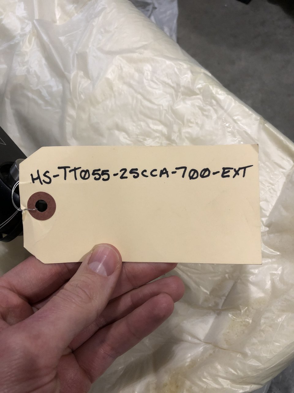

    I have been following this thread for the past few days. I have sitting in my garage a full set of ADS extended clicker shocks and coil overs. Just need to install them. My thoughts on this is that are the people that are not as happy with them maybe lifting the truck to much? An IFS truck can only give so much. I tell you what though. I travel 6 hrs on the highway to get to the good dirt trails and I do not miss my lifted wandering, guzzling, death wobbling money pit of a Jeep. I don’t get all the flex that the Jeep offered but instead get a really nice ride all around. The Taco takes me where I want to go just like the Jeep did. I’m curious though if extension of the shock is limited and how much it is with the extension dash jarring prevention spring in place. My set up currently is Bilstein 5100s in the front and holy crap do they make a thud that comes all the way through the dash when I extend them to the maximum. So if these ADS coil overs effectively prevent that and maintain adequate extension of the coilover, my hat is off to ADS.

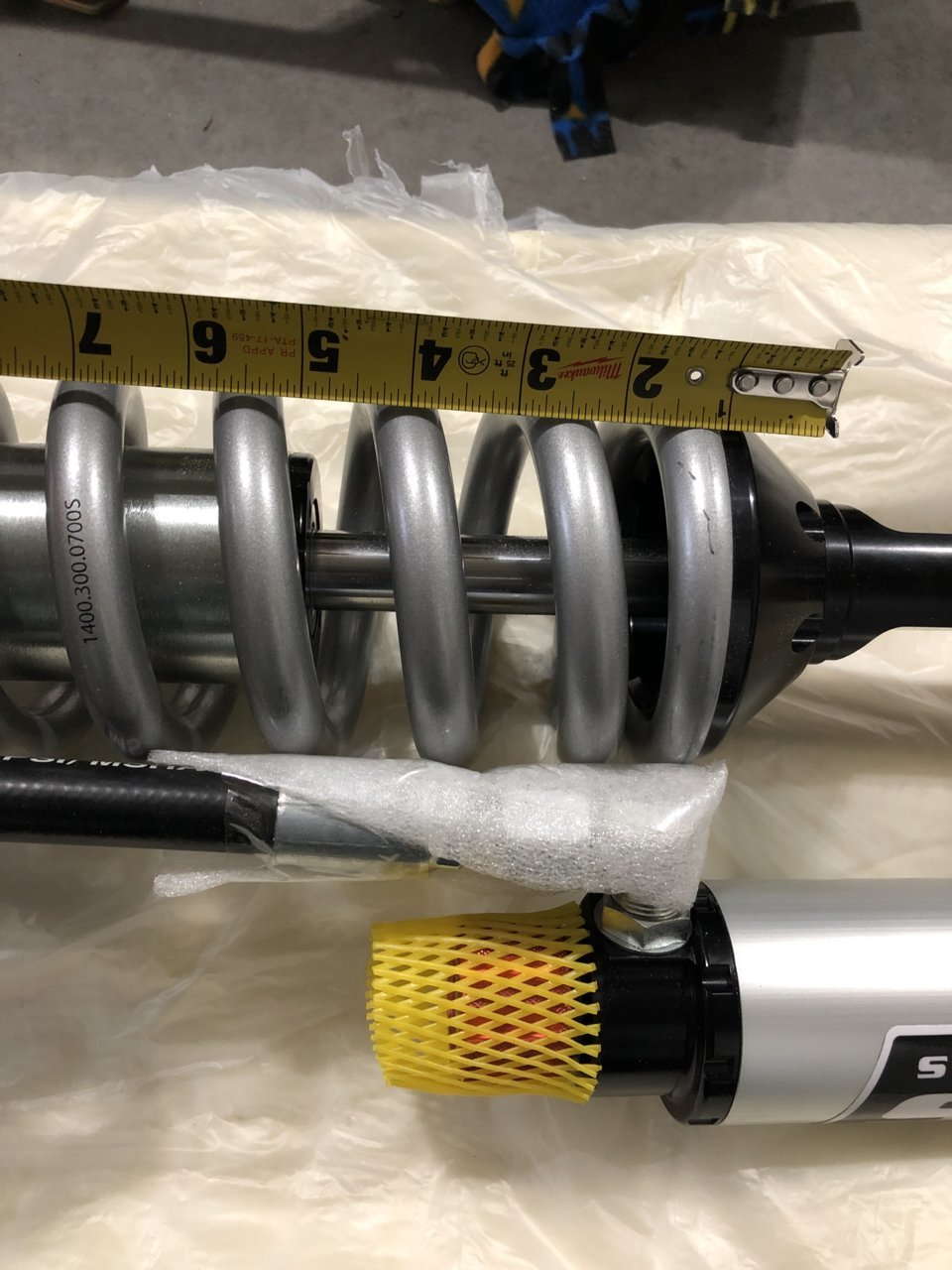

    Keep in mind it’s not that simple. The body of the shock can go into the bottom perch spring mount. Mine measure 5”. Maybe 4 7/8”

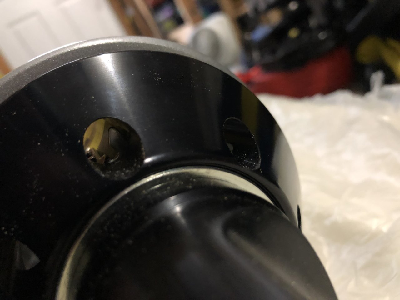

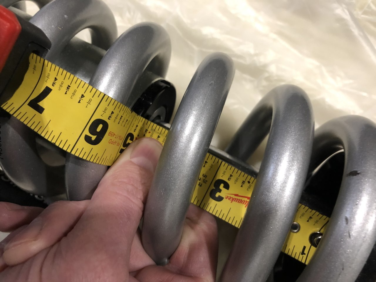

    Alright. Measured some stuff. Hopefully did it how you asked. Shoved the tape measure into the spring perch and then measured and took some pics for ya. The last pic is to just show you where I rest the tape measure. On the flat spot in the spring perch where the holes are.

    Our measurements are the same. 4" to the top edge of the spring perch on the outside and 4 5/8" measuring internally.
    EDIT:
    Per ADS Tyler:
    The coilovers are setup to have metal to metal contact between the threaded bottom cap of the coilover and the bottom spring perch.
    Their extended travel travel coilover has 4.625" of travel. 1/8" more than their standard travel coilover. .265" less than a Fox extended travel, and .445" less than a stock Bilstein/Toyota strut.
    That's .935" less wheel travel than stock.

    Tyler told me that their extended travel is their standard part number. I haven't seen the part number you have at all. Those should net you about 1.2" less overall wheel travel than a stock suspension.
