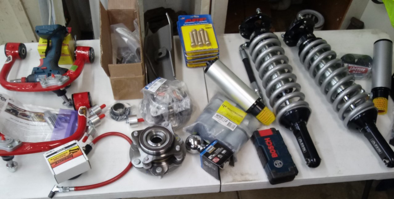

    I know I can be a stubborn contrary ass, sorry if anyone has taken it personally, but I'm me, I want the facts and for them to be here for others to find.
    So that I'm not all doom and gloom, here's a pretty picture of front end stuff that I put on hold and didn't install this weekend. Till I figure this out.
