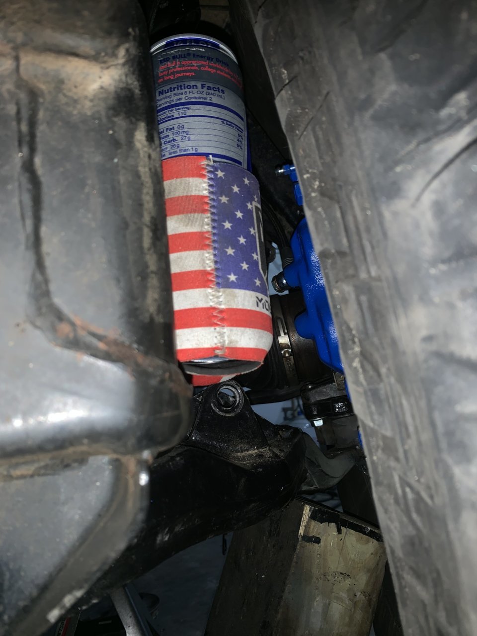

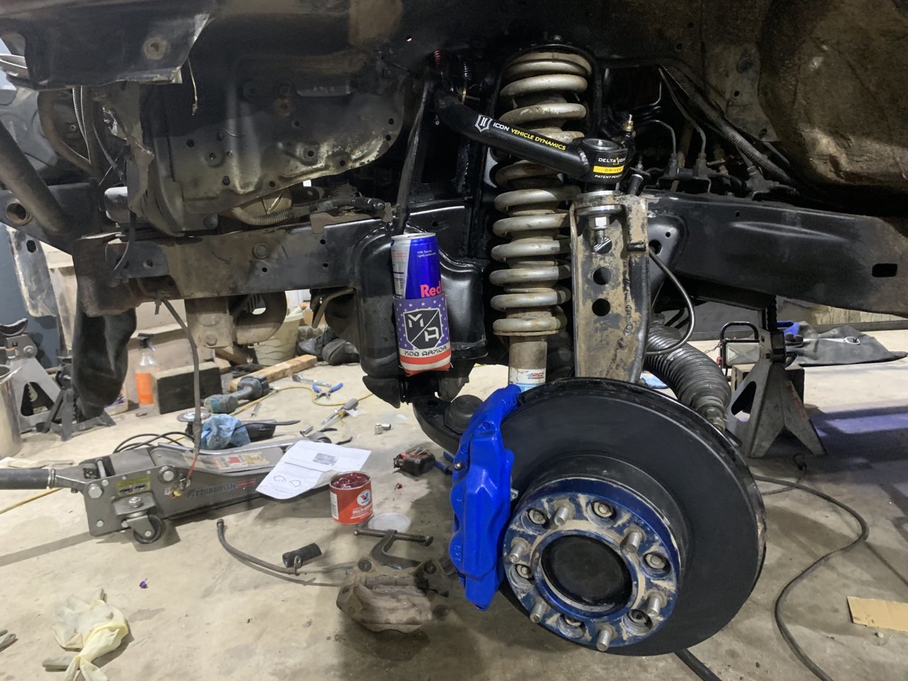

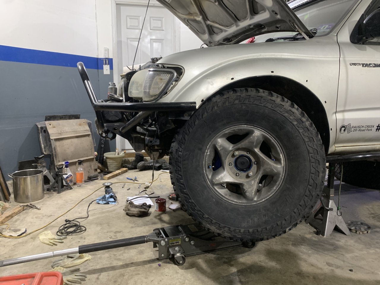

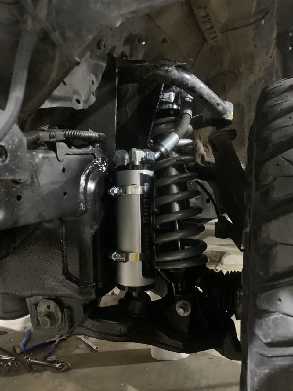

    Drivers side is in, crazy comparing our preloads @Silver02Taco
  16. Feb 28, 2020 at 1:13 PM
    #3896
    cynicalrider
    cynicalrider #NFG
    Jul 25, 2012
    #83399
    17,160
    Jersey
    01 SR5 TRD 4x4, '23 Bronco Wildtrak, 2017 HSQV FE350
    Drop bracket lift and booger welds
    I asked for both of those things to be setup that way. I did it based on a dude on here who I saw is running 37’s on his 3rd gen 4Runner and I figured this would help future proof me when I decide to take that leap. Though I don’t think I’d go to 37’s without long travel for the stronger cv’s and so I wouldn’t need to retub the fire wall. But I didn’t just assume it would work for me this way either, I did testing with the coilover out before I ordered the shocks just in case.
    I did get them directly from ADS. It took much longer than I expected and I am concerned that since I didn’t go with a shock builder that knows first gens super well that I might not be happy with the spring setup they provided but they did that based on how I say I use it and my actual weight.
    So in the end the custom work done is:
    Aggressively valved (we’ll see)
    Different hose/resi configuration based on measurements/fitment I did to clear 35’s
    Top out protection
    ChadsPride, not_nick and Silver02Taco like this.
