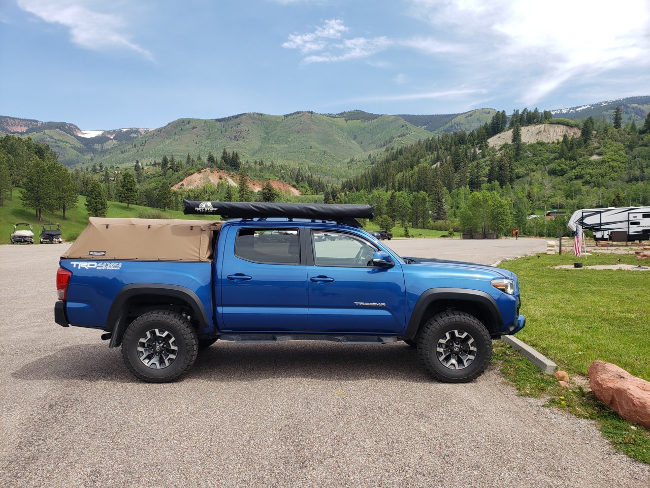

    **Sorry do not have much to add to the current train of thought... but!!
    Just wanted to post on this thread and thank you for the help picking out ADS shocks for my truck. Went with the non-resi fronts at 650 springs, from @Headstrong off road.
    Installed in June 2018 so they have survived 2 Colorado winters with no issues. ADS did recommend rear shock boots due to me being in a heavy salt area, I left the bottoms open and cut a drain hole, I rinse them out frequently and check for deposits.
    Ride height in front is 22" both sides hub to fender. I gained 1.5 inches over where I was and did not change the settings on the coilovers. Ride is impressive for me! Smoother off-road than on sometimes. This is a great place for advice if you know where to look!! Thanks again!!
    Here is a pic for reference, rear is high for my taste, wheelers add a leaf is brutally unforgiving, going to change out for Archive add a leaf soon.

    Clean setup. Sharp and solid
