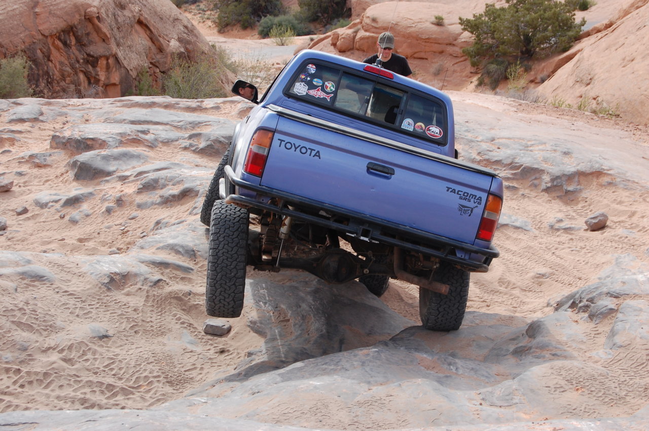

    A local to me shop named Slee Offroad in Golden, Colorado ordered and installed the ADS shocks in October 2017. Slee installed the rear shocks in the stock location. I have not noticed any topping out "thunk" noise as discussed on page 200 of this thread when I have extended the shocks to their limits, for example on Poison Spyder Mesa in Moab last April:

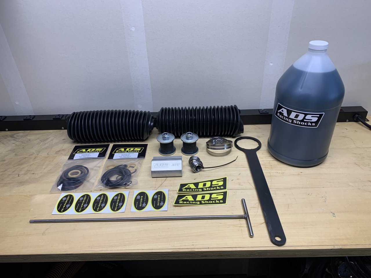

    Im getting parts and tools together to rebuild my rear bypasses. Just waiting for the nitrogen regulator to get here and I will be ready to go. Tyler at ADS was awesome and got me setup with everything I needed.
