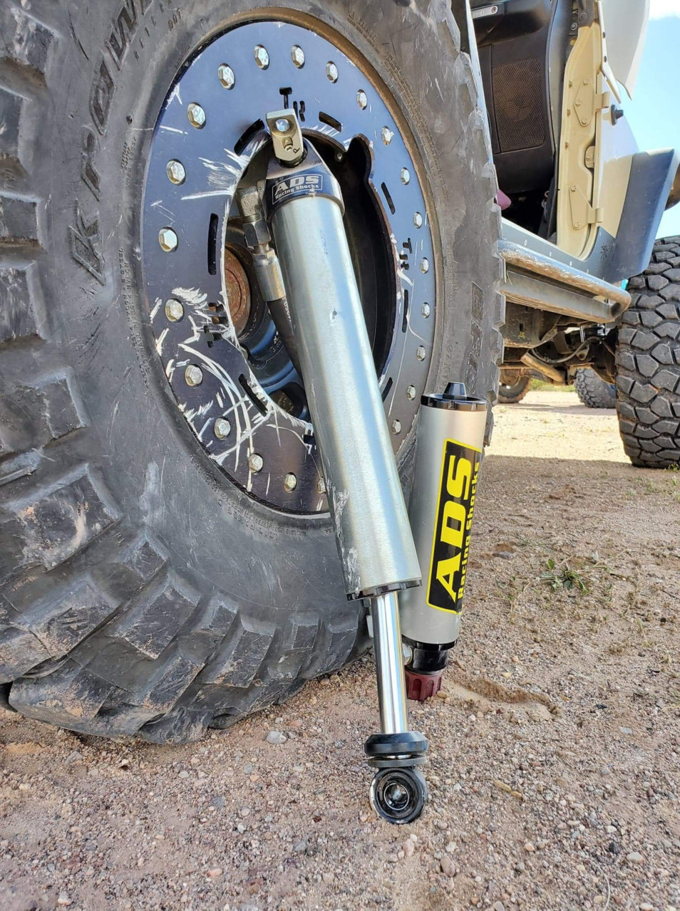

    They're a pretty small operation, from what I've seen. We buy through a friend's shop here in Houston, who knows them personally. Doesn't necessarily excuse issues like leaking fittings and what not, but I think it's a little more understandable when it's literally one or two guys building the shocks. We severely damaged a 2.5" rear
    shock on the rear of our Jeep, and sent it back to them to rebuild. It took about six weeks to get back, for the reasons mentioned above.

    It was no easy feat, believe me. Effectively, the entire weight of the Jeep was on that shock, on a big rock. The shocks are completely custom built, so they had to have a new body turned, in order to rebuild it.

    That is the gnarliest bend I have seen on a shaft that thick except the one time a guy fell down the stairs with a boner while drunk at a party :rofl:

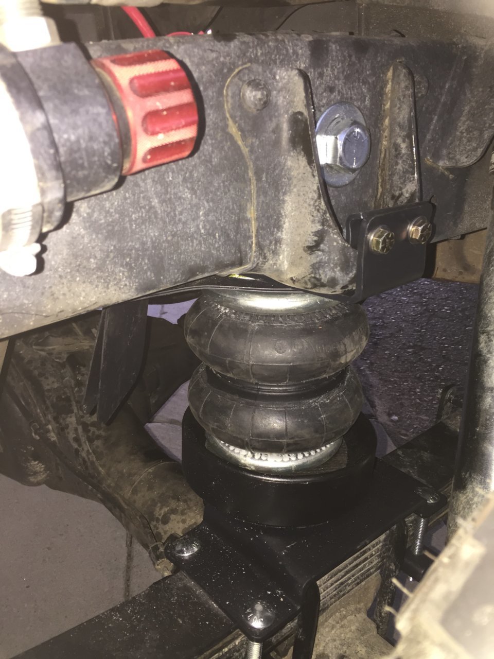

    I thought about bypasses, but honestly I think they are overkill for my needs. Plus, I have airbags so I am not sure bypasses would help. I can keep the airbags as low as 5psi (to the point you can squish them with your index finger)

    I didn't know you ran bags in the rear. Do you carry a lot of weight on the reg?
