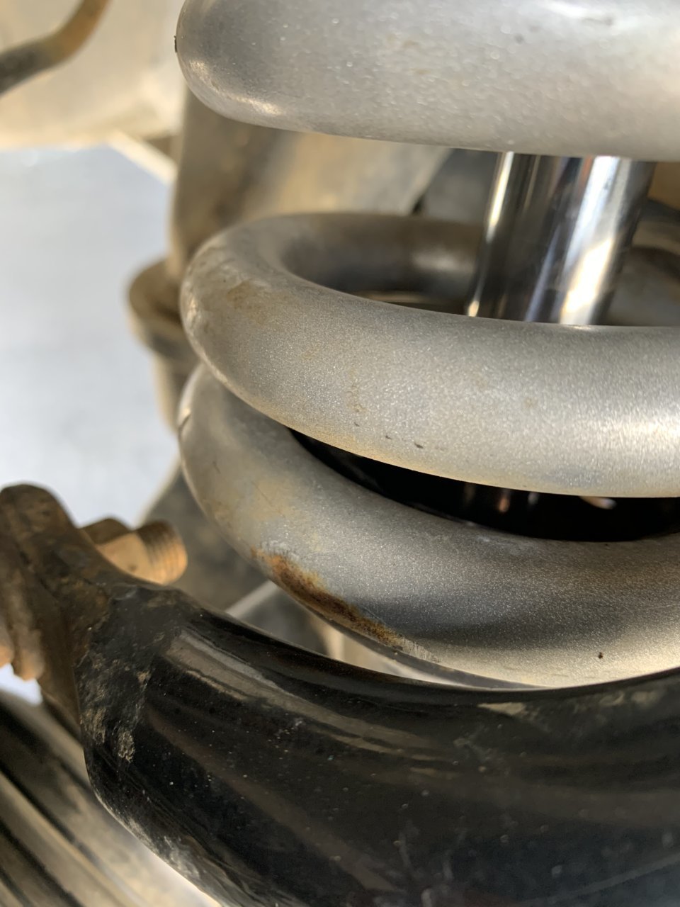

    Anyone else rubbing? Thinking I should ditch the sway bar....

    No sway bar = no rubbing...
    Did you install the sway bar relocation brackets that came with the kit?

    Yup. Only rubbing on the passenger side too.

    My bolt rubbed from the joint, not the bar. I chopped the bolt but that looks like a sway bar relocate needed

    Not much else I can do on that front. It’s already installed. I’m gonna see if I can pry the swaybar over slightly to get enough clearance.

    I was able to pry the swaybar over a little bit and appear to have clearance on both sides. I’ll keep an eye on it and see if it still rubs. If it does I’ll yank it off or clearance the sway bar a little.

    Hmm, I'm having the same issue but only on the driver side. It looks like I have the same setup as you do. I guess I'll have to try prying mine over too.

    Remember the sway bars have those locating rings on them on the inside of the bushings. Might have to adjust those too to get it to sit where you need it too.
    As a side note. I installed my sway relocate as I put the sway bar back on for a long cross country trip. Just want to be safe.
    My sway bar is rubbing against the reinforcement ribs on the Mobtown skids. So, fastest fix is to washer/space the front of the skid to clear. Or pull it completely and notch the rib. Which pulling that skid can be a real PITA sometimes.
