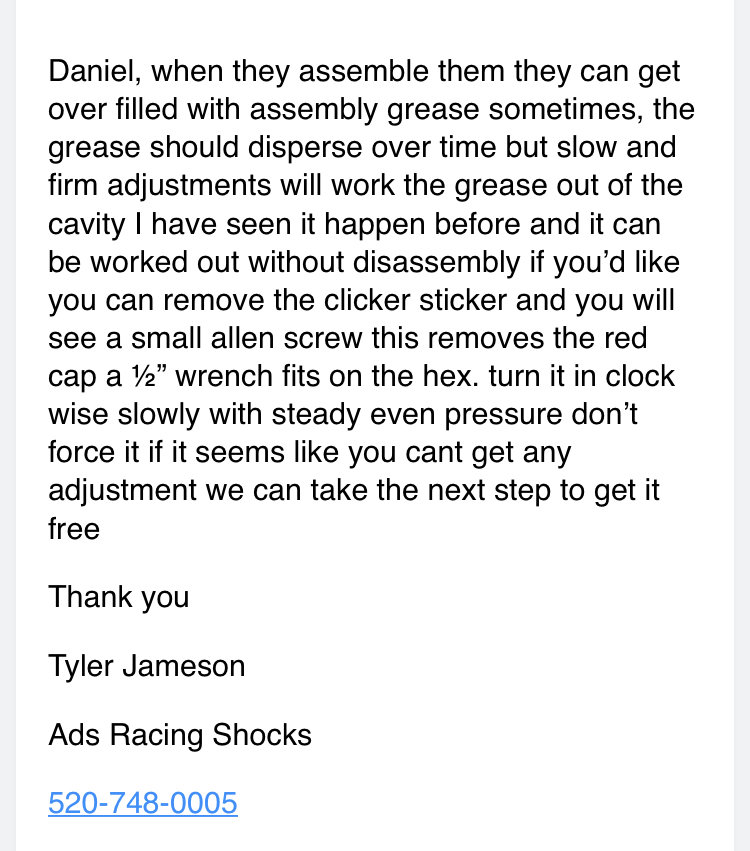

    One side on mine is a little stiffer, but nothing I can’t turn with one hand

    Spoke with ADS and they walked me through a quick fix!

    Mind sharing it in case others need to do it?

    Yeah definitely, I’ll post the email that was sent to me

    Super happy with ADS customer service. Spoke with tyler via email about a leak I found on a loose fitting. Sent in my driver side and he bled the system/put new oil in it for free. Didn’t want to do anymore damage as I’ve never rebuilt/tore down these shocks. Pretty awesome
