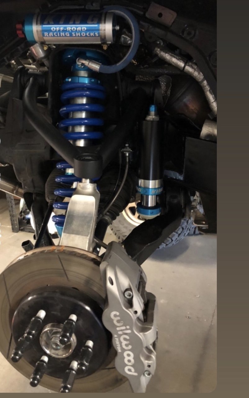

    So King is it for the fronts, and they did a bottom basement job and i believe they just released the version they had been contracted to possibly make an oem set up (like the fox for Toyota and Ford), but their contract was cancelled.
    I have a set of the oem extended travel king 2.5 with comp adjusters and a pair of 2.5 bumps that are spacered to 2 inches I think. With a set of uniball uca’s.
    I wanted to run the ads coilover in front but they do not make an oem upper mount. (I have considered selling then king coilover minus the top mounts and ordering an ads 8 inch 3.0 when I relocate the upper shock tower... that’s after next winter)

    Btf was supposed to do the work being done now, but when it got to d day they were really busy and said they were about a year and a half out. Which was weird. Seemed a “we don’t want to do it”
    here is a pic of the front suspension as it sits now. Awaiting rear shocks
