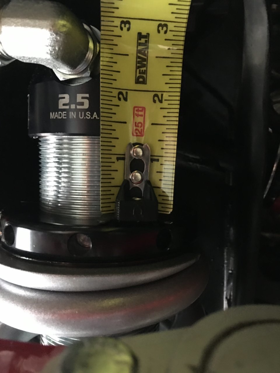

    I’ve got my driver side on and I ended up cranking the collar 8 rotations from where it was set off the shelf, but only at 2” of lift, trying to get to 2.5”...
    how much is too much when cranking down on the collar? I have 1-1/8” of threads exposed at this point, trying to decide if it’s worth going further. Each rotation is 1/16” it seems, by that math I need 4 more turns of the collar.
    I’m using this punch and it’s working great, but the collar is really tight, so it’s a bitch without having the springs compressed.
    https://www.amazon.com/dp/B000BHQ0DI?ref=ppx_pop_mob_ap_share
    Edit: I have an alignment scheduled later this week and planning on getting my 35’s mounted the same day, would like to get the height set prior to all this happening so I don’t have to redo the alignment later.

    The collar isn't tight. You're fighting the spring. You should really use spring compressors if you're going up that much. What spring rate do you have? I'm surprised you're not already at 2.5" of lift. Also bear in mind that your passenger side will be 3/8"-1/2" less pre-load than the driver side.
  20. Jun 22, 2020 at 3:40 PM
    #4140
    SearArtist
    SearArtist GX poor
    Jan 5, 2016
    #174151
    18,980
    NC
    GX470 & GX460
    Things
    700lb springs. I have a heavy front end. I ended up at 10 total rotations now on the driver side. I don’t have a spring compressor or access to one. And I’m not taking it back out to take it to a shop either.
