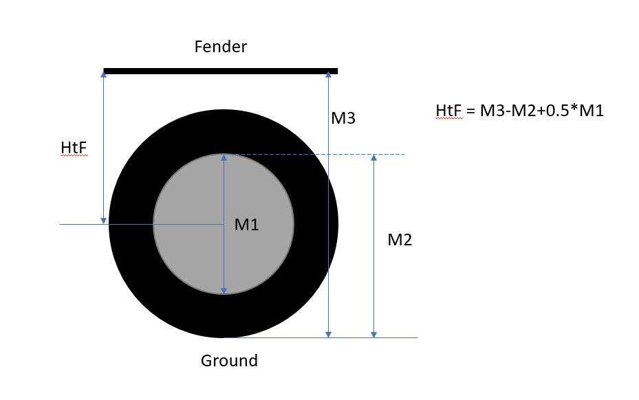

    You'll be topping out all the time and your CV boot fins will be rubbing. 23" is a 3" lift. It's based on 2nd gens which are 20" hub to fender. 3rd gens are an inch higher from factory which fucks up what everyone thinks the lift measurements should be.
    Here's the way I measure hub to fender with wheels that poke.

    curious as to why you add 0.5 in the equation? What variable does that account for? Is it for the lip on the wheel?

    It's half the overall rim diameter, or the rim radius. It's just using easy things to measure. Rim diameter, ground to top of the rim, and ground to the fender are all easy to do.
    The other way to think of the equation is M3 - (M2 - 0.5*M1).

    ok so my rim measures 17.25” across and ground to fender is 38”. Ground to top of rim is 23.75” = 22.875”
    I assume you are supposed to use the actual rim diameter measurement and not 16” ? If you use 16” then that puts me at 22.25” HtF
    what’s the correct rim measurement? Actual or the “standard” size?

    Yeah for this method you use the actual lip diameter. 17.25" sounds right for a 16" rim.
