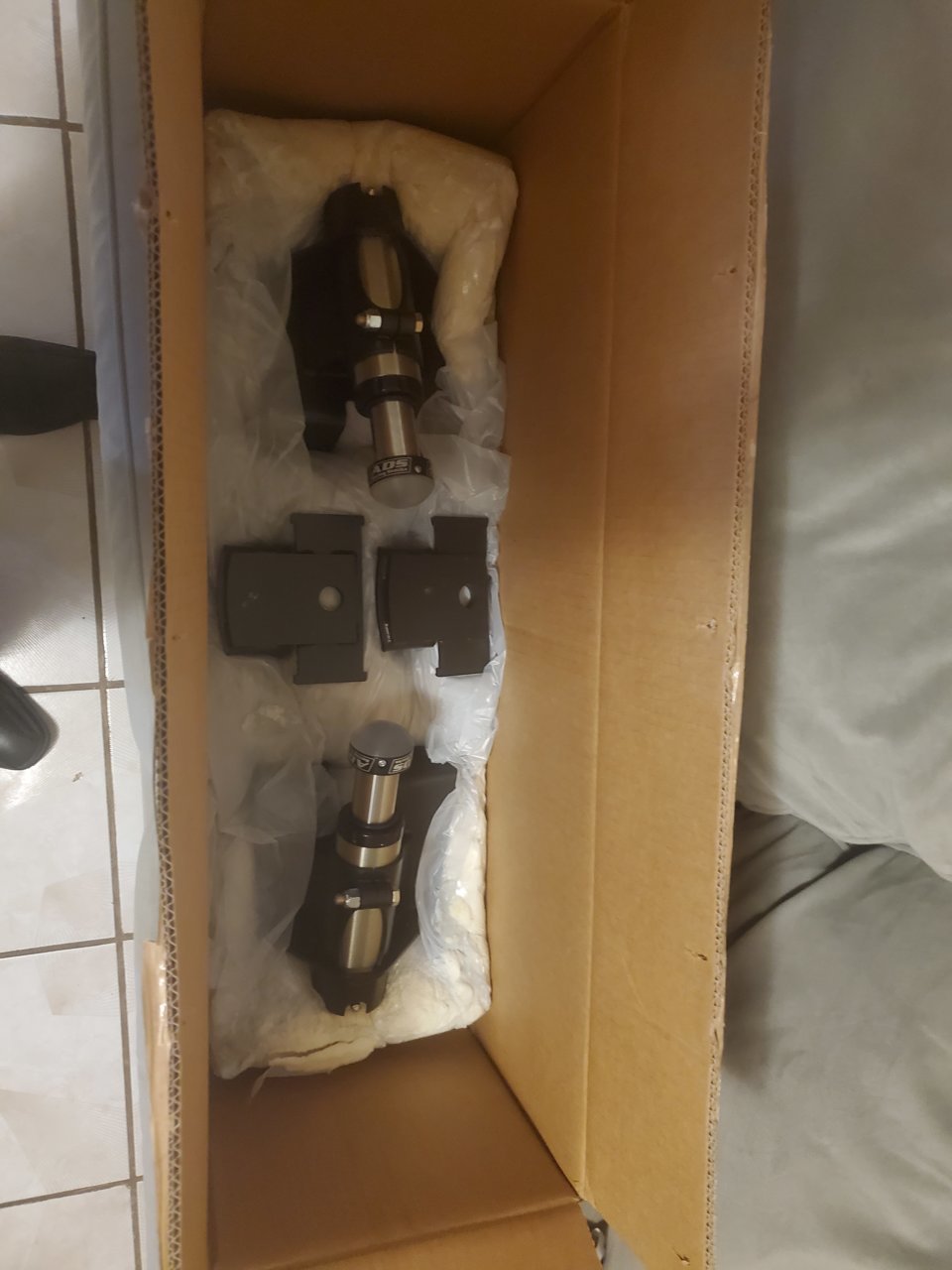

    that last pic....an ADS Sex machine?

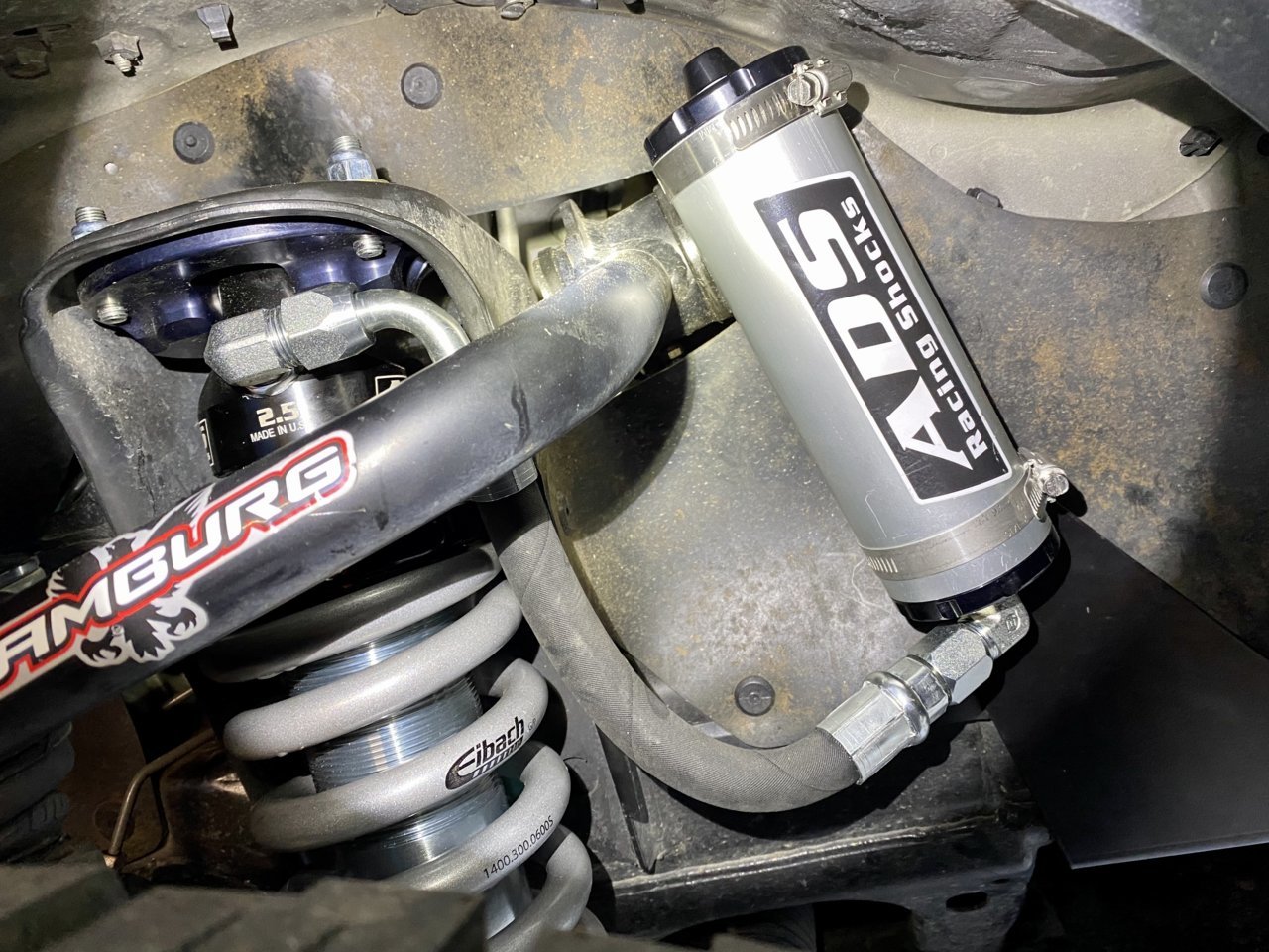

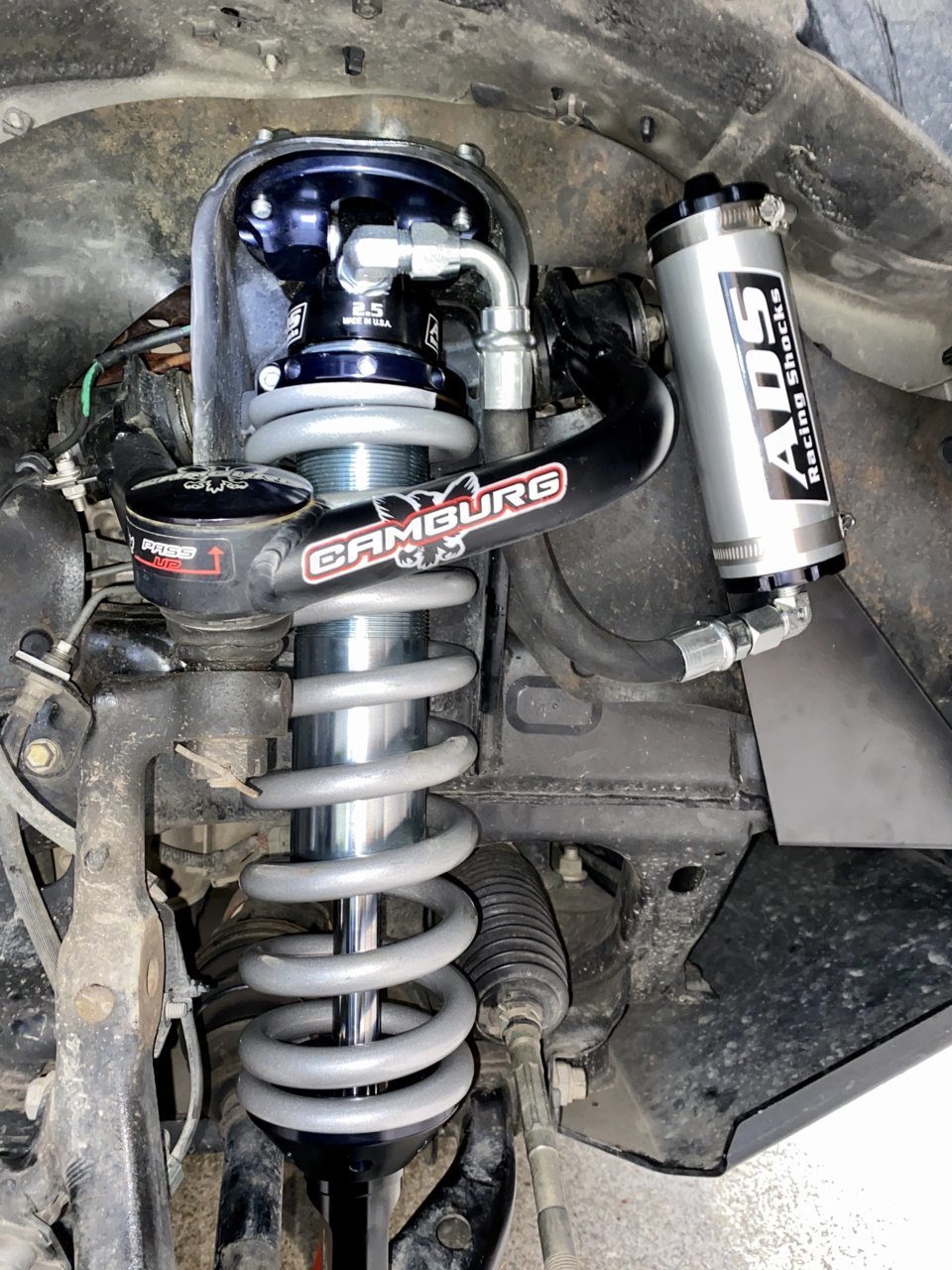

    Installed my new set up today. Coming from a fox 2.5 non Resi. First impressions are very nice build quality and definitely improved ride control vs. the FOX. Two things that seem a little off with the ADS though . First thing is the length of the Resi hose; It is very tight when clamped to the bracket. I had to really apply a lot of force even after adjusting the hose orientation to get it closer to the bracket. I feel with that much tension on the hose it would leak prematurely. I noticed that the resis that have the click adjusters the hose seems a little closer up on the Resi with a 45° fitting vs. the non adjuster Resi (like mine) that are a 90° Fitting. I would think that another 1/4 - 1/2 “ hose length on the plain Resi models would be beneficial.

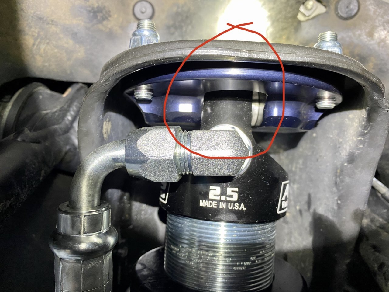

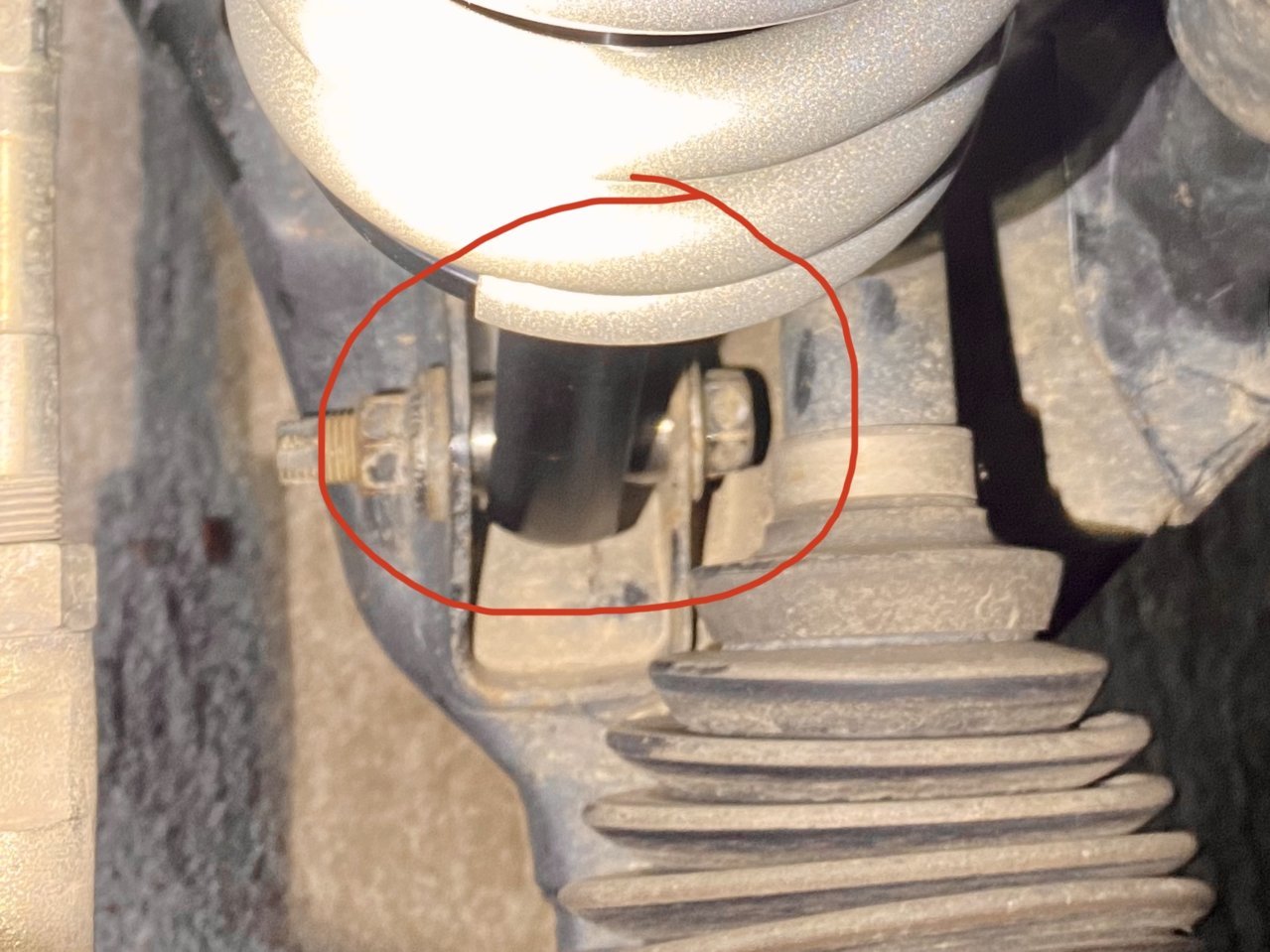

    Secondly, After I installed them I added some preload (about 7-8 turns each side) I went for a quick drive and when I looked everything over when I got back, I noticed that the top and bottom are not sitting centered in the mounts. The uppers have some rubbing in the top hat mount. I can rotate the shock by hand back to centered but then it just goes back crooked.
    Any pointers are greatly appreciated.

    ADS still having hose issues. Looks like they switched vendors as well. Might want to call ADS up and send them some pics.
