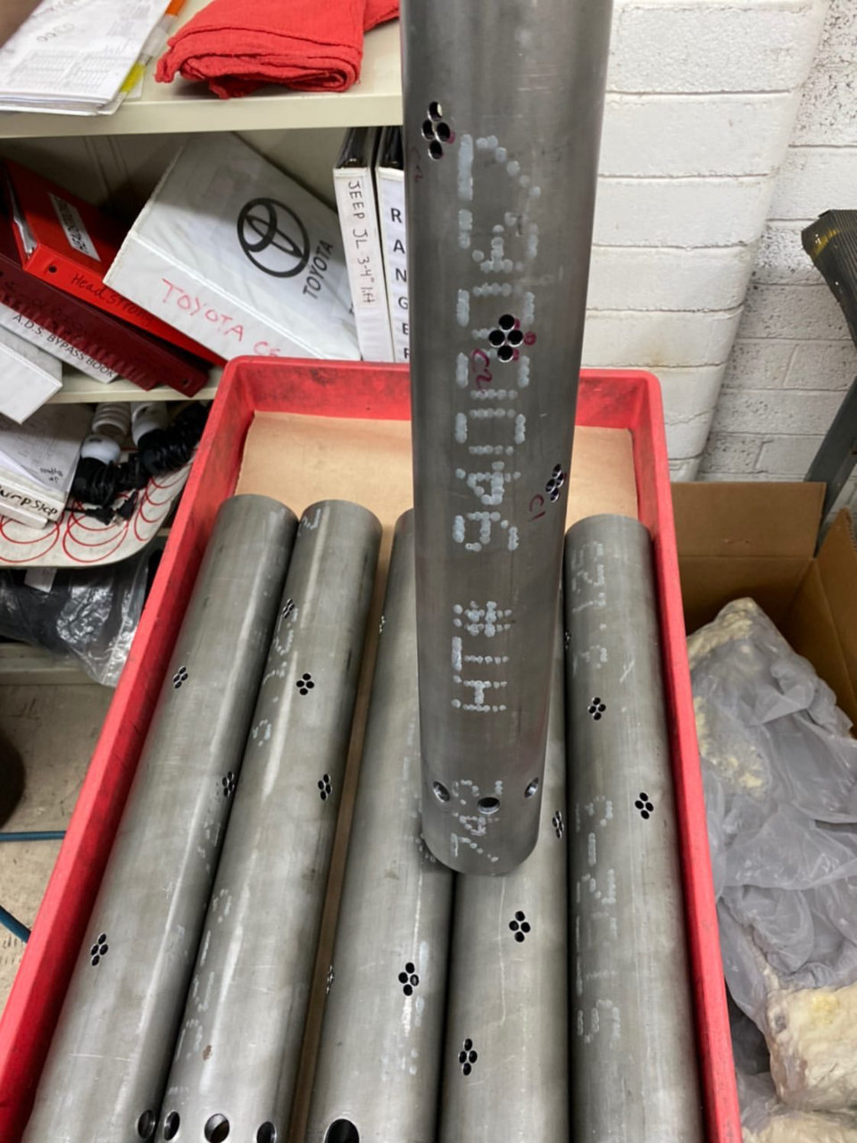

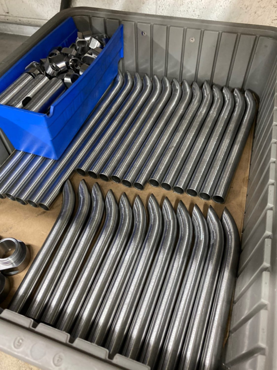

    So very soon my rears will be done... then maybe this fall I can add some bypasses and revalve my fronts... went with the baja kits prerunner. Going to see if I can cut my stock upper shock mount and weld a spacer into it to raise it (think of a reverse roof chop on a hotrod) Below are 3x16 5 tube designed for leaf springs (spring under deavers on the truck)3558E780-C553-4A36-9A0C-E18156414C26.jpg

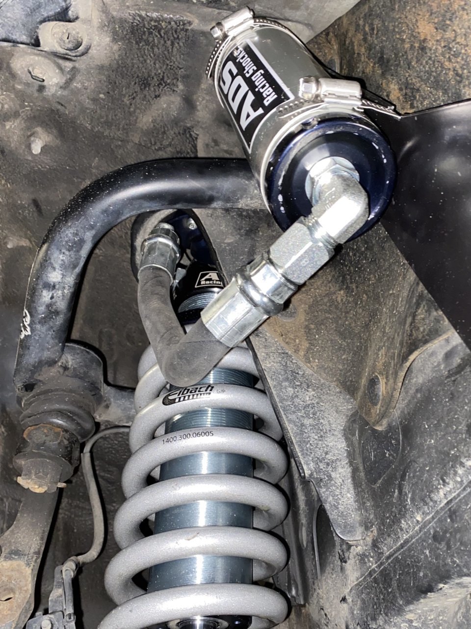

    Don't worry about the shock being rotated. There are swivel joints on both ends and that's what they do.

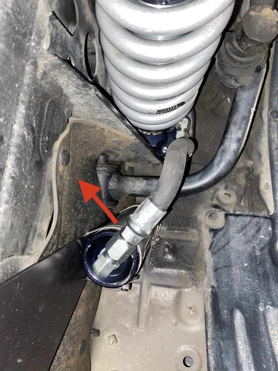

    Any info on getting the remote resi hose rotated ? Need to rotate the 90° fitting located at the bottom of the reservoir to get the hose bend smoothed out. Need to get it rotated towards the frame.

    This article should help you out:
    https://accutuneoffroad.com/which-fitting-can-i-adjust/

    Can’t you rotate the whole reservoir?
