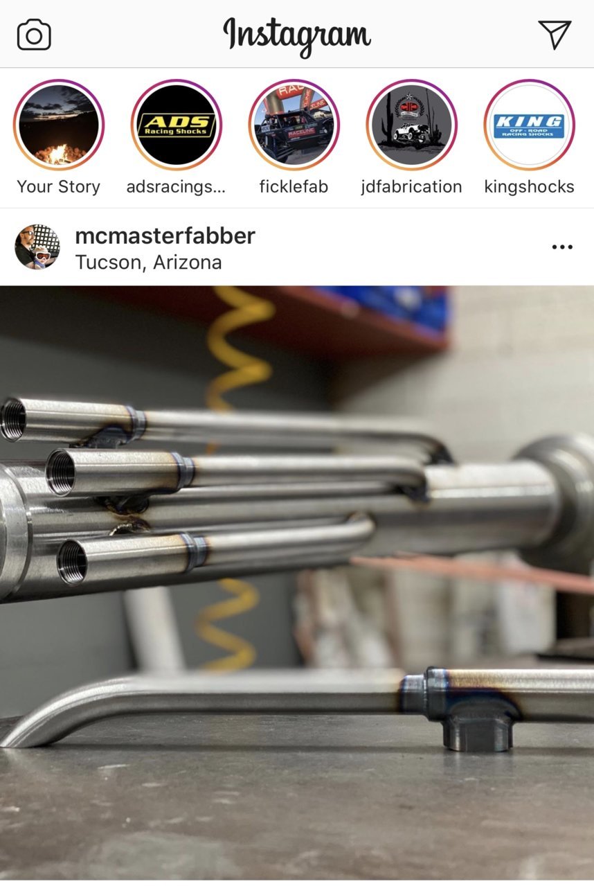

    Soon... rears getting welded up right now... what’s next? Honing, Plating then assembly? 2 more weeks?D78EBD57-B0FD-4F24-A986-EA04B142E7D0.jpg

    Sweet pic​

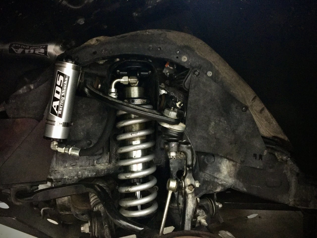

    I just finished the install of mine, it looks like you could ease some tension up on the lower resi clamp by using the hole cut out in the bracket instead of wrapping it around the entire bracket. It will sit at less of an angle. To do this you’ll have to separate the clap by unscrewing it al the way.
    if you zoom in you can see how clamp is not around that notch on the bracket towards the front of the truck. Hope this helps
    :cheers:

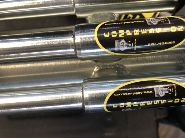

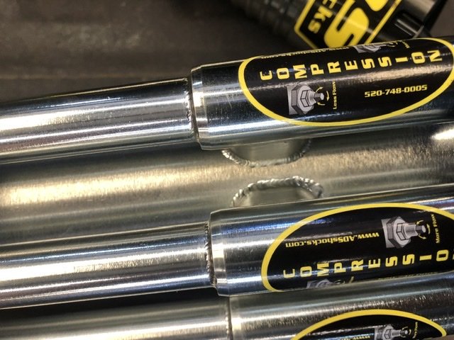

    I hope all the ports are clear of the bypass tube riser.
    And as long as the reservoir exit allows the hose to stay away from the tires.... it will do its job.

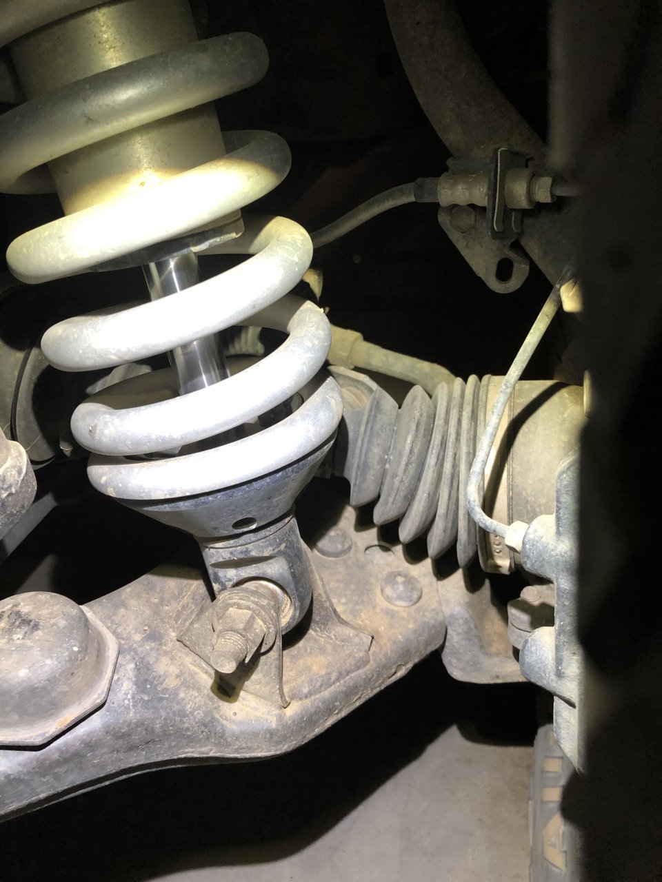

    I am at 16K miles. My truck is mainly used for off road excursions. But there are a lot of highway miles to get to the trails so maybe 20% off road and 80% highway. :notsure:
    Then the truck pretty much sits in the garage with a few trips to the hardware store until the next excursion. After an excursion, I clean the truck, but the mechanical engineer in me notices those bearings are exposed to the elements so I use the standard garden nozzle to spray out the debris around the spherical bearings. In the past I lubed the spherical bearings with Blaster Silicone Lubricant to hopefully get the moisture out and minimize the potential for rust until I read @turbodb's post followed by @Squeaky Penguin's comment and @Blackdawg's comment. I agree I probably degraded the spherical bearing's teflon liner with the silicone lubricant. I cannot change the past, so now I am just going to experiment with my spherical bearings to see how long they last with my current maintenance guess. For the past ~2000 miles after cleaning I lubricate with Blaster Dry Lube with teflon. Now I have a dry teflon lubricant on the teflon liner, which should attract less dust and dirt compared to silicone and hopefully reduce the moisture from cleaning. Time will tell how long they last. So far my ADS spherical bearings are still silent. Here is how they look after this weekend's excursion. I haven't cleaned the truck yet.
