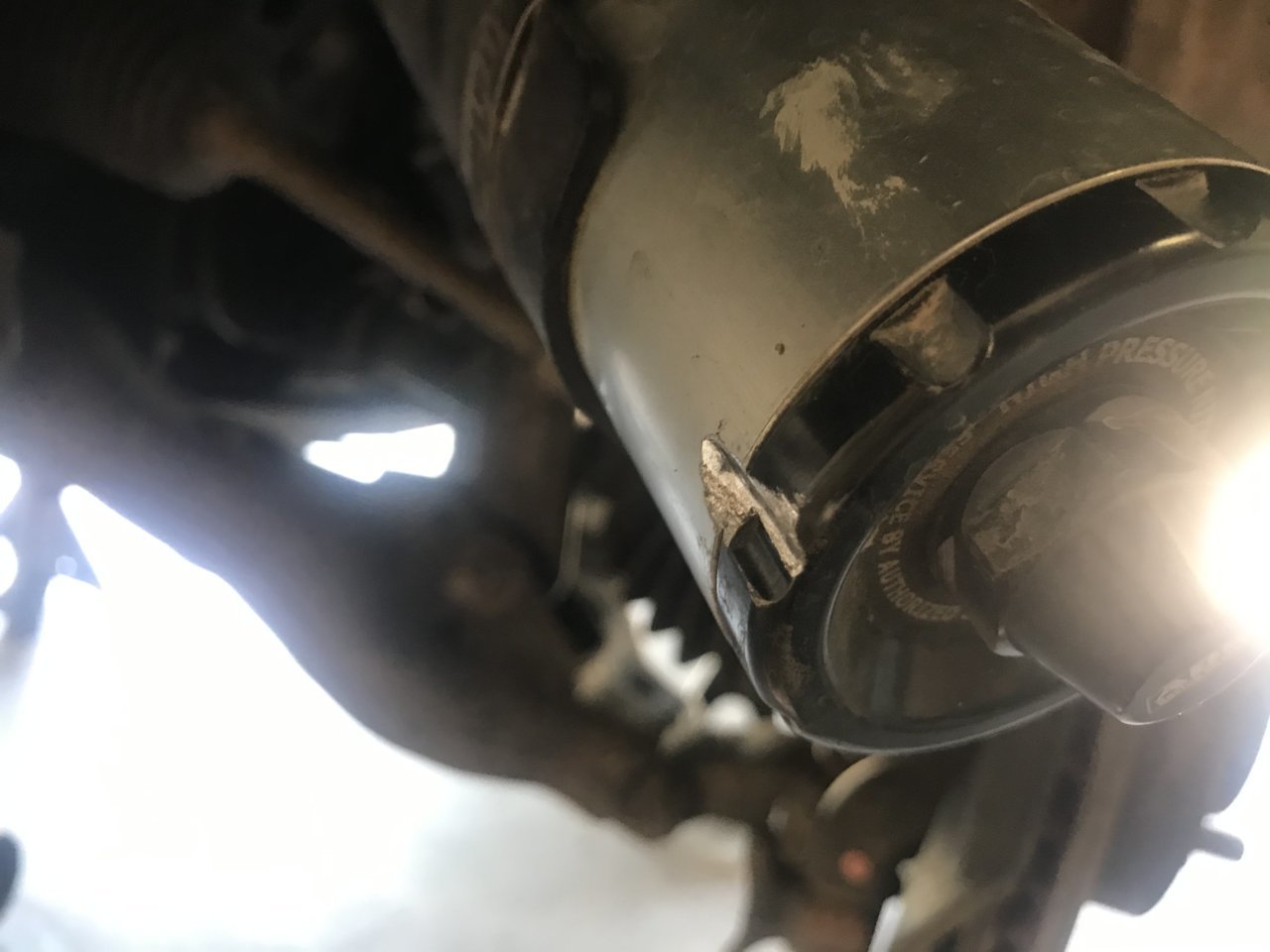

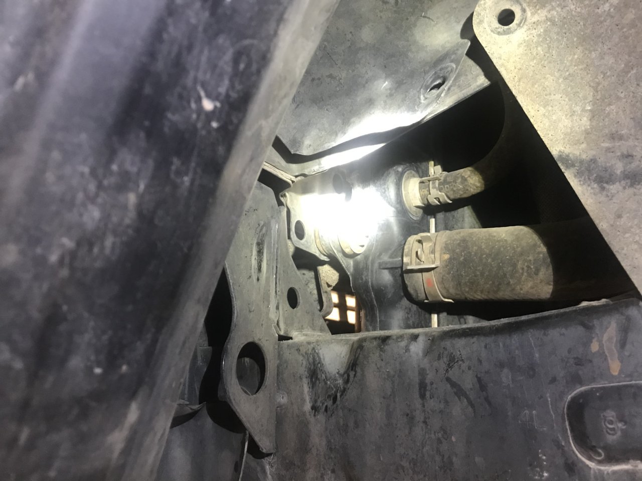

    For those of you with the old version reservoir mounts, make sure the body of your truck isn’t hitting your reservoir like mine was. Started hearing a clunking sound and finally found what it was.
    Where the light is shining is where it was hitting on the inner fender.

    Yep. Both my res's look like that. I took a mini sledge hammer to the sheet metal to give them a bit more clearance. All is good now.
    In the beginning it took me awhile to figure out what that clanking was while going over bumps.

    Luckily I was able to adjust them back just enough for it to not hit. I’m sure they’ll eventually slide forward again and I’ll have to do what you did.

    My hose is already rubbing up against the coil a bit, so the more I can move the res forward the better.

    My driver side is better now that I adjusted both ends of the hose to push outside away from the frame a bit. My passenger side refuses to come loose, so I just had to push it back really hard while tightening down the hose clamps. My hose is rubbing the coil bucket now, but I guess I’d rather than than the body hitting the resie. :notsure:
    Ive had multiple issues with my coilovers to include the top hats being installed on the wrong sides and and adjuster screw on one of the resies being loose allowing fluid to leak out. Apparently I was in a batch of builds that were built by a guy that was quickly fired after. So I’m giving them the benefit of the doubt, but I feel like the hoses should be just about 1/2” shorter than they are to fit better.
