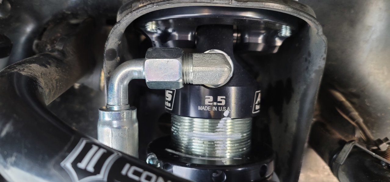

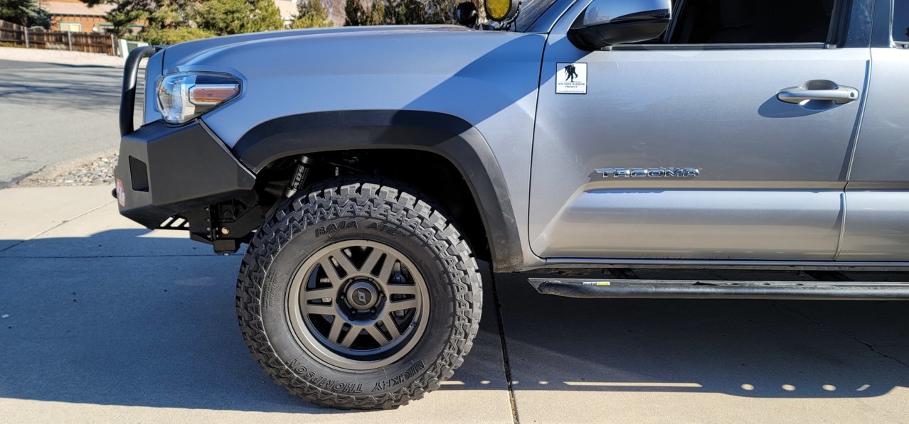

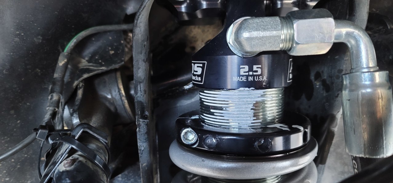

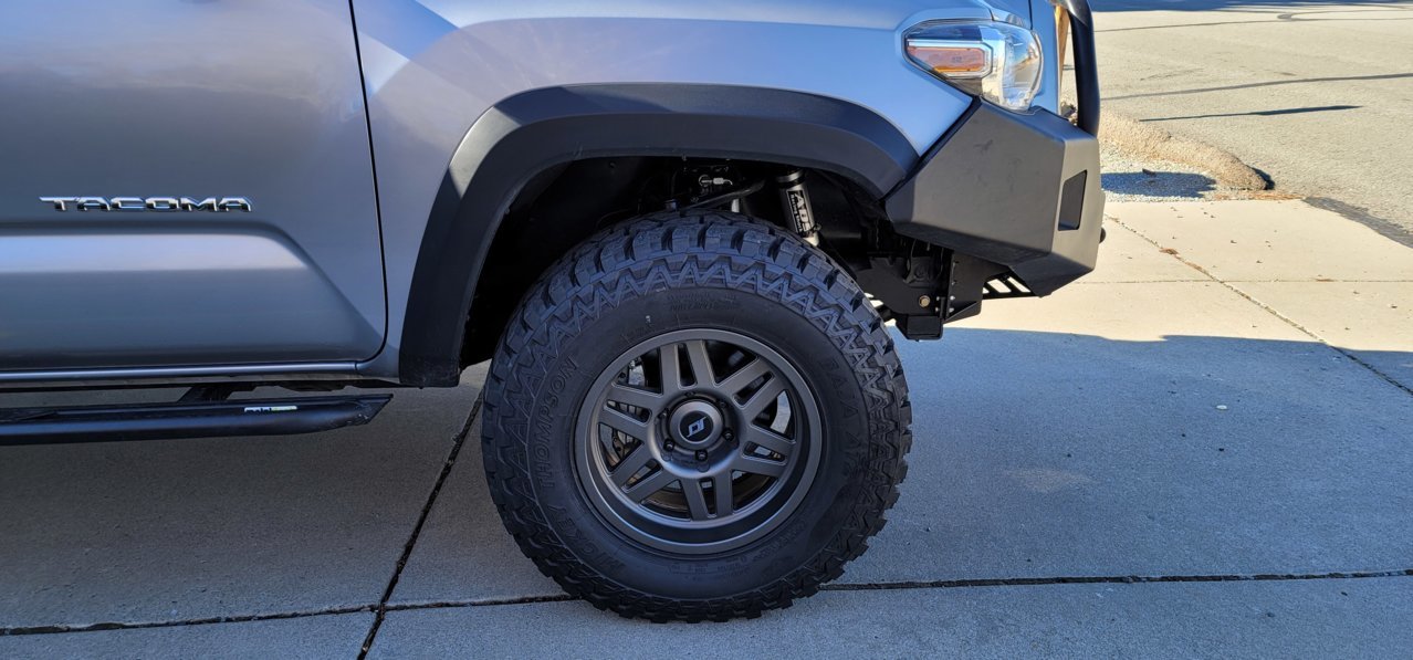

    So. Went up roughly 1/2 inch on the adjustment total of 12 threads showing now. Def use wd40. Lube it well, I used a allen key to loosen the retaining nut that locks them into place. Bought a 5/16 center punch and went to work. Wd40 sat for 2-5 mins before I starting cranking and had no issues at all. Each side is 36.5 inches from the ground tobthe fender flare. I have a 800 mike road trip ahead of me next weekend and I will see how much it changes . Might end up going to a 650 or 700 depending on what this new cbi bumper does to the front end.
