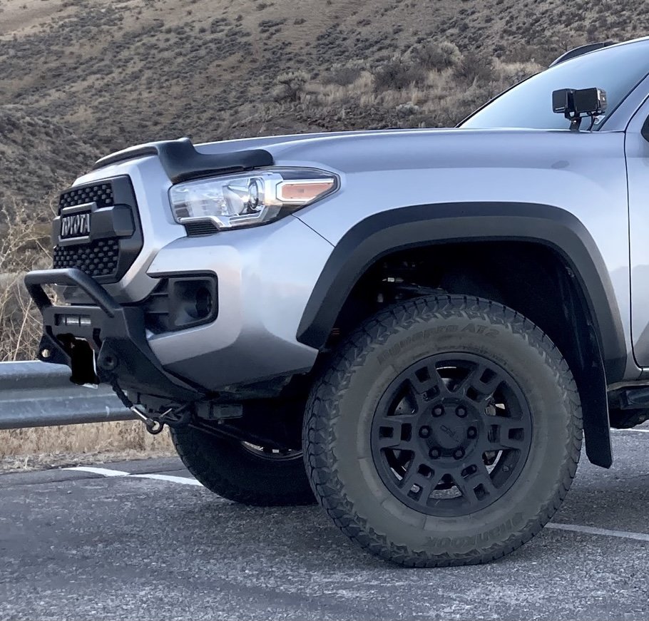

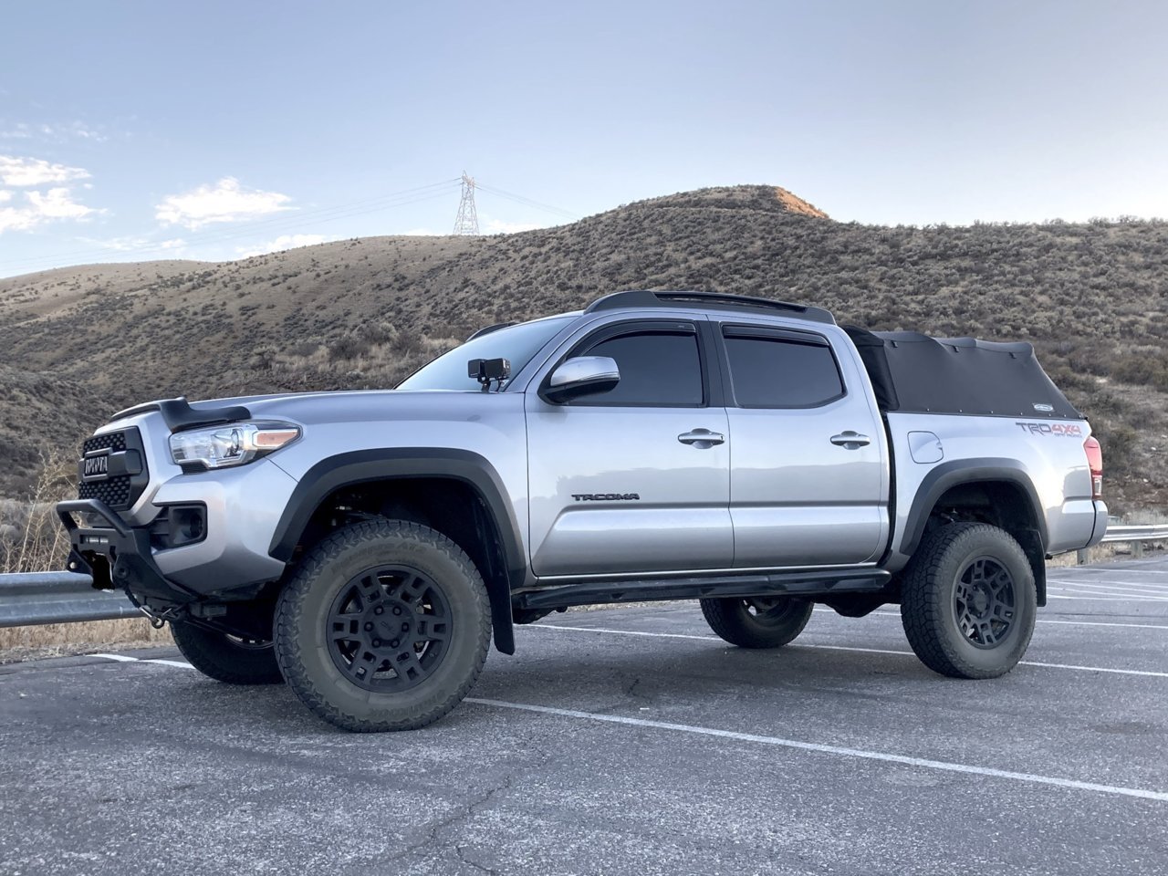

    Almost there!

    Dope as fuck bro! You won't regret it. I'm gonna get that ads dude peeing on fox,king and Billy sticker

    That big of a change definitely effected your alignment. Probably should get that rechecked.

    I will Monday. Seems bowed out. Hopefully it will not make any changes to the height. It might settle a bit more after my 800 mile trip to wa
