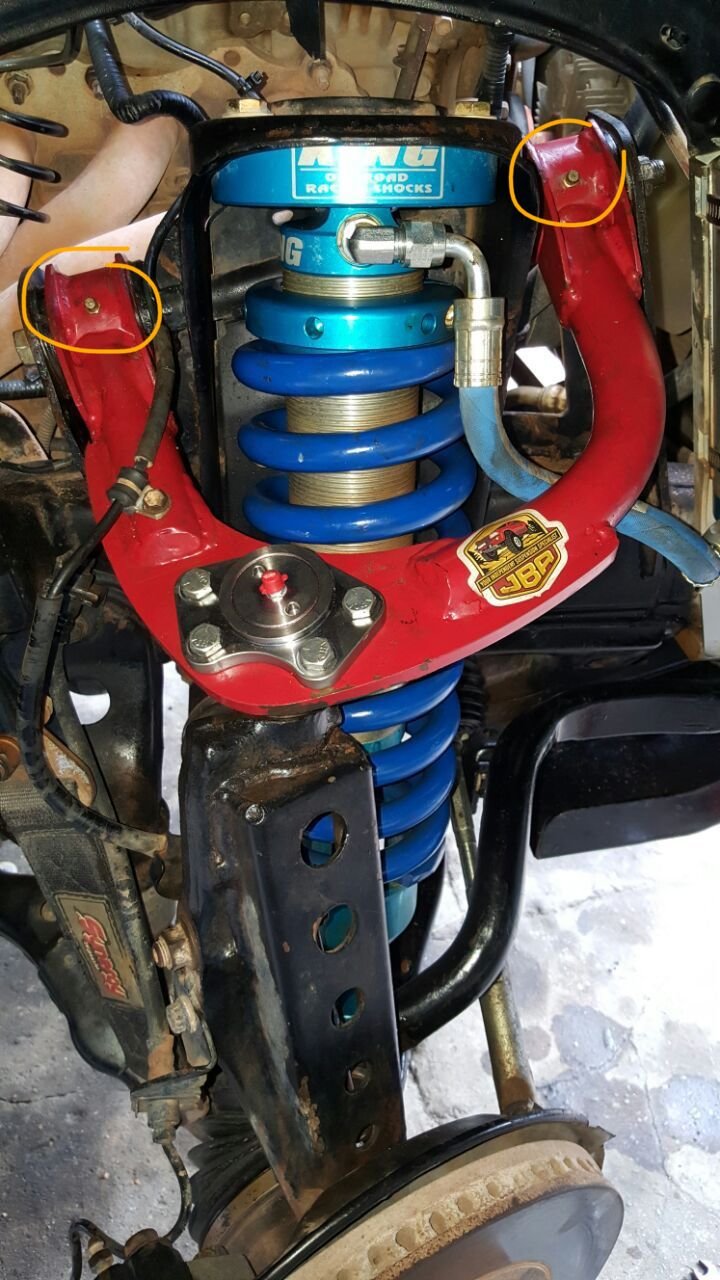

    Also, along with mentioned above, SPCs are very nice and can take a beating... if you are crafty you can drill a hole and add some self-tapping zercs to the arm parts where the mounting bolt passes through (do this before mounting of course). JBA UCAs do this (red UCAs below) and it’s the only thing I wish SPC did.

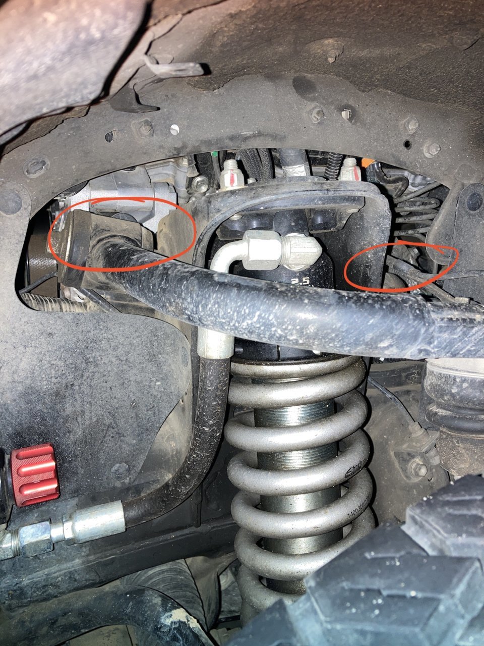

    Well 800 miles later. Getting some sag. And sway bar is running on the resivoir mount . Gonna have to say I wish headstrong had the 700lb coils in stock. Coukd have saved me some headaches . Now I will have to swap . 22.5 on the driver's side and 22 on passenger it seems the coil is just compressing the shock too much not allowing hardly any downtravel

    Is it rubbing on the passenger side mount too? Maybe the sway bar isn't centered in the brackets and it's closer on the driver side.

    That could be one issue. I'll double check. I have to remove the brackets anyways because I have to install my cbi t3 frame supports
