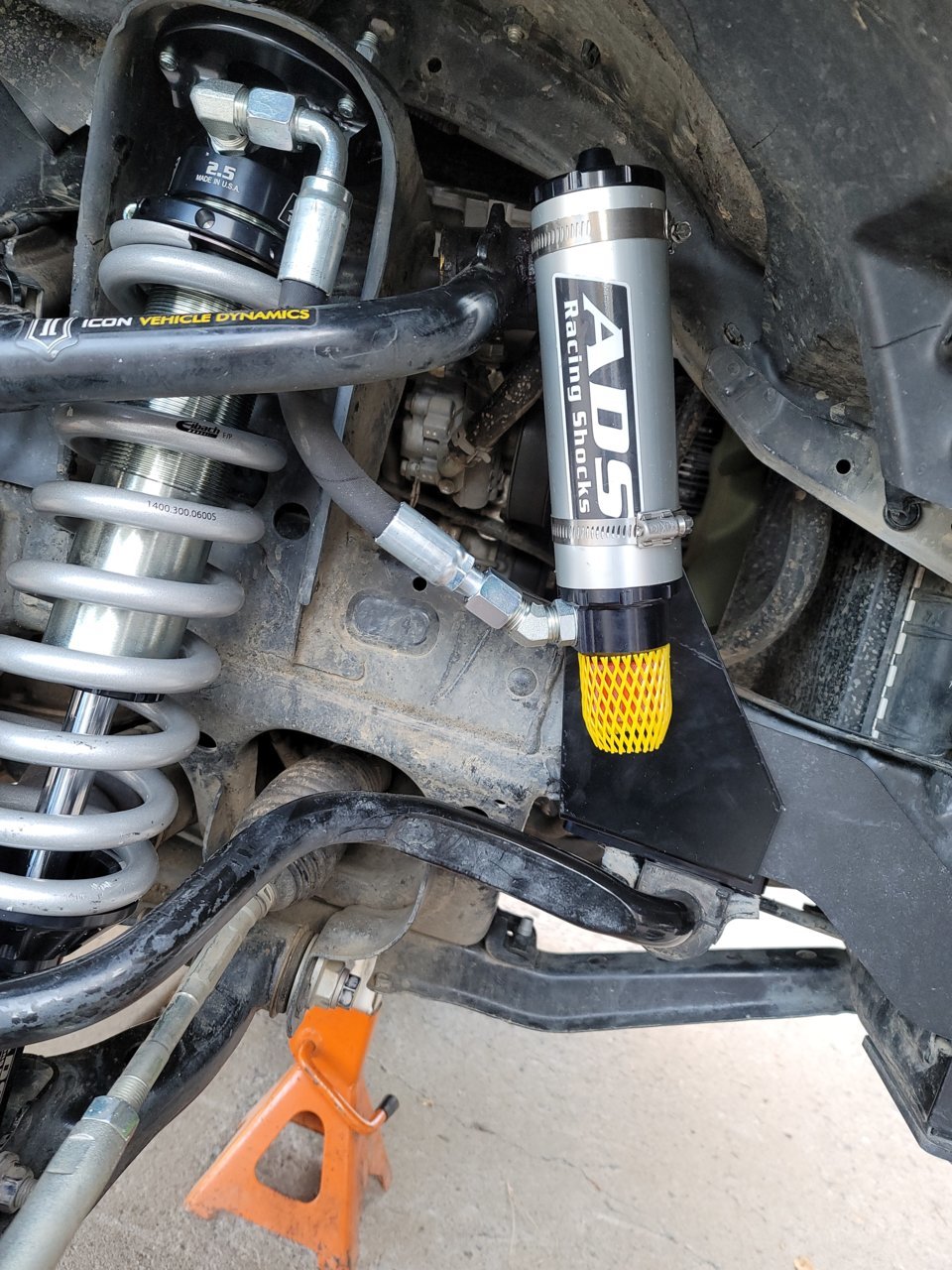

    Check the lower sway bar link bolts, too. Mine were gouging the springs. You should be able to feel the lower part of the coils in that area with your hands or crank your wheel to the right / left to get a visual. I yanked the sway bar out. Rides fine with 700#-ers

    yeah your up travel is not causing this, it just needs some adjusting of the bracket. You should have full range of travel without rubbing.
    also, with your front end weight, heavier coils are certainly indicated!

    The 1st photo of yours shows the spring model #. 14" long. The last number will be 0650S for 650# or 0700S for 700#. Should be easy to find somewhere on the internet.
