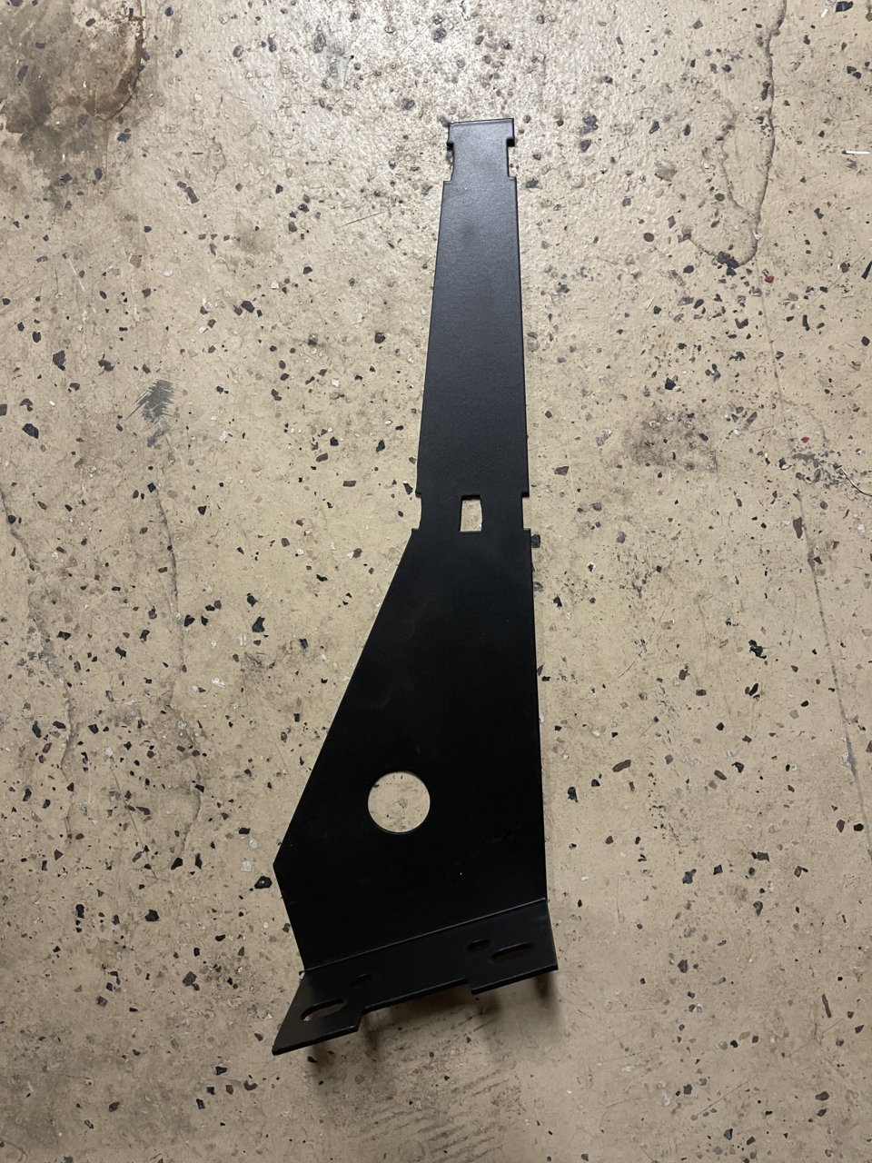

    Hey guys so after delays for a birthday party we’re almost done with the passenger side. Quick question. How do I mount the reservoir bracket or maybe a better question how did you all mount the Resi’s?A5D92907-DC25-46CC-AD25-2DF4E1781CF1.jpg

    Mounts against the frame between it and the sway bar relocate. The angle is pointed back toward the control arm. Resi mounts to bracket using worm clamps in the recesses on the bracket arm.

    Im removing the sway bar for now as I didn’t account for the relocate. Does it lay flush to the Frame with self tapping screws? Ugh. I’m almost done and this has me stumped af. Pics?

    uses the bolts that held the sway bar on!
