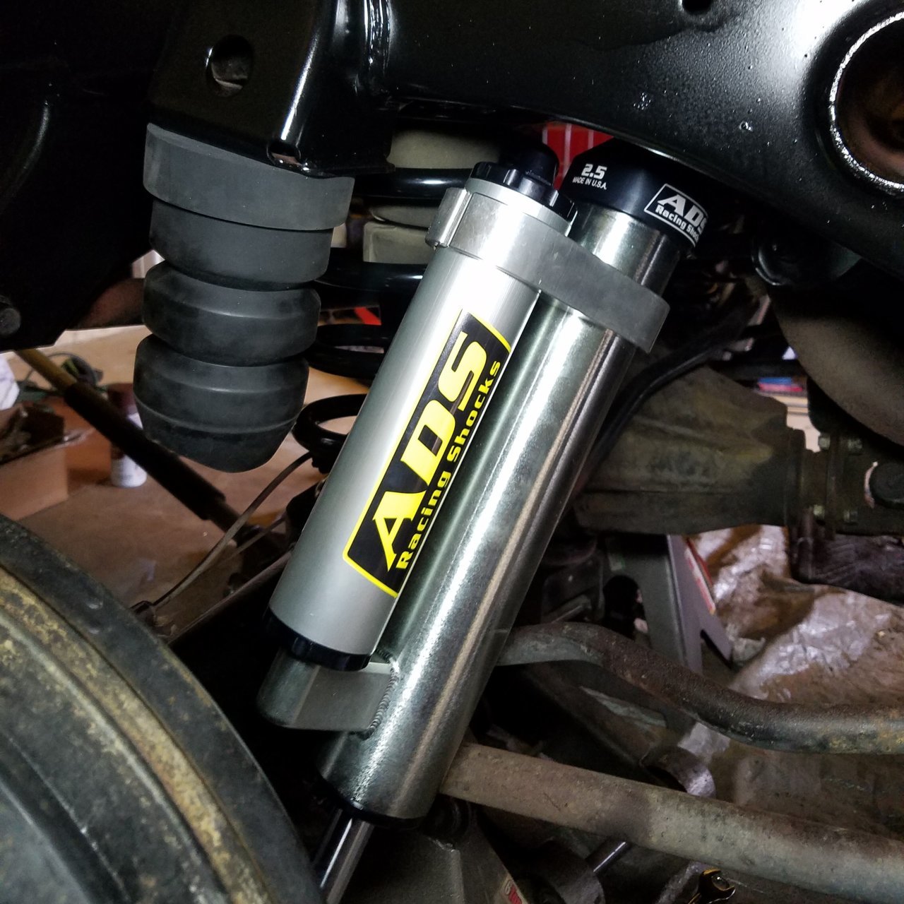

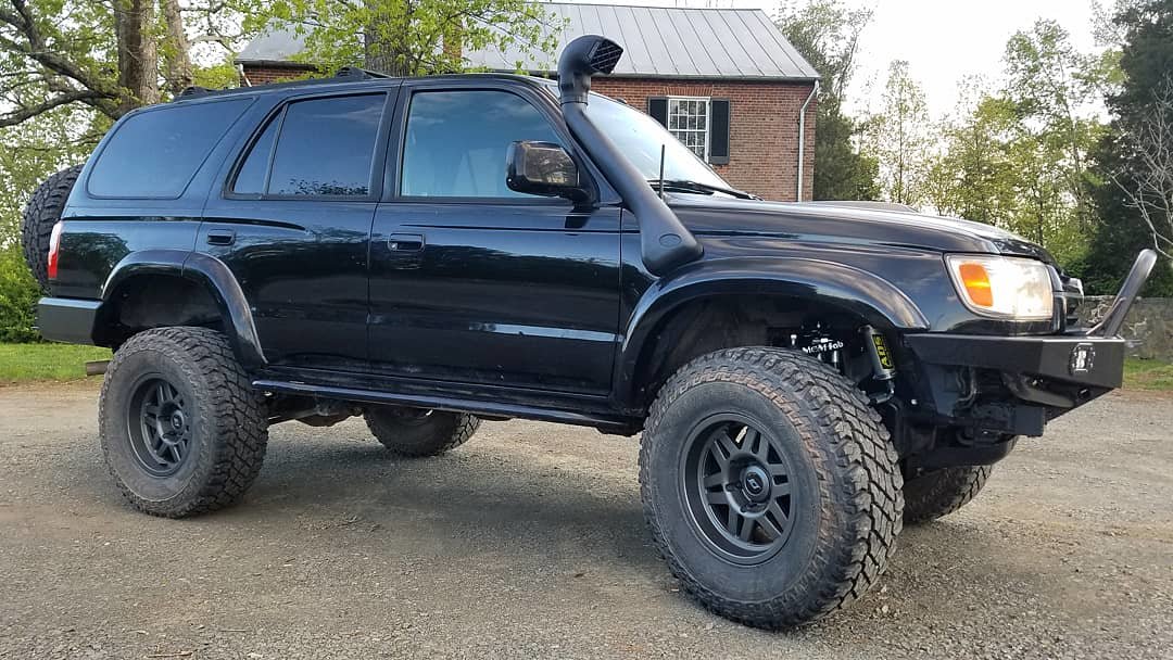

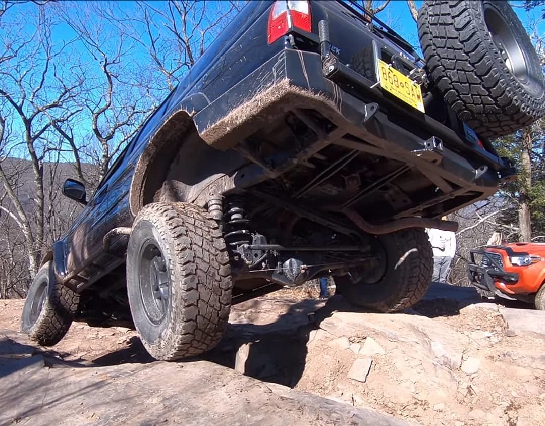

    You'll love them! I'm running the 2.5s with resis up front and the 2.5 piggyback shocks in the rear. This setup has been great on and offroad!
