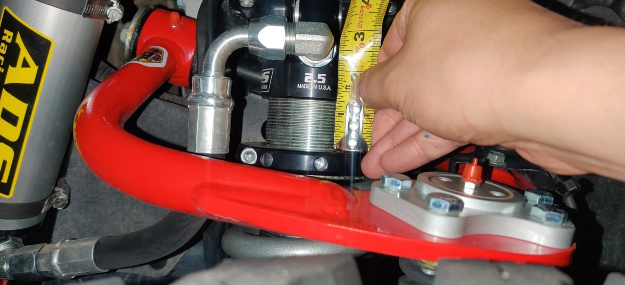

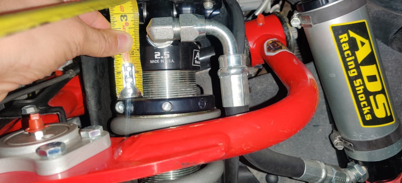

    I'm right at 23". I wanted only 2" of rise

    Do you by chance have the compressed and extended lengths of those coilovers from ADS? This will help us determine where the shock is sitting at ride height. Similar to measuring shaft showing, but if you don't know the shock lengths, shaft showing is pointless. Too much preload (NOT equal to threads showing) would reduce the amount of down travel the shock can have and provide a harsh ride. If the measurements come back good, we can rule our shock setup and move towards diagnosing some other issues.

    A couple of months. This only started after I cranked up the rings after installing new load E tires. I don't think I went too high. I even took it back down a couple of turns on each side after going up initially. Hell, maybe it's just the tires slamming down hard, idk. I'm gonna mess with the adjusters like Tyler from ADS said. I'll see if that addresses this.

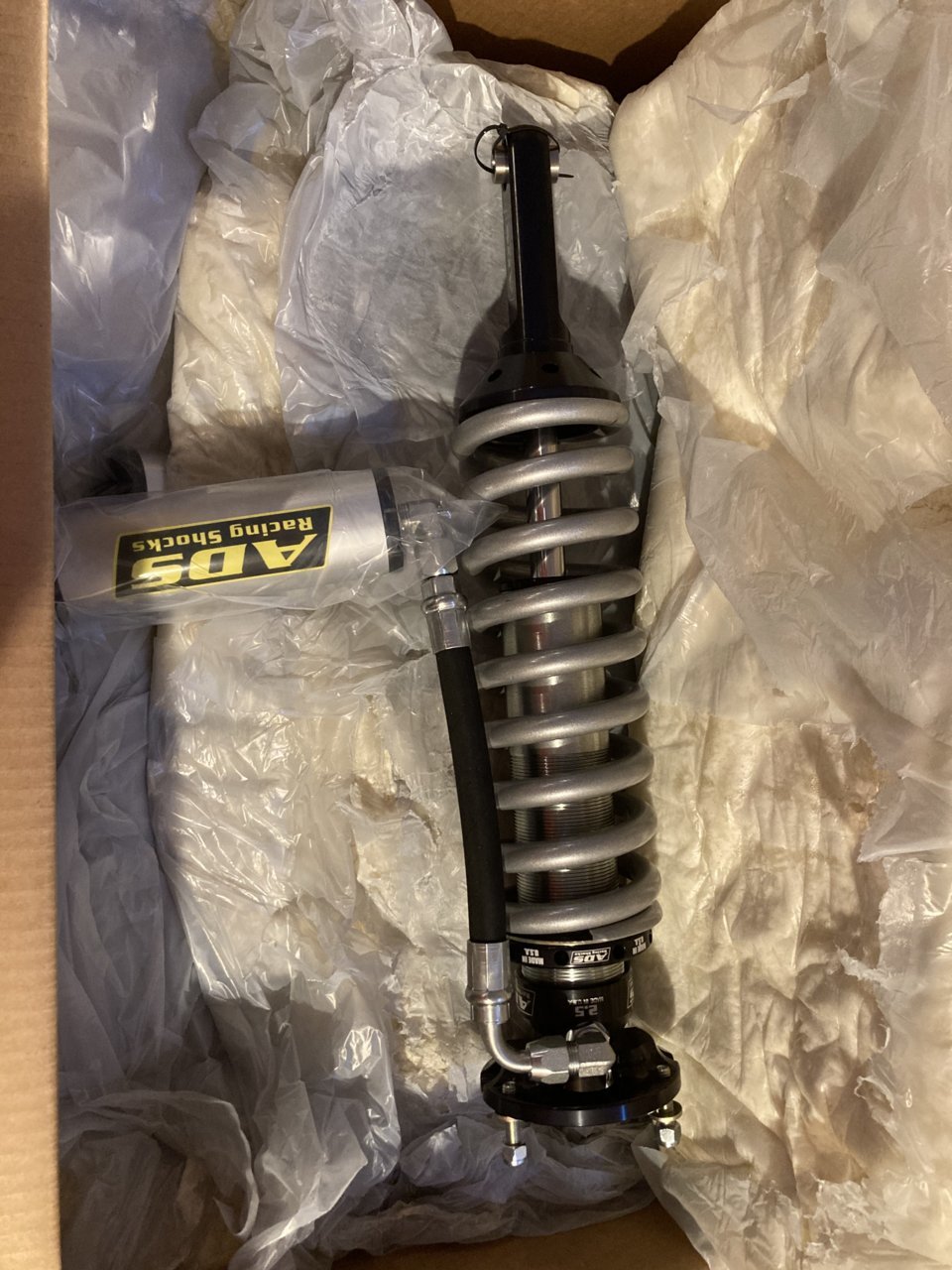

    The last piece in my pile just showed, time to play!!

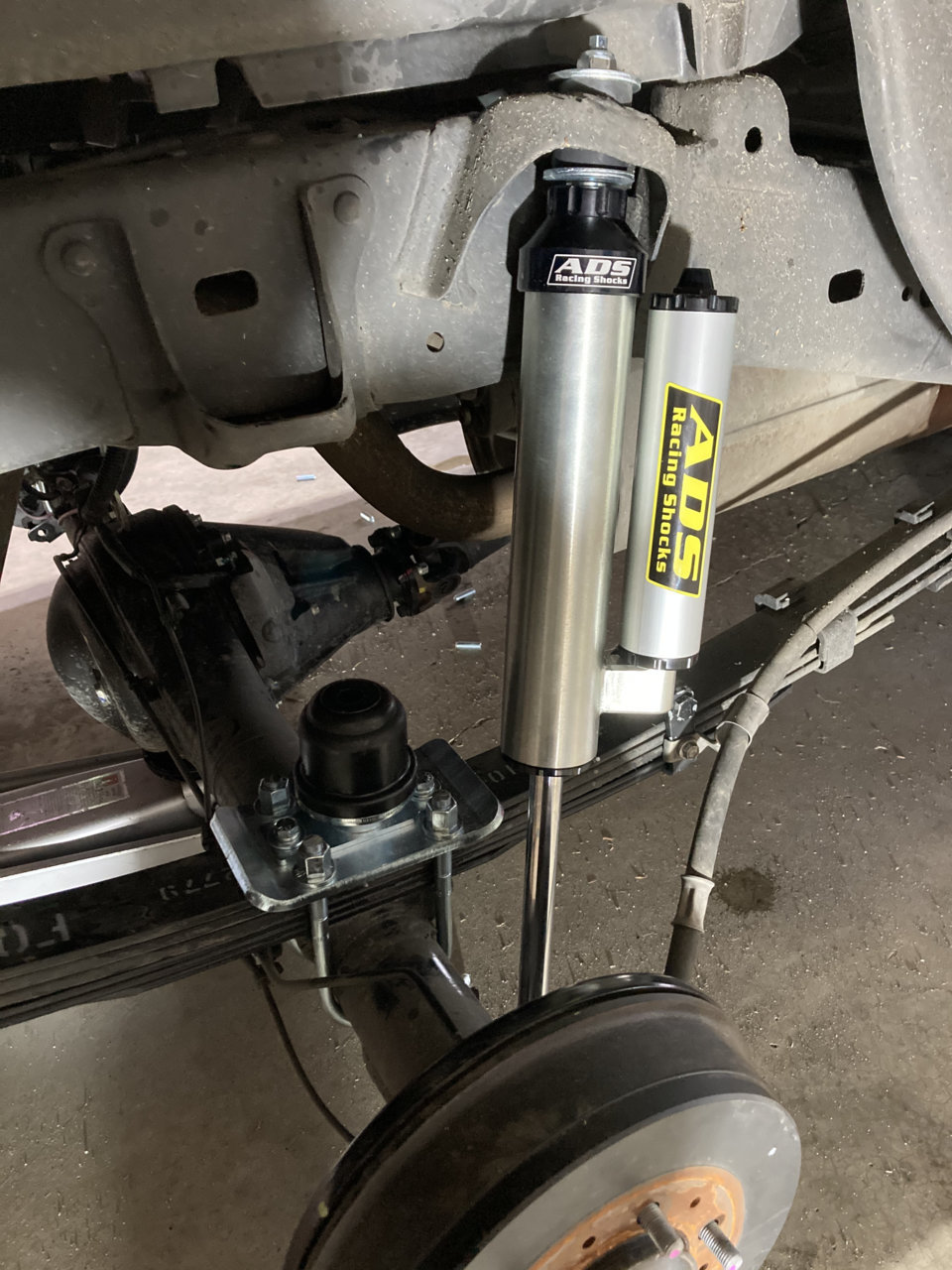

    Rear suspension install done! interestingly, the ADS piggyback shocks seem to fit great on the drivers side, but where the resi faces forward on the passenger side, clearance is rather tight in a few spots. I don’t “think” it’ll be an issue but things are a bit closer than i’d like, even after adjustments.

    Did you tighten the top nut all the way to the end?
  20. Feb 20, 2021 at 10:09 PM
    #4600
    Traction
    Traction Well-Known Member
    May 23, 2016
    #187673
    1,321
    WA
    2020 TRDOR
    I tightened it until the shock wouldn’t spin easily, i don’t think i bottomed it out though. You think it needs more torque? the factory spec is under 20 ft/lbs if I remember correctly.
