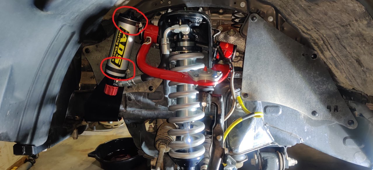

    I had no issue getting mine tightened down, was more just commenting on how close the resi is to both the upper shock mount cup and the u-bolt plate. This is with the shock slightly turned outward (away from the mount).

    Traction[QUOTED] likes this.

    That’s a good point. There is a lot of resistance if I try to grab and turn them. I suppose that’s good. the lower shock mount pretty much touches the round flange on the actual shock under articulation. there’s nothing I can do about that, though.

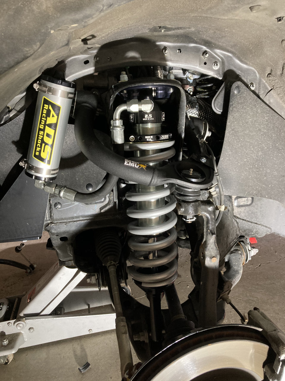

    UPDATE: Truck drives really nice. The Front swaybar is really close to the bottom coilover bucket, its going to hit on both sides, even with the relocation blocks installed. This is slightly concerning because I am not sure where I can gain more clearance. Also, with previous coilovers the bottom mounting bushings typically include a longer and shorter in order to push the coilover back at its base. The ADS coilovers came with equal sized bushings, is this normal? Any ideas?

    Don’t be afraid to give it a test run without the sway bar. It’s not for everybody, but I’ve been running without a sway bar for about 20 months now and it’s been doing great.
    My lower bushings are the same length of both sides as far as I can tell. Haven’t had any issues thus far with anything hitting.

    My sway bar was interfering with the radiator brackets and the lower end link bolt was hitting the coil spring even with the relocation. I yanked it out and I'll probably keep it out. Rides cherry with heavy springs.

    Thanks for the tip and for having a look at your bushings. I have run no swaybar in the past, its not bad but I would like to see if I can make this function before removing it. I will experiment a bit in coming days and report back.

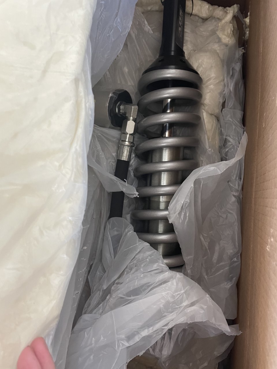

    Front and rears showed up on Saturday. Installing these bad boys tomorrow.
