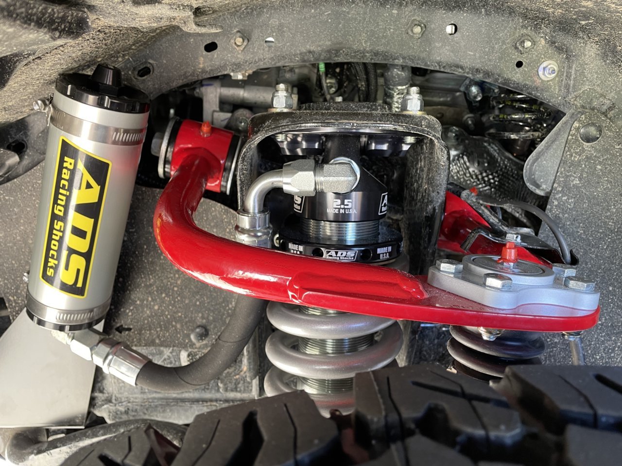

    A small update: I was able to gain some clearance on the swaybar and reservoirs by massaging the mounts a bit. Regarding the endlink on the swaybar side, I think I can install a small bushing on the balljoint side to reduce the amount of thread protrusion, which will keep the endlink from bashing into the lower spring seat.
    These solutions have gotten rid of most of my knocking sounds. The only things left is popping while turning, which I assume is more of a normal thing in the setting of solid bushings and a bit of coil bind. Are you guys experiencing little pops when turning sharply (like parking)?

    My alignment is set for Thursday morning, I wanted to let things settle a bit before getting it done. This popping im hearing is not tire rub or fouling. I think it may be due to me changing the preload while they were on the truck (it was set opposite sided accidentally by ADS). I think the tension may be causing the spring to bind? That's just a theory. Im only hearing this pop when im under 5mph in tight turning scenarios like parallel parking, where quick back and forth happens.
