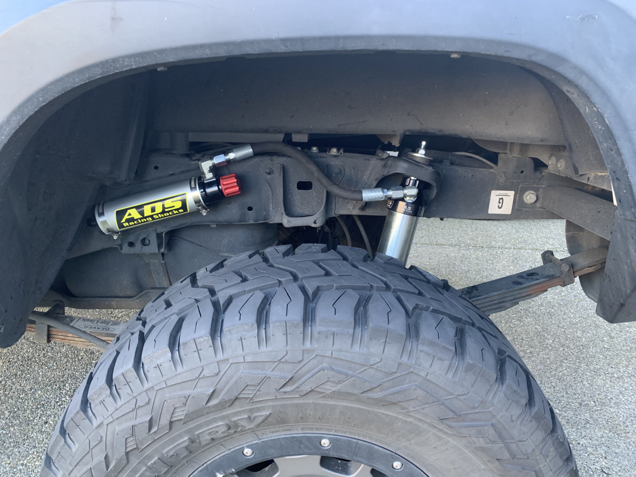

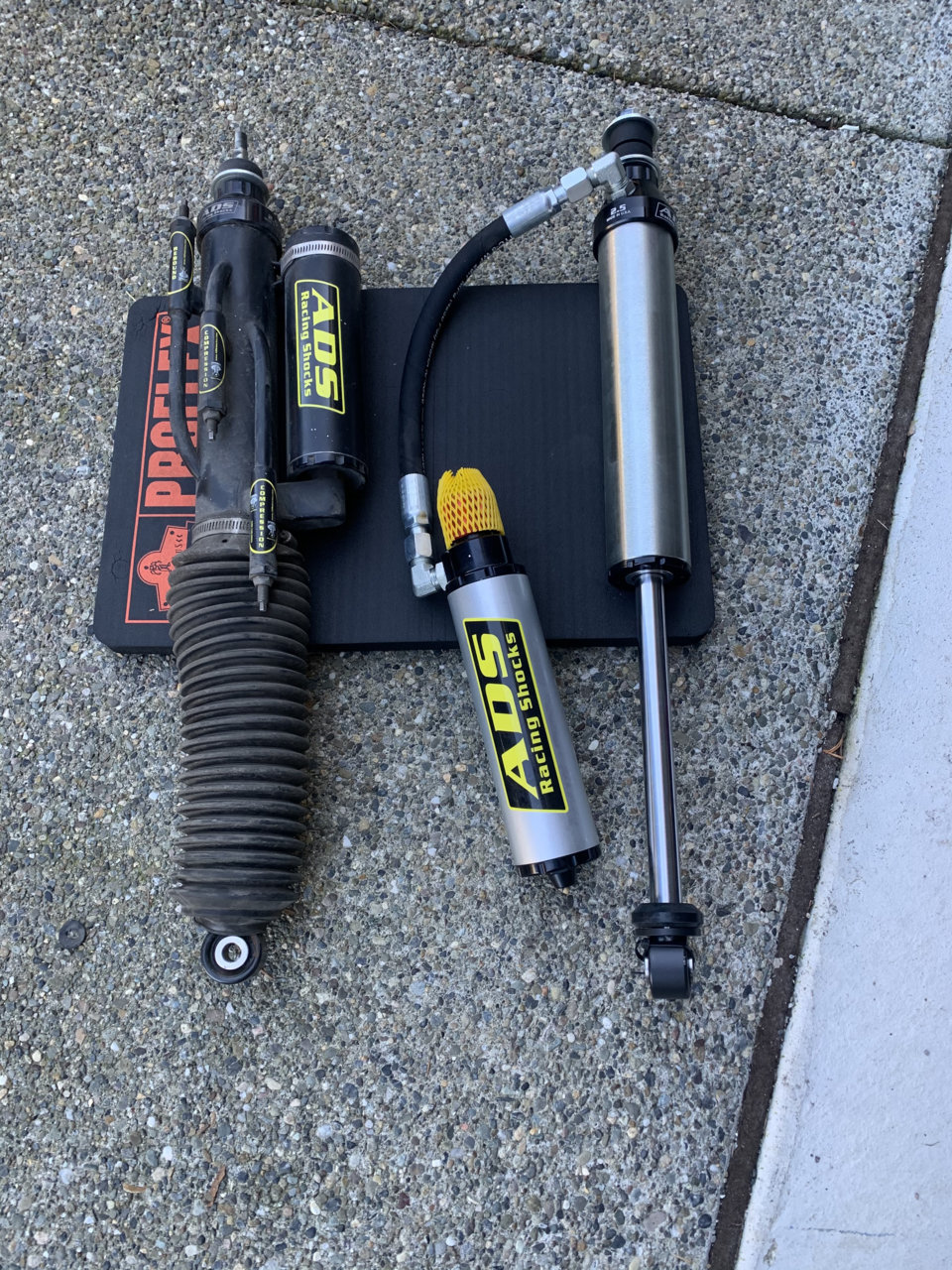

    I swapped out my bypasses for some remote reservoir shocks. We moved away from the desert, and mainly wheel tighter trails in the mountains. The bypasses are great, but I always hated all the noise they made. IMG_2777.jpgIMG_2778.jpgIMG_1849.jpg

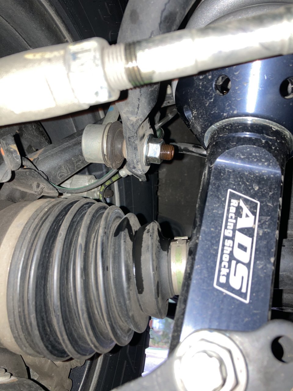

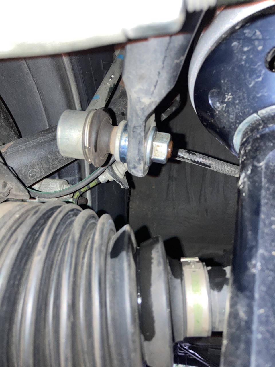

    My endlink was coming really close to the spring seat under compression so I added a steel bushing to the balljoint side to give it more room. Much better now. Here’s a before and after, look at all that room!

    I cut the end of that bolt off with my Dremel when I noticed a slight rubbing on the coil. Chopped about 1/8-3/16” off

    There you go! two ways to get the same result!

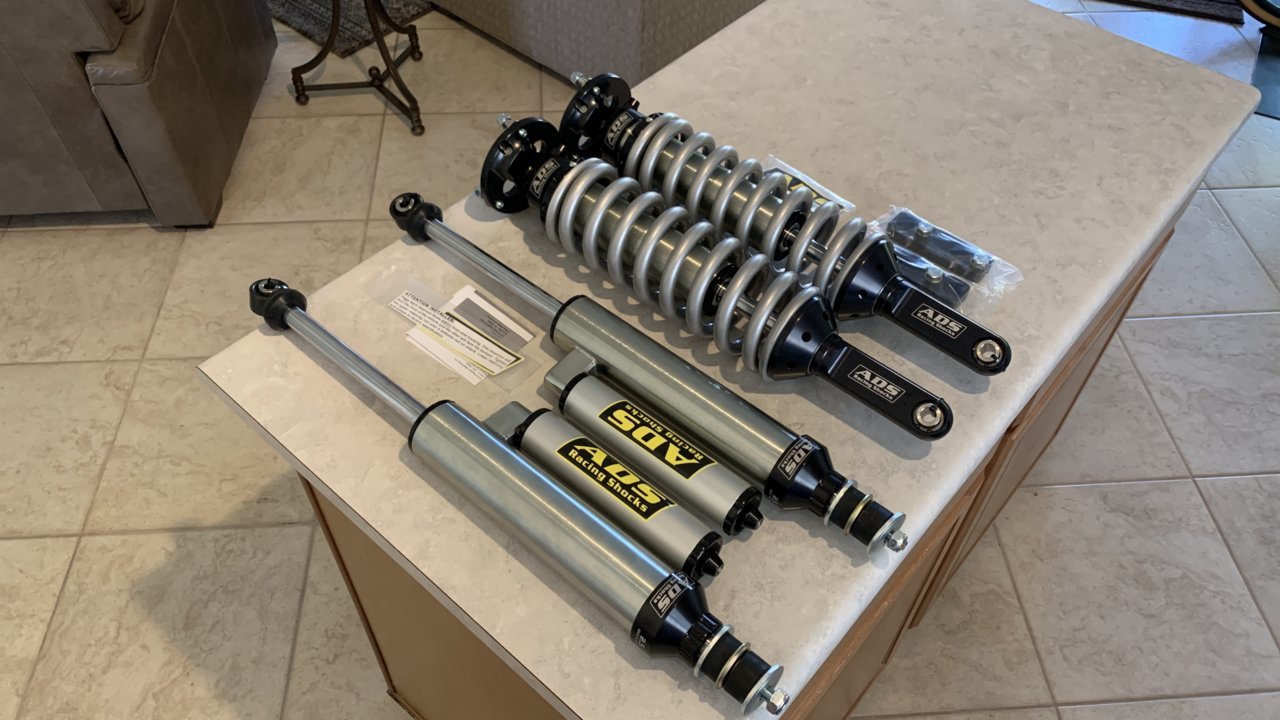

    All of my rear suspension stuff have slowly been trickling in and the last and most exciting part finally arrived :D

    Would you mind measuring the shafts exposed and the total length eye to eye (centers)?
