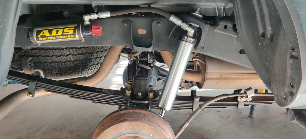

    I have a question that hopefully, someone here can help me try and understand.
    I just got done installing front and rears w/ resi on my '20 OR, and on the rears specifically after everything was torqued to spec and completed, I noticed that the body of the shock is able to spin around if you if you apply any force to the shock body. Nothing is loose and there is no rattling or odd behavior from the shock itself just this ability to spin once torqued. I have never experienced anything like this so I am quite perplexed by this different behavior especially when the OEM Billstein's were locked and could not be moved.
    What I am looking to find out is 1. is this normal expected behavior of these shocks? 2. Am I missing something that should have been done?
    Any help or insight is appreciated.

    Not sure if I did mine correctly, but I wrenched the top nut all the way to the end of the threads. It takes a good amount of force to get the shock body to rotate. It has been this way for months with no issues.

    This happened to my piggyback shocks, have some scarring on the shock body from it. I just tightened(probably way overtorqued) them up as much as possible and that seemed to help quite a bit

    I noticed my piggybacks were pretty loose and was worried about rotation as well. I was able to get them tight enough to where they don't rotate easily.

    So that is the thing. I torqued that top nut as far as I could, and that was when I first noticed the body and the resi hose was moving. So then I thought perhaps I need to actually have a wrench on the shaft top also, and there is no further torque that I can see to add by hand or even by any power/air tool.
    To further clarify and make this confusing, it doesn't seem to rotate after a drive, however, if you apply any hand pressure or power to just that body you can move it fully with a good amount of force applied.

    Maybe compare the exposed threads on top. Mine really don't move.

    Yeah same amount of thread just on a quick look at this image compared to mine. Either way, I appreciate all your help, I am just not going to stress it. I torqued it as far as I could and that I think is that for now at least. I will keep an eye out for any scarring or random issues.

    You’re only supposed to torque the top nut until it begins squishing the bushings. You’ll destroy the rubber bushings if you over torque the nut. That nut is also a nylock nut, so it won’t back out. All screw top shocks will have the ability to rotate, that’s just a flaw in the design of the mounting system. Orientate your piggy-backs so that gravity will keep the reservoir from rotating. Remote reservoirs don’t have to worry about it because the hose and resi keep the body from rotating.

    I checked mine today. The bushings aren't really buldging, but I think I'll back off the nut a little bit. Thanks

    You want them to be snug. Just not deformed. If they aren’t bulging, leave them be, the bushings won’t expand if you loosen the nut, so best to leave them so they won’t be loose.
