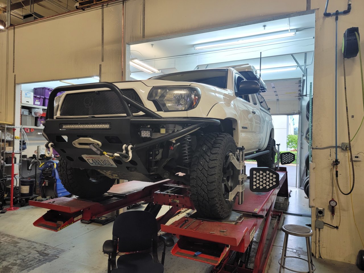

    Lower them to 35. I used to run 33 psi in those when I had them. Im guessing they are e rated. You are going to want to run them way lower than 38 psi because the truck is light compared to what the tire is rated for.

    Well I had them at 38, just checked and they all dropped to 34.5, air density with change of weather I imagine. I'll try a few different pressures and see. But the shocks are still getting revalved. About 600# extra in the back and I'd rather have the valving for it

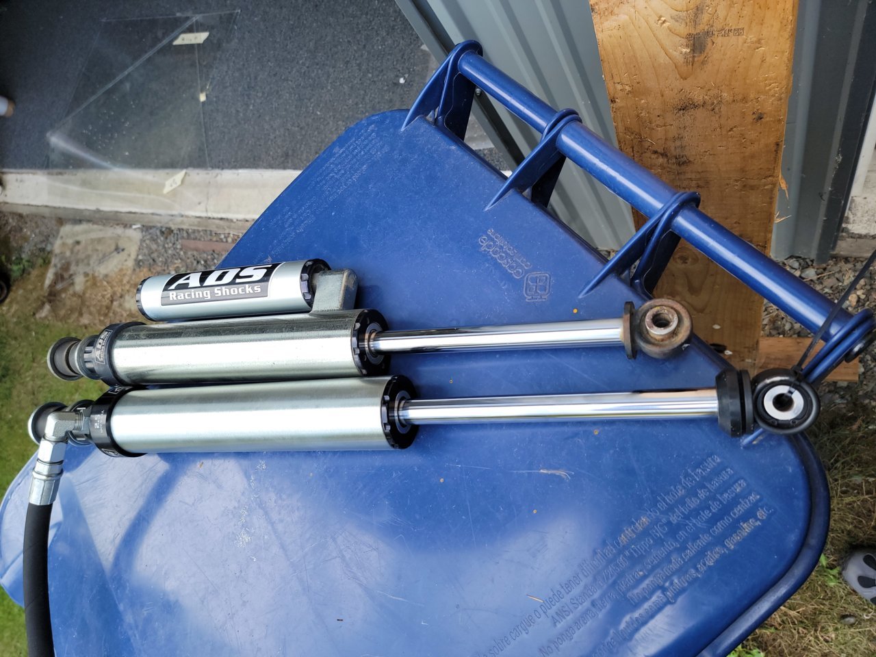

    Got my shocks back from ADS, and found this interesting. When I swapped to the piggyback shocks they went in way easier, didn't have to compress them into the lower shock mount, whereas I had to lift the axle to get the other ones in. Huge difference in length between the two

    Smaller shock, of course it will fit easier. You also are going to lose a couple inches of droop travel.

    It's kind of a wash, right, because you'd have more up-travel with the shorter shock, assuming the bump stop doesn't limit the travel...

    You went from a remote reservoir to bottom take off piggyback? Or other way around?
