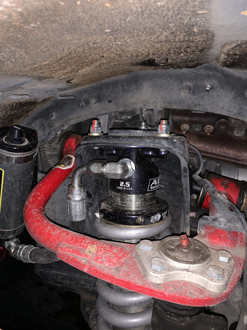

    Adjusted my fronts (ride height: added) and now i hear a weird noise is coming from the driver side i believe when i go over bumps and such. Double checked to make sure everything is tightened down. Any suggestions? Hard to describe the noise.

    Check where your anti sway bar comes close to the coil spring. It's a tight fit in that area, so yours might be tapping each other.

    I have my sway bar removed

    Does the remote hydro fitting come close to the UCA, enough to possibly touch under load?

    Check the hoses, you sure you ain't hitting them?

    Do your best. Try describing the noise.
    How much ride height did you add?

    i’m positive the hoses are not touching.

    It’s almost like a clunk noise but not lol. I’ll see if I can get a video of it. I added about an inch.

    You changed the collar position exposing 1" of threads, or a 1/2" more?
    Did you get a new wheel alignment after making the change?

    It could be coil twist causing a slight noise as the suspension flexes now that more pressure is on the coil…try adding a little Lubricant where the coil end rests on metal…just guessing

    maybe just hitting your bumpstops now / harder than before
    find a pal with a go pro and get some vids maybe

    I'll throw another thought in here... maybe the shock is topping out since it has additional pre load pushing it to ride closer to the top of the stroke? Or ball joints reaching the end of their range? I had a similar issue where I think my ADS shocks were topping out, or coulda been my ball joints maxing out. Mine was like a muted thunk, not quite a metal to metal clank, but enough to get my attention.I never dug hard to find the source on my 2nd gen set up. Although my issue would only present itself during quick full droop scenarios, such as bouncing through whoops, or quick drop offs. But I didn't add any additional preload to how they came.

    1/2” more. Probably around 2” all together

    Should i have them softer or firmer as well? I have 650lb springs with roughly 2” lift and notches turned as soft as you can go

    As others have mentioned, it could be topping out. And having the clickers at 0 would make that easier to happen. Increase the compression to 10 to see what effect (besides stiffening the ride) that has on the noise you are hearing.
    2" of lift shouldn't be too much but you have definitely changed where you are in the shock's stroke at ride height.
