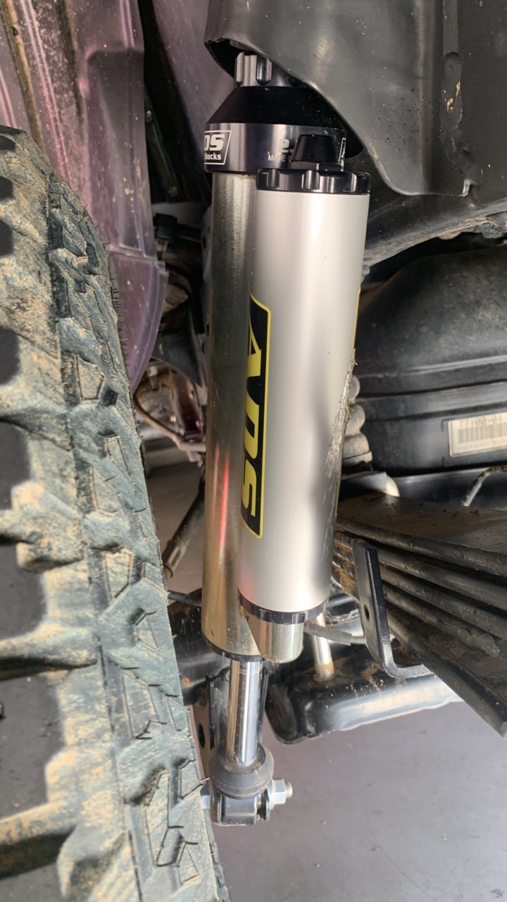

    Help needed. I’ve got some ADS piggybacks on my rear axle. Love the shocks but have encountered a problem. My driver’s side shock is making contact with a bracket on the OEM leaf pack and scarring it up pretty good.
    Question for anyone who has these shocks or feels they know the answer: does the resi on the driver’s side face to the front or rear of the truck?
    Any help is appreciated.

    The resi should be on the low side of the shock. It faces different directions on each side.

    Sorry, heres a photo of my ADS... also resi on the low side...
    To keep the resi from contacting the leaf pack... tighten the upper nut until the shock body can no longer rotate on its own.

    So this is how I have mine setup (same as yours). This is looking from the rear of the truck. Here’s the hits I’ve been taking:
    You can see where the bracket on the leaf pack was hitting. These have been on about a year with no issue. Top nut is tight. Was bombing down 30 miles of washboard and potholes at about 20-35 mph when this happened. Not sure what to do.
    Bertw192[QUOTED] likes this.

    If the top nut is fully tightened and the shock body still rotates, I'm not sure there's anything you can do. Your upper rubber bushings may be worn out and in need or replacement. That certainly sucks and is a common problem with piggy backs.

    I pushed the resi back out of the way once I noticed it. Took some effort. I’ll check tightness again tonight. They’re so pretty and work so well. I kinda wanna cry.
