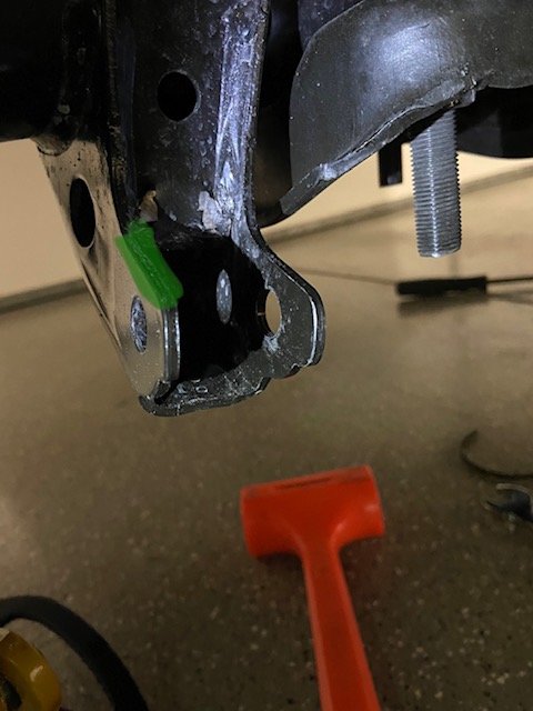

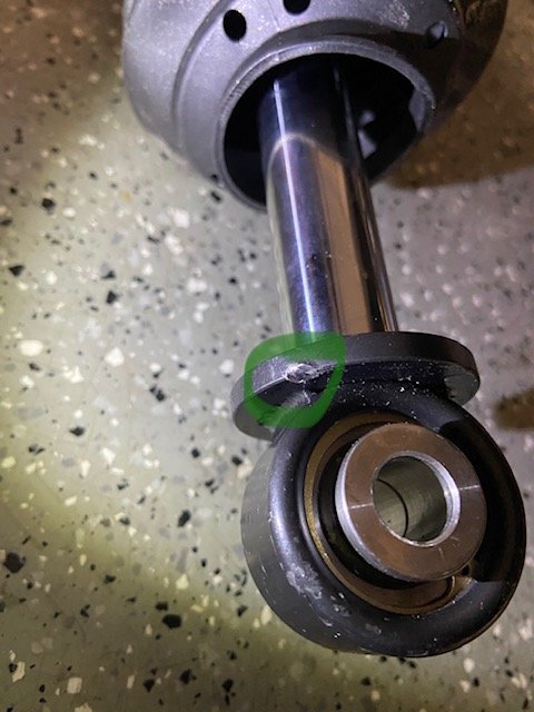

    I'm 90% sure that black washer welded on the ADS shock, is interfering with the trucks lower shock mount "ears". I gave her a good hit with a dead blow and made a mark on the black washer to see exactly where im contacting...
    I'm thinking I have two options..
    Grind down the Trucks Lower shock mount " ears" Picture #1
    Grind down ADS shock black washer Picture #2
    Whats your opinion..

    Switch the shocks side to side. See if that one interferes with the other side and vise versa.

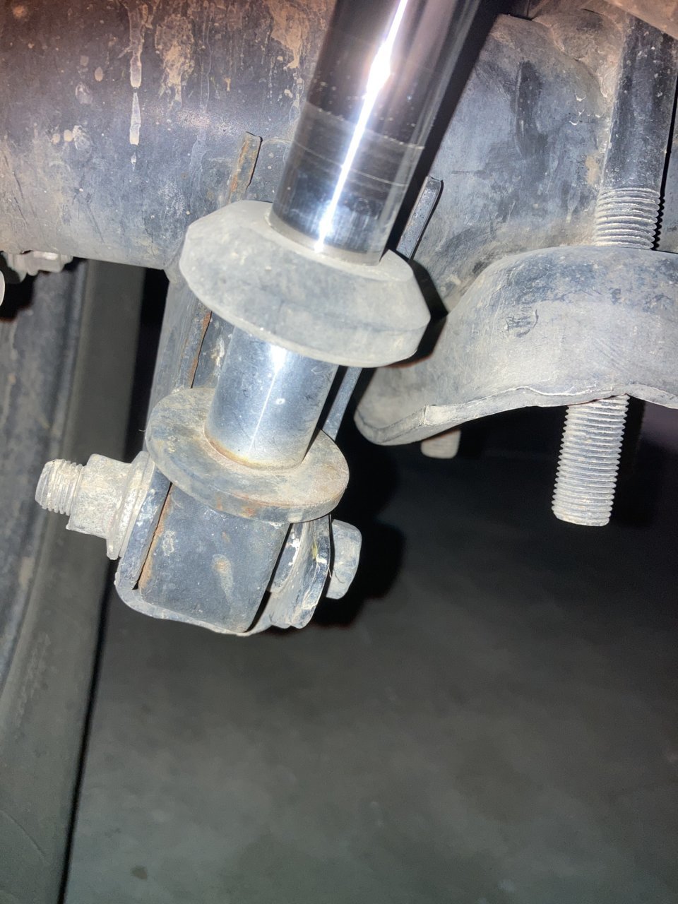

    here is how mine looks

    Sorry, that one took a bit.. Just swapped them, no dice, exact same angle.
    I'm thinking Mr. Die Grinder is coming out.

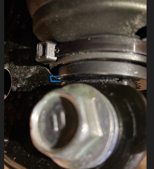

    This is my Driver side, you can see that black welded washer, next to those ears is super close as well. Is yours that close? I can't even come close to fitting a credit card in there.

    same side or did it follow the shock?

    Seems to be the shock bracket, not the ADS shock. When I swapped sides, the only effected side was the passenger again. I ended up just using a die grinder and putting some por15 on it. I'll cosmoline it when i wrap up the job. I don't mind grinding, but makes me think something is skewed or crooked with my setup.

    Well at least you figured it out. Basically a manufacturing difference then

    Yeah I tried that, I tried adjusting the pinion angles… nothing worked. Mr grinder made short work of it, only had to remove 1/16 of that ear

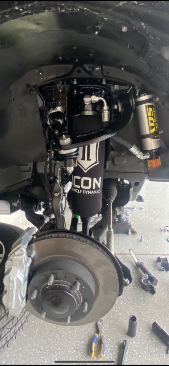

    It’s 2022 and my suspension identifies as icon?
    Got the whole set up in, extended brake lines, ecgs bearing, bump stops, icon rxt and the ads setup, I absolutely love it… super bummer though, my rear adjuster just unscrews and shoots oil out…….. it has no stops.

    bummer on the stops missing in that rear resi…very surprised. As for the Icon shock covers…is that something you keep on while you drive,…or just for offroading? Seems I’m behind on what these do. I kinda want some tho after my next rebuild
  15. Mar 27, 2022 at 9:38 PM
    #5115
    Cricket-0
    Cricket-0 Well-Known Member
    Jan 24, 2021
    #353902
    151
    Is a bummer, hopefully ADS can help me sort it out, it leaked quite a bit of oil on my garage floor so i'm assuming it needs a rebuild?
    On a side note, i can't believe how well these ride right out of the box, I was worried at 650lb and no weight on front it was going to be stiff ride. I wouldn't change a thing..
    The Icon Cover is for the winter, it feels like the material wet suits are made of, help keeps salt and junk out. I kept them on for the install so I didn't scratch the hell out of the shocks. They are removed now, and i'll put back on in the winter.
