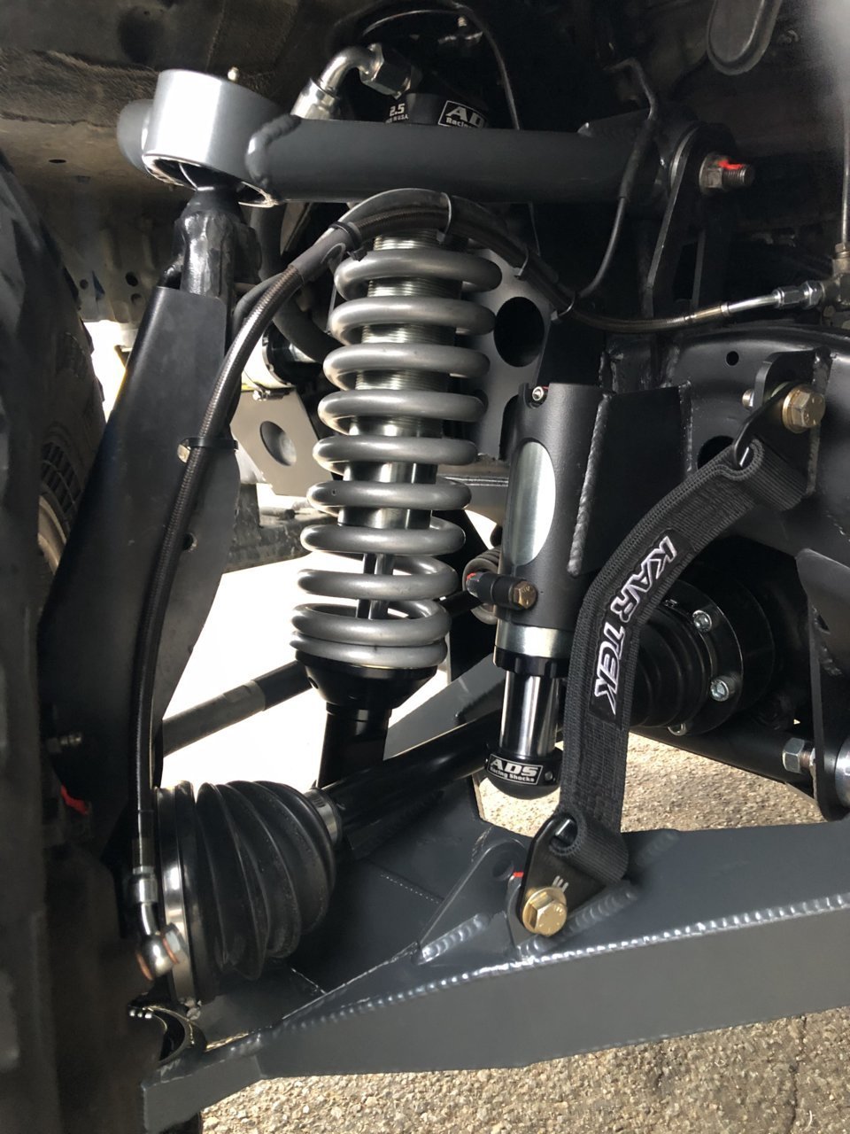

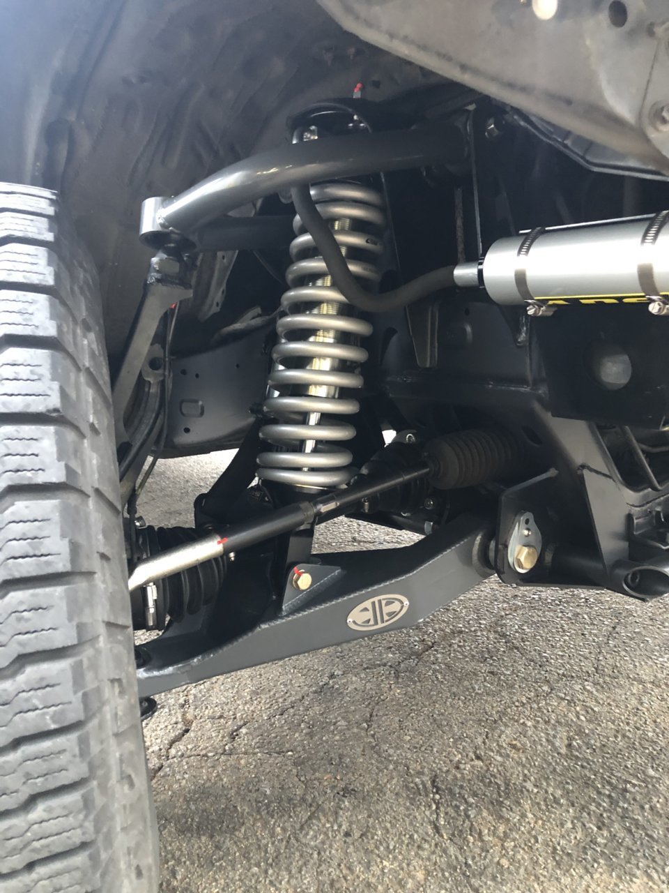

    Some ADS sexiness for y’all.
    AA2F5051-52E1-44DC-82AC-BA3A0C0C6F25.jpg 8584EC88-0F3C-44D6-B794-53CE337CFA4B.jpg

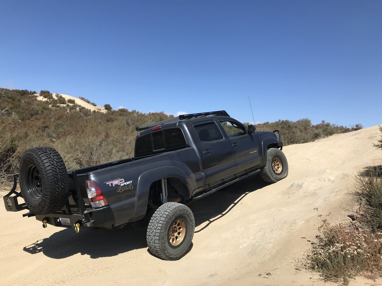

    Very nice. Here's some ADS sexiness in the rear I just put on a couple weeks ago

    Great setup. Is that their 2.125 body?

    2.5" front and back with the Archive shock relocation tower

    Cool. Lol, for some reason that photo makes the 2.5 in the back look small. But then again I’m used to the bypass being in there.

    It does look a little lonely there by itself lol. You don't really realize what it can do until you see it flexed out and then you're like "holy s**t!"
