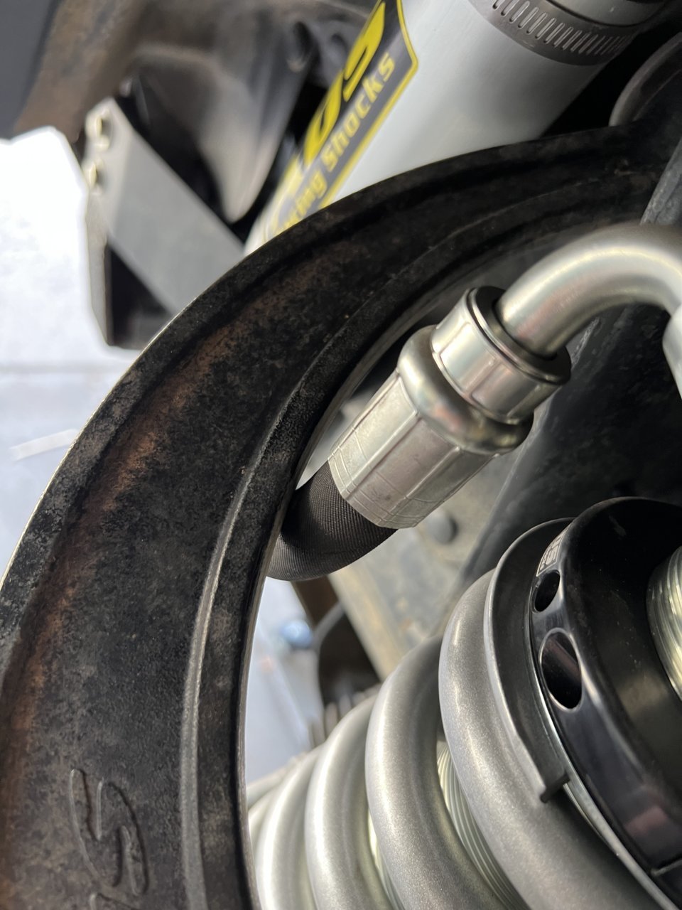

    Hey y’all, appears my UCA is rubbing on the remote reservoir line at full droop. Any advice? Here’s some pics

    Rotate and see if you can adjust your resi to move the hose.

    Loosen the reservoir clamps, push the hose until it's well clear of the UCA. While holding the hose clear of the UCA, retighten the reservoir clamps.
    Edit: if that doesn't work, you may need to loosen the 90° fitting on the shock body (only slightly to avoid leaks) and rotate the 90° fitting so it is more vertical, and not directing the hose towards the UCA.

    I’ll give that a try, appreciate the advice!
