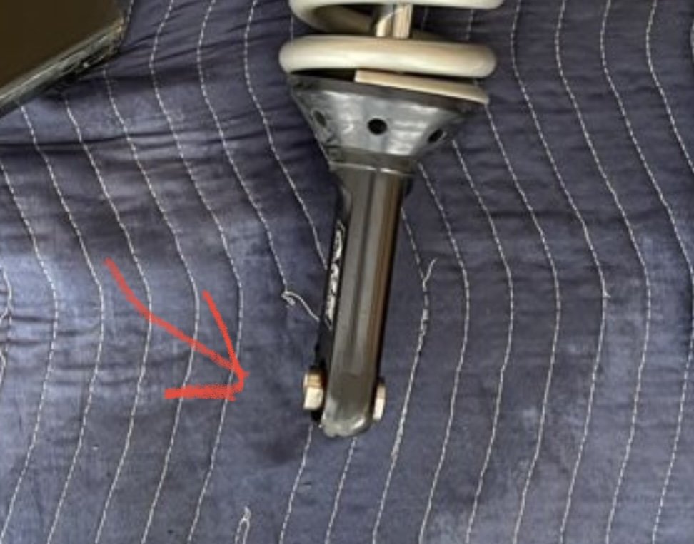

    See pic. This was binding on my front driver's side shock. Pulled the mount bolt, slid the shock out of the lower a-arm mount.
    It’s a two-piece, machined component, with one side fitting into and out of the other. I saw no damage, so I added a bit of light grease and reassembled. No more bind.

    Those are a teflon lined uniball and should not be greased. The grease will attract dirt and grime which will shorten the life of the bearing.
    The spherical bearings that come new in the ADS shock are the F1 spec and should be very tight. Too tight to wiggle by hand. It usually takes using the shock bolt through it to move it even a little bit when they are new. With time and mileage they will loosen up. And eventually they will become quite loose and noisy (typically a squeak when the wheel moves up and down) as the teflon lining wears. When this happens its time to replace the bearings.

    Edit: Just got off the phone with ADS. There are three parts in question: two spacers and the heim (spherical bearing). I was told light grease on the spacers is fine. I was told they do this with a lithium grease at the factory. I’m relieved now, as I’d hate to wreck my shocks.
