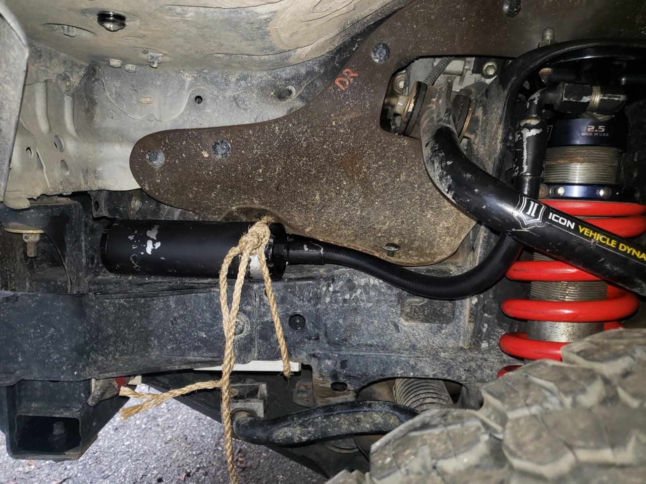

    Problem: I decided to swap in some used ADS coilovers... got them rebuilt... set the preload... then realized I don't have an easy way to mount the resis:
    Crap!
    I don't trust this solution to work on the trail, and I don't have time to fab something before the next trip, which starts... two hours ago.

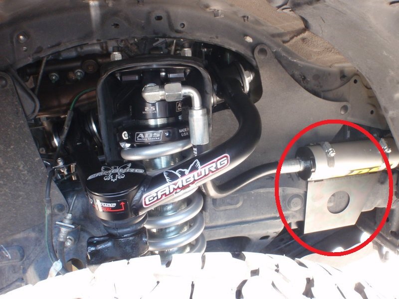

    Hey, I know this isn't what you're asking for at all, but whatever, I'm about to offer you something free... with a caveat.
    I have a couple of these basic mounts that you're welcome to (for free). Check the link, and the two photos that follow it. The caveat is that they are on the truck, and the truck is in Las Vegas, so I wouldn't be able to mail them to you until... Jan 26. Knowing how often you go on trips though, that rope might be able to hold you over :p.
    https://adventuretaco.com/bye-bye-t...a "new part" to secure - the remote reservoir
