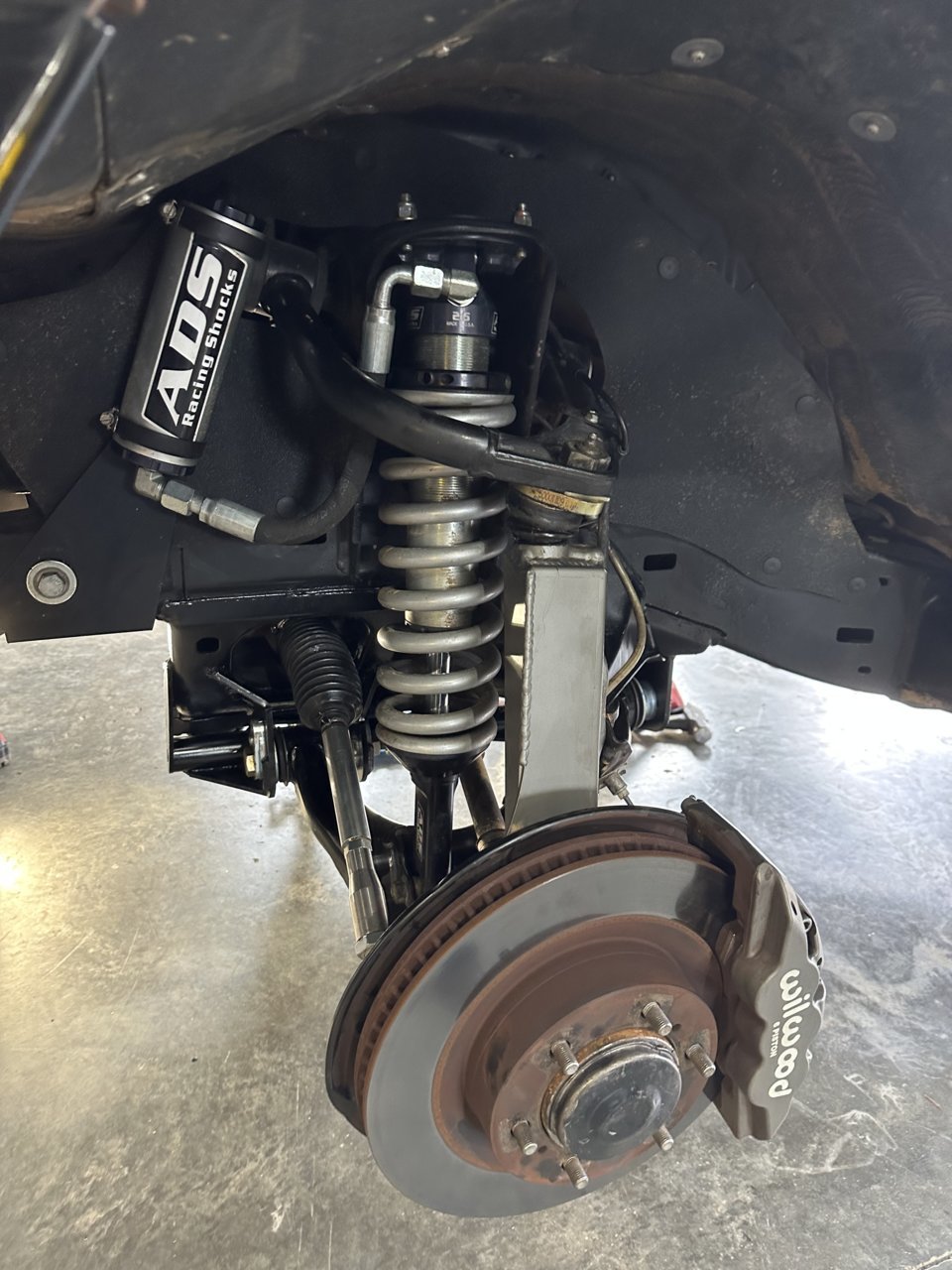

    Been running ADS for roughly 3 years now and realized I have yet to post in here.
    I do have a question, what are the symptoms of a binding spherical bushing? Any particular sound?
    PFA
    TSAVO, TRD493, TACOTU3 and 4 others like this.
