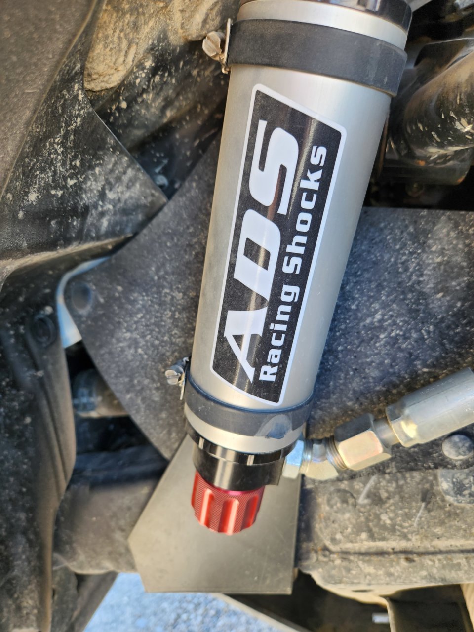

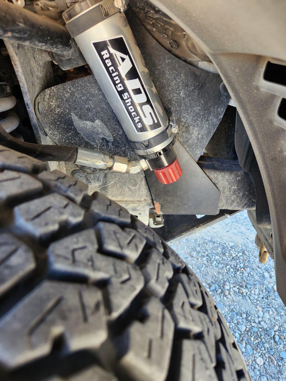

    It's all about the backspacing of your wheels and where you have the resis mounted.

    These are stock 16" trd offroad wheels

    Not my reservoir, but I do have a rub on the driver's side while backing at full lock...I just need to adjust the hose a little bit.

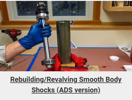

    I did the rebuild myself. Took a day to do all four, but of course, there's some specialized tooling involved.
    If you did/do have access to said tooling, I wrote up the entire process (with pics, necessary parts) here:
