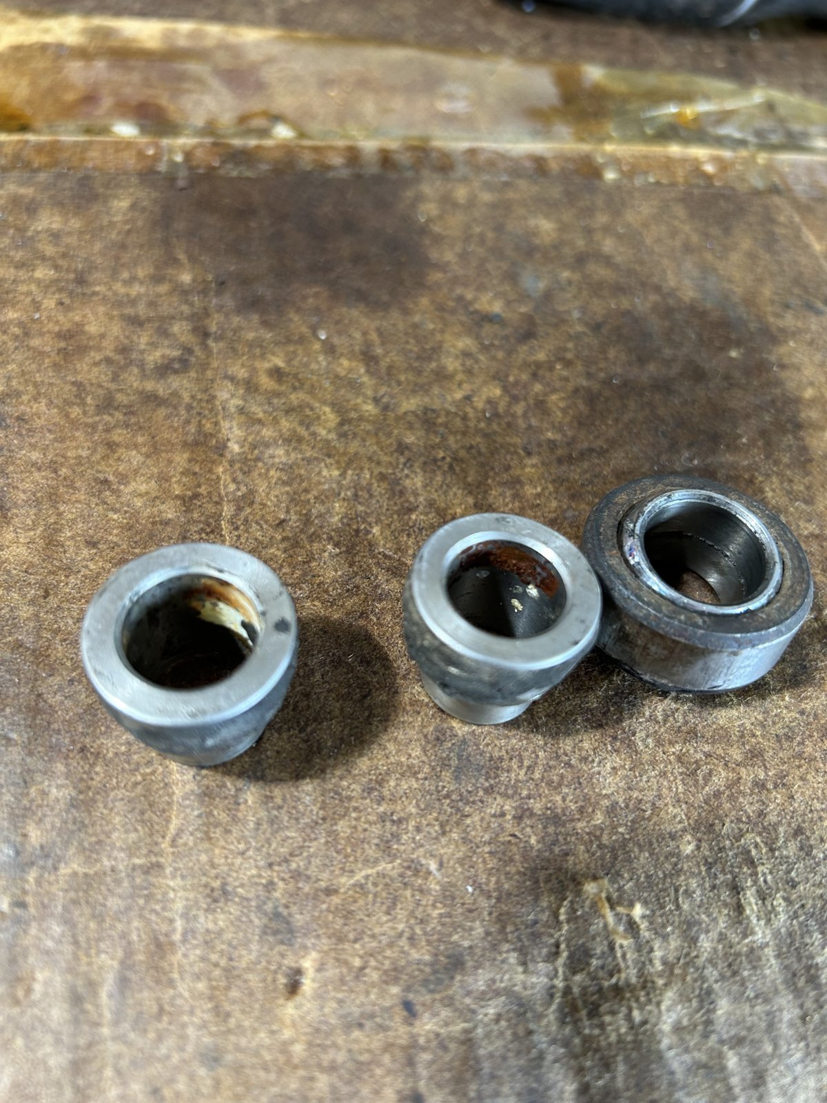

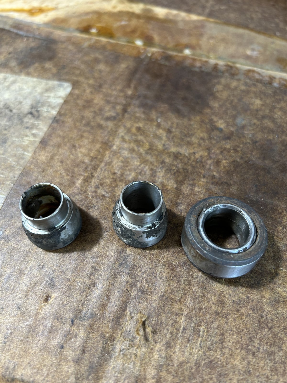

    36,000 miles in with my ADS coilovers on my older 4Runner and I finally replaced the bottom bearings (thanks for the killer service and parts @TMFF). I should start looking at a full shock rebuild after three years but wow do they ride nicely with the new bearings. Still recommending these shocks to everyone and anyone that asks.

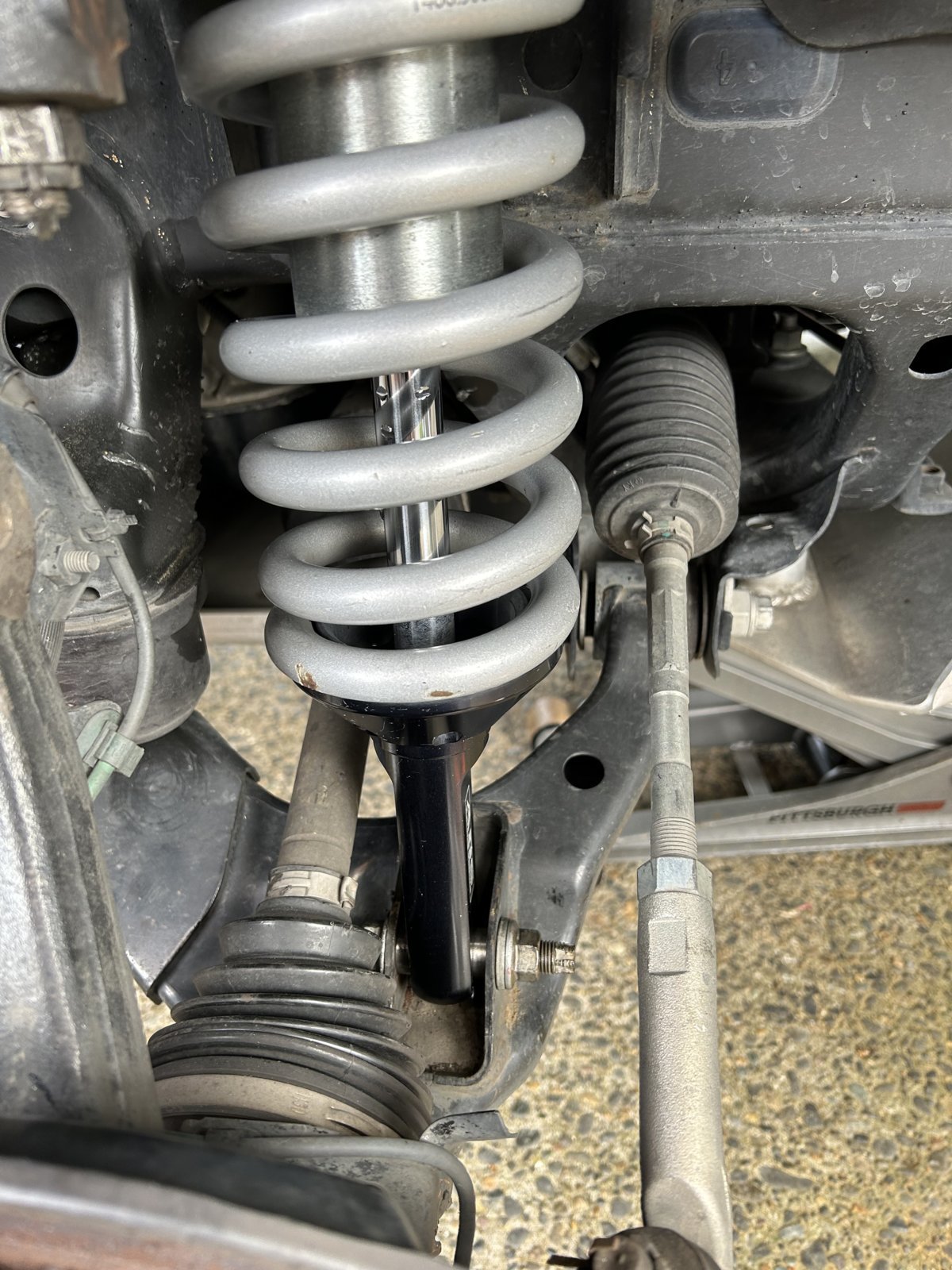

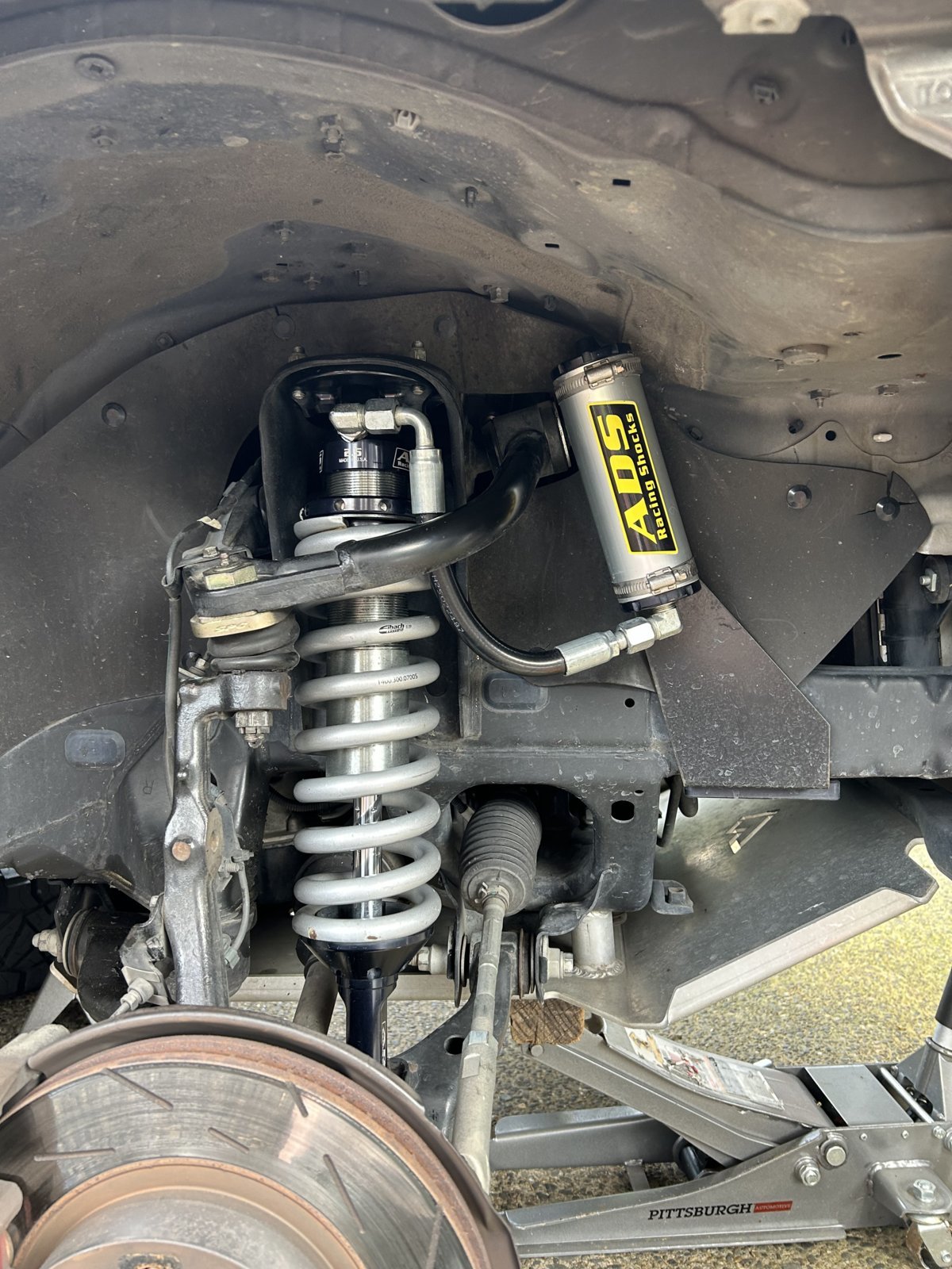

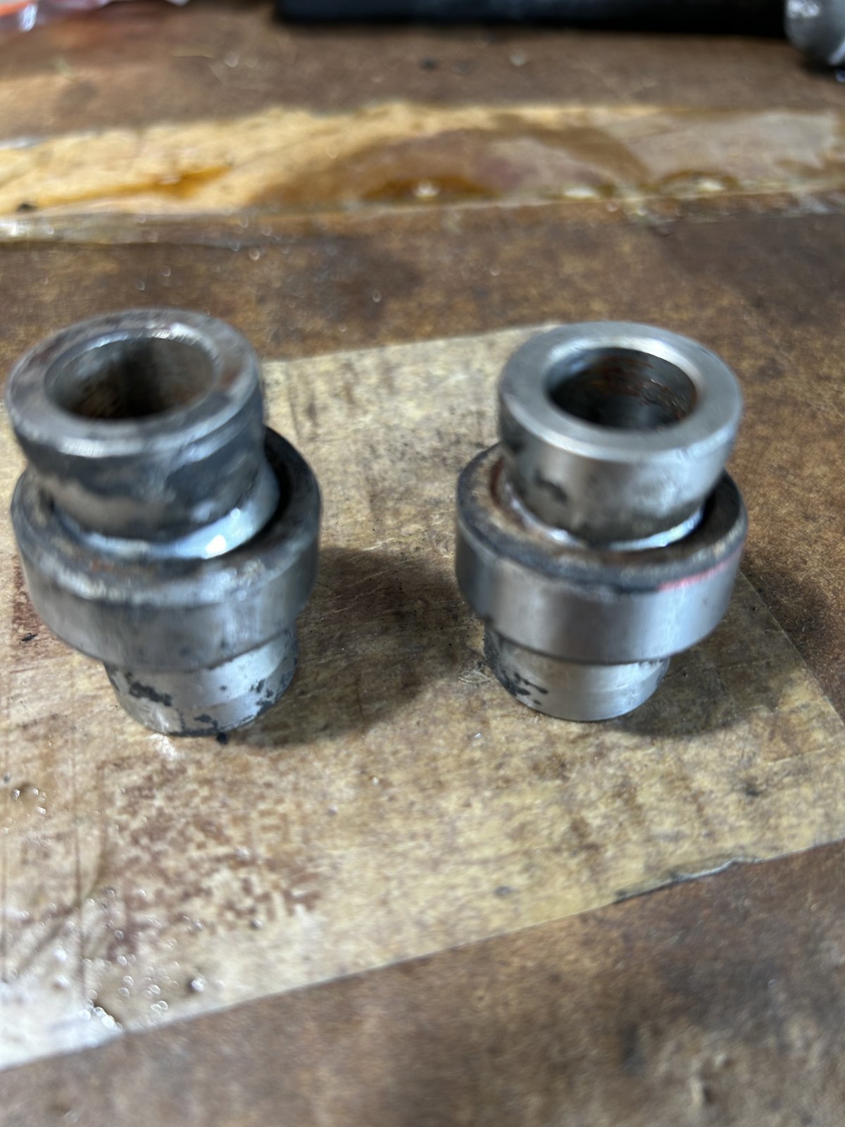

    Howdy All,
    Replaced the lower spherical bearings and misalignment spacers. The old ones had 31K+ miles on them and were just starting to get loose and squeek. so had some free time and pulled the coil overs and knocked out the old and threw in the new. Still no leaks but next year I will send in to get rebuilt.
    Be Safe..
    Dan
    RoaminRoman, H3llRid3r and TMFF like this.

    where did you buy those spherical bearings? Part #?
  13. Apr 15, 2024 at 8:58 AM
    #5273
    06TXED
    06TXED Well-Known Member
    Aug 11, 2009
    #21031
    723
    Tony
    Aurora CO
    2023 DCSB MGM TRD OR 4x4
    Got mine here https://www.303shockservices.com/
    I recommend the stainless versions and getting the upgraded bolts that fit the lower bushings better.

    Oh sorry just seen this. I got the kit from ADS (Tyler). I just emailed him told him what I had and he sent it out. Last year so I am not sure of pricing now.

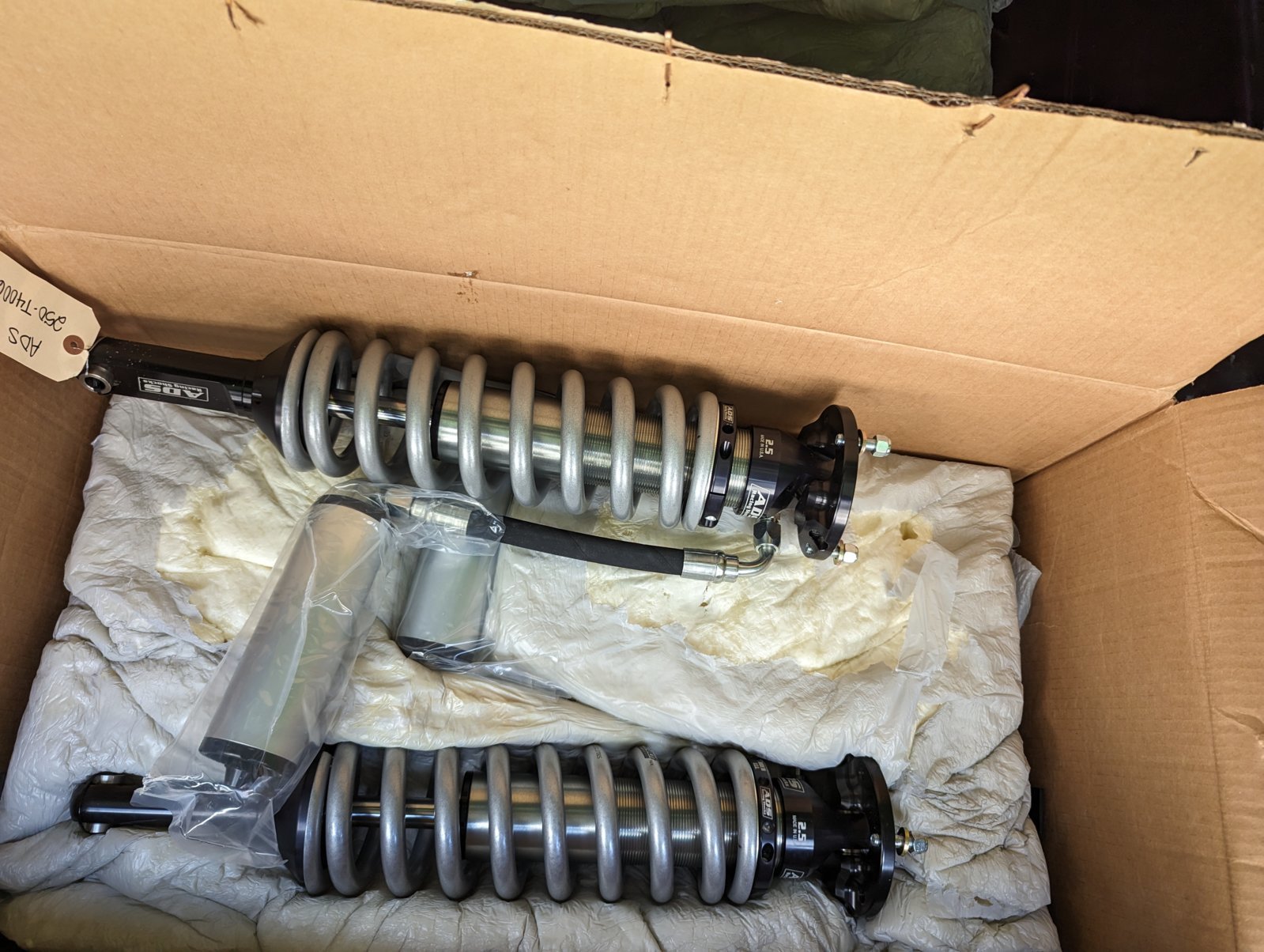

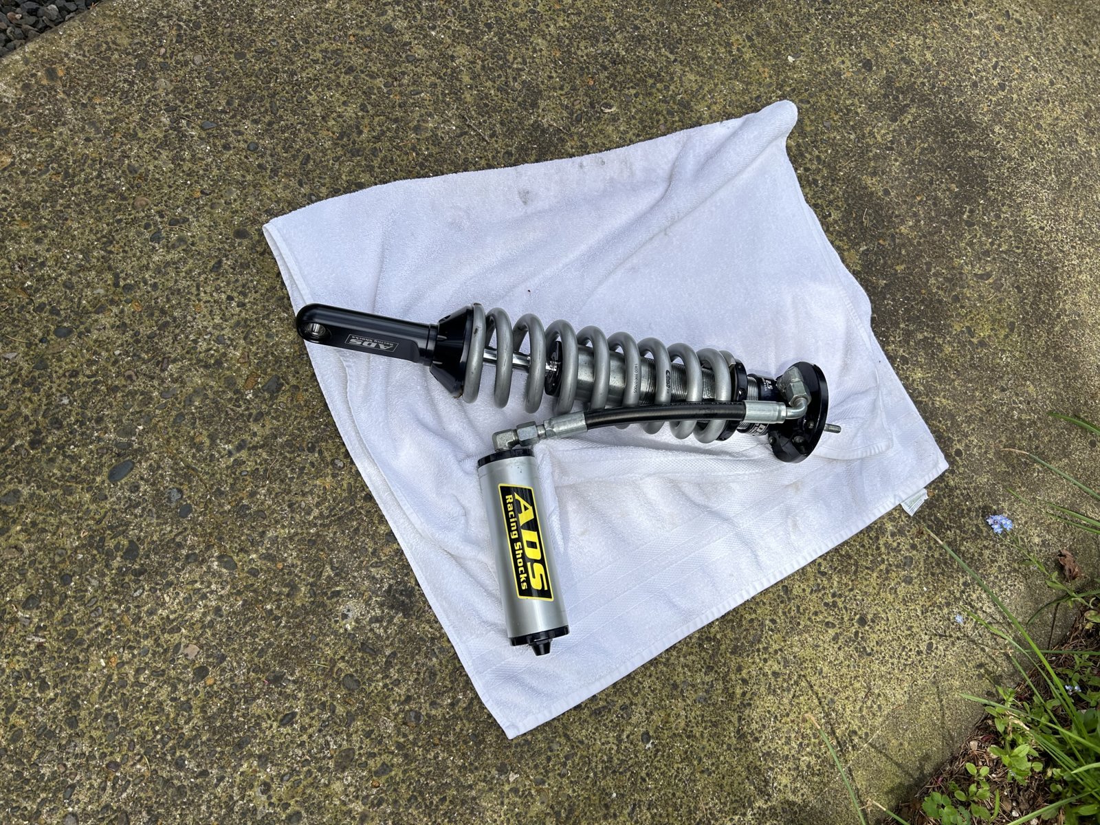

    I've got 250-T4006-070 ADS DIRECT FIT RACE SHOCKS on the way. There's not a whole lot of info on the site, I'm not sure if it's included with the shocks. They just say extended but I don't know what that means. Is there a set amount of lift or is it adjustable? They come with 700# coils, which seen to be less/the same as stock OR coils. If the preload is wound all the way up to the top, I assume that makes them softer? I have no extra armour up front outside of sliders and an AL skid plate.
    Does it come with a preload adjuster tool or is there one that I need to get? How long is the 700# coil?

    If they are direct fit (OEM replacement), it’s a 3”x14” coil. Extended just means the shocks have an extended length stroke compared to OEM travel shocks (usually .5”-1” greater). So you get tiny gains in terms of travel of the suspension (hey, 1-2” is a lot to some people).
    Ride height is adjustable from 1-2.5”. Preload, as the name implies, would be to preload or pre-compress the spring on the coilover. People tend to confuse adding preload with adding ride height, but the two are not the same. For example, if you had a coilover setup on the truck with 2” of lift, but then decided to add a bumper or some skids, causing the lift to drop 1.5”. To compensate the change in weight, you can do one of two things. 1) Swap for a heavier spring rate that maintains 2” of lift unloaded, or 2) Preload the existing coil spring so it’s compressed rate corresponds to the rate needed to restore 2” of lift. Make sense? It isn’t as simple to say a preloaded spring will be stiffer because every truck’s weight as kitted is variable.
    That being said, if you don’t have extra weight on your truck, 700# is a lot of spring on the Tacoma in a stock A-arm configuration. 600-650 is good for lighter to mid-weight setups. Either way, ADS are great adjustable and rebuildable coilovers. They’ve been working great for me.

    So it's possible to get 3" out of them, but it's done with longer coils rather than adjustments? Seems it's setup for 2-2.5" from factory

    Ride height is adjusted via the collar, and a 3.0x14" spring is the correct and longest spring that fits. Sorry if that wasn't clear, was giving you the concepts of spring preload vs ride height. You will need a spring compressor for adjustment turns on the collar. The springs will already have tension (a little preload) on them. They can get close to 3" of lift, but that height isn't optimal for suspension travel. Sweetspot for lift on an OEM replacement shock is around 1.5-2". And then additional lift can easily be gained with tires to get to 3" overall.

    how hard was it to get the shock out of the LCA? Did you loosen the LCA alignment bolts completely? Total time?

    If I were to use a 13x3 coil, would I just preload to get the same height as a 14x3 coil?
