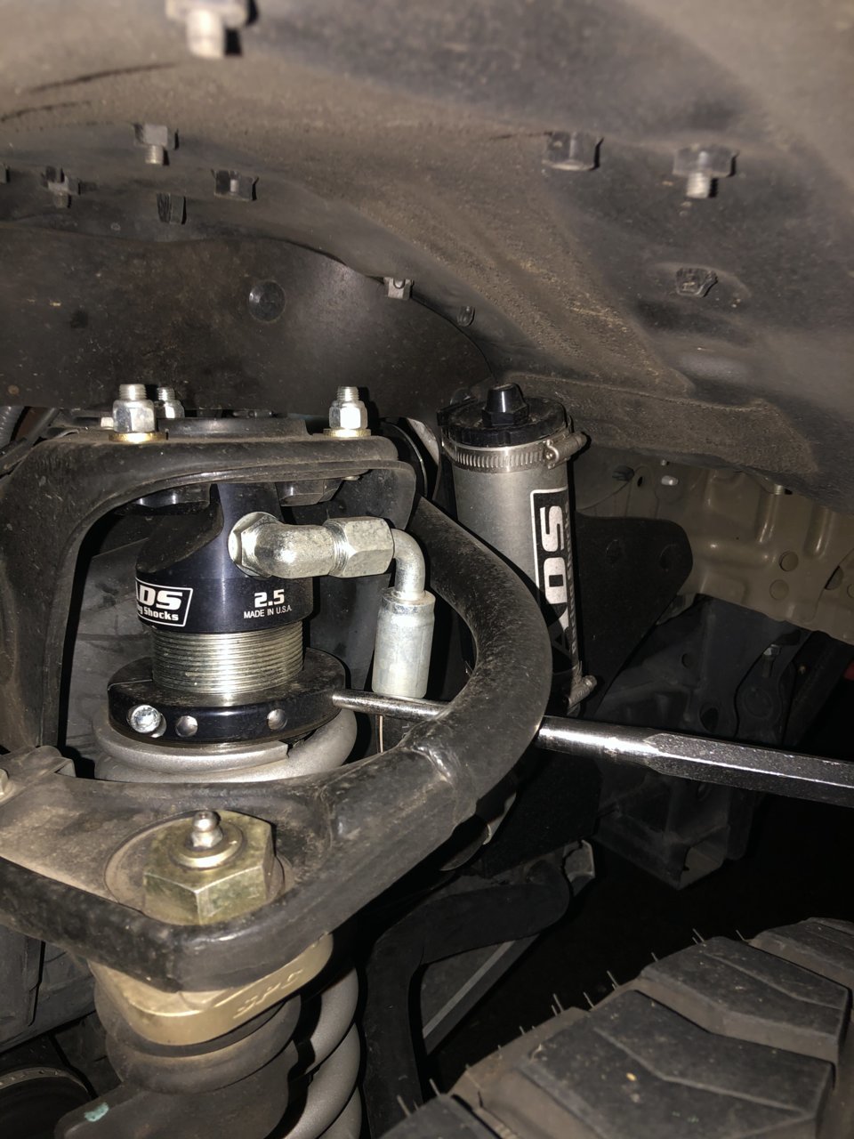

    I used this punch... Not doing it here just a mock up. You will need to compress the spring to adjust it
    Be Safe...

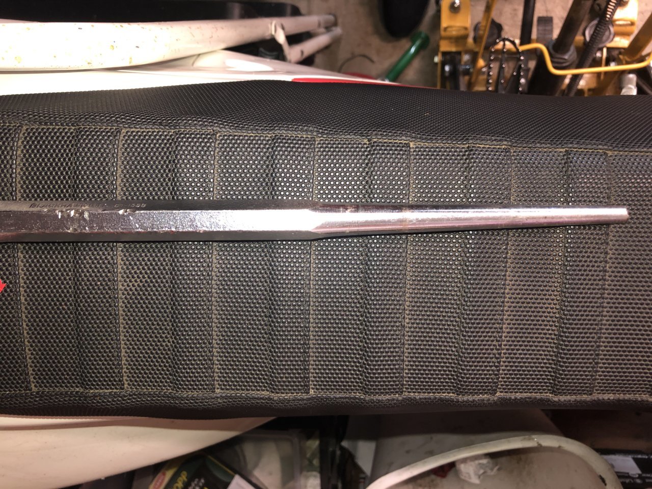

    None of the spanners have enough leverage. I bought a pin punch set from Princess: https://www.tacomaworld.com/posts/27212397/ My Icons use the 3/8". I can give you the 5/16" punch from my set if it works on yours.

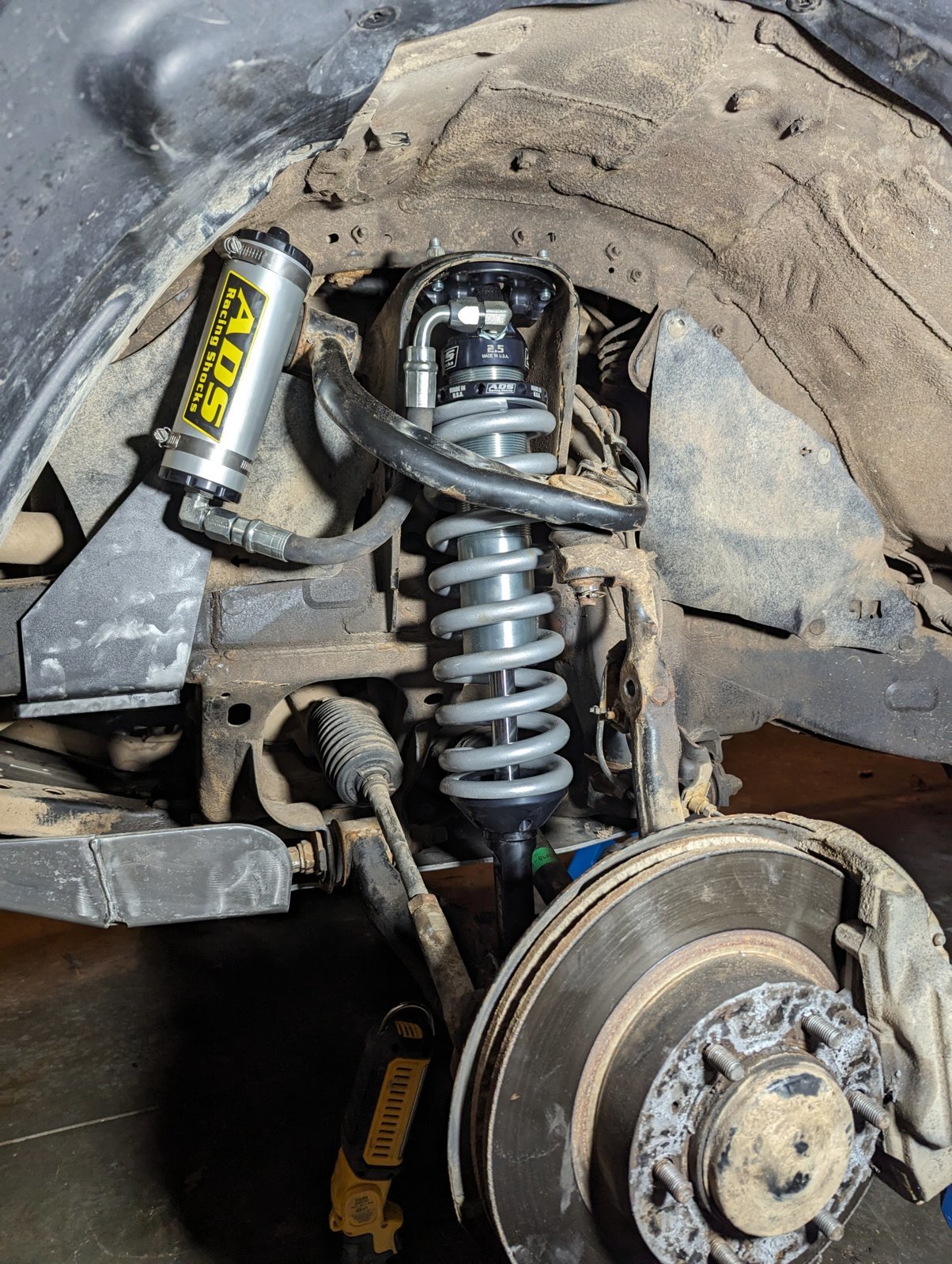

    7/8” of thread showing with a 14” 700# coil nets me 1.5” of lift.
    There’s no such thing above 3”(max) lift unless you do a bracket (frame cut) lift, or long travel - - theoretically you could crank them way up beyond 3” I guess, but that would be unrealistic for the purpose
    You should break the springs in as is and then decide on adjustment after it’s settled a bit.
