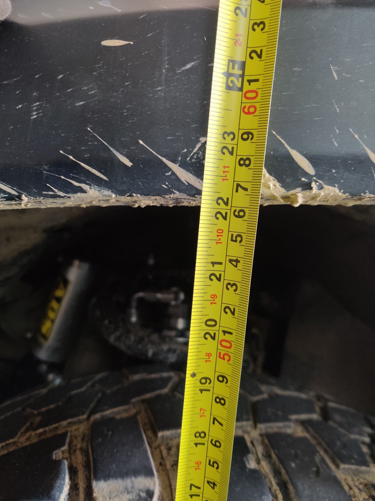

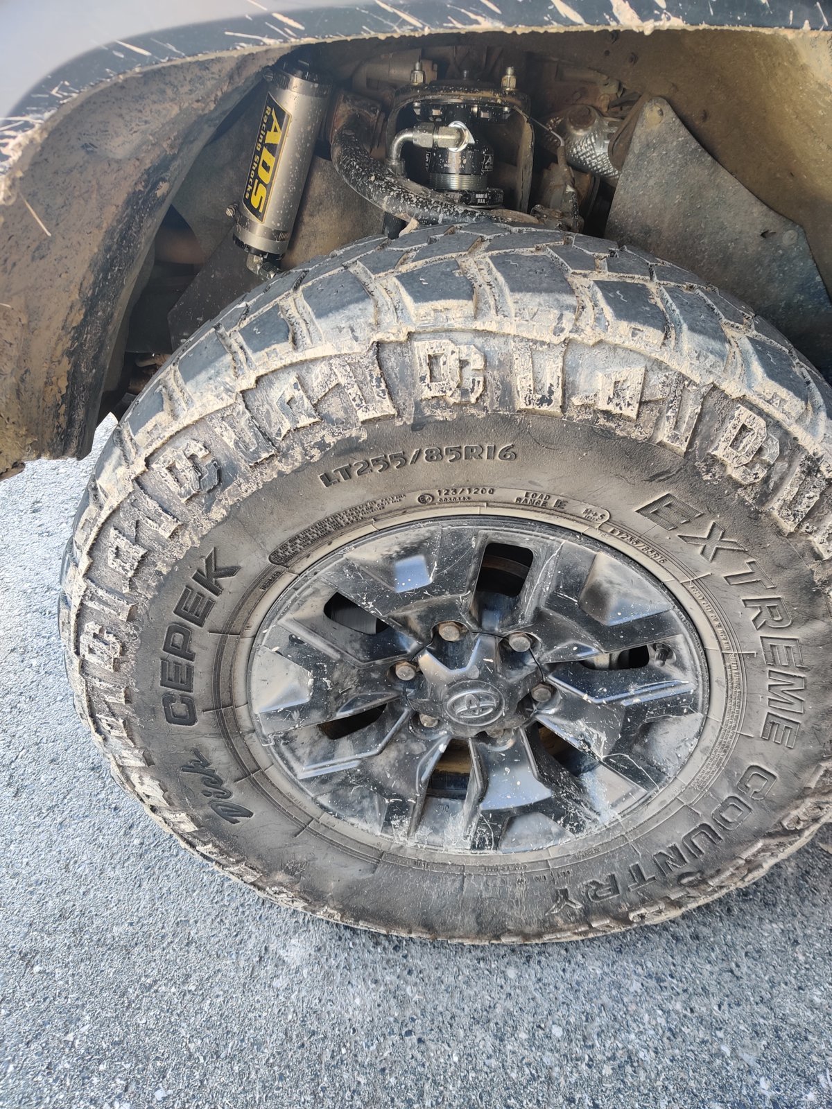

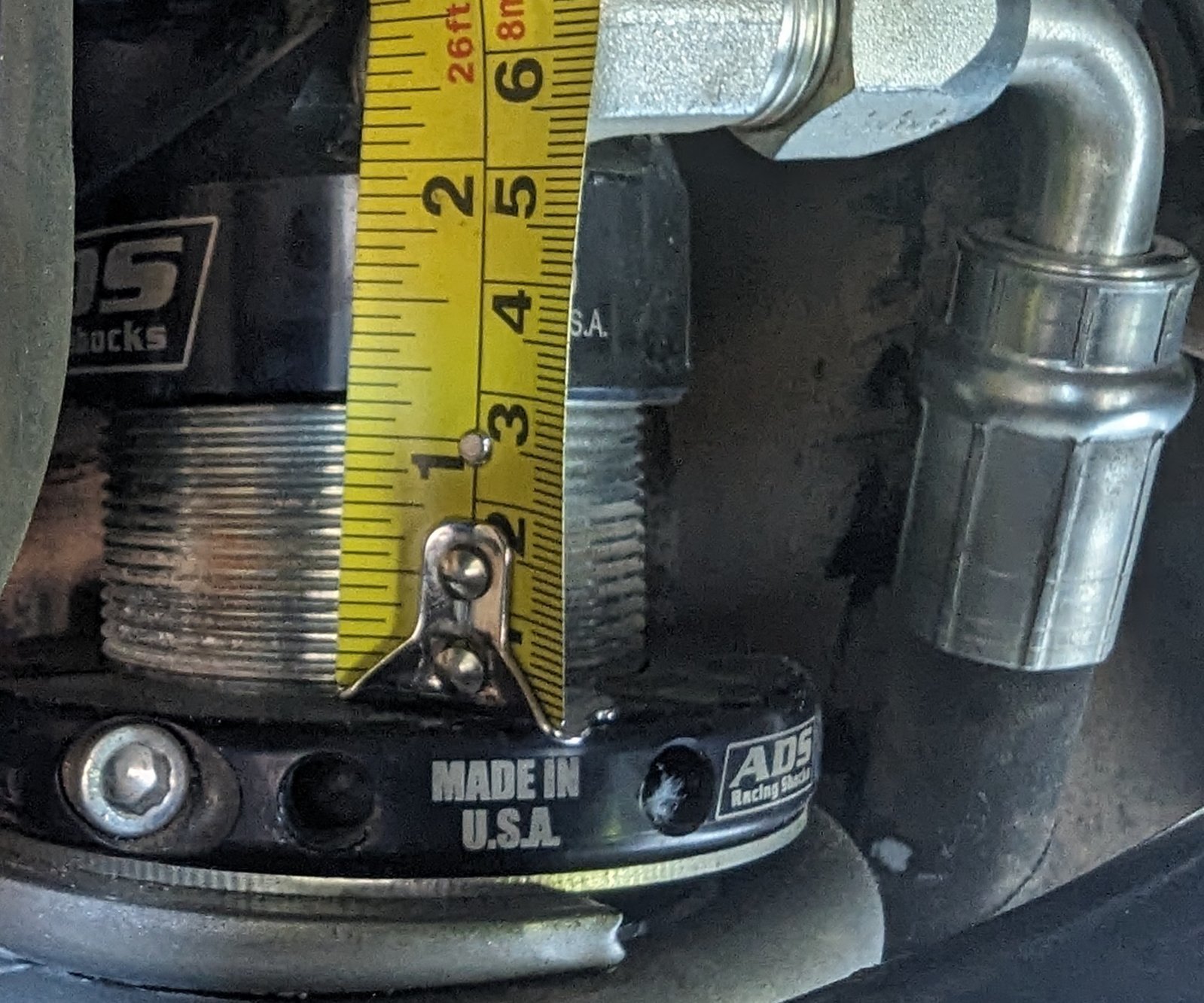

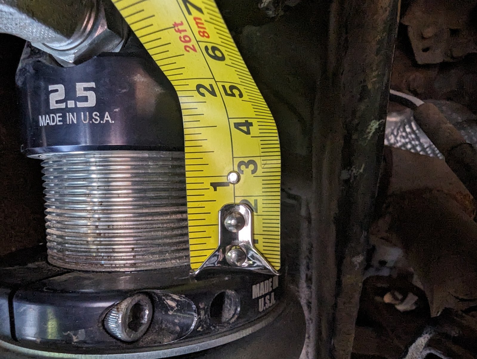

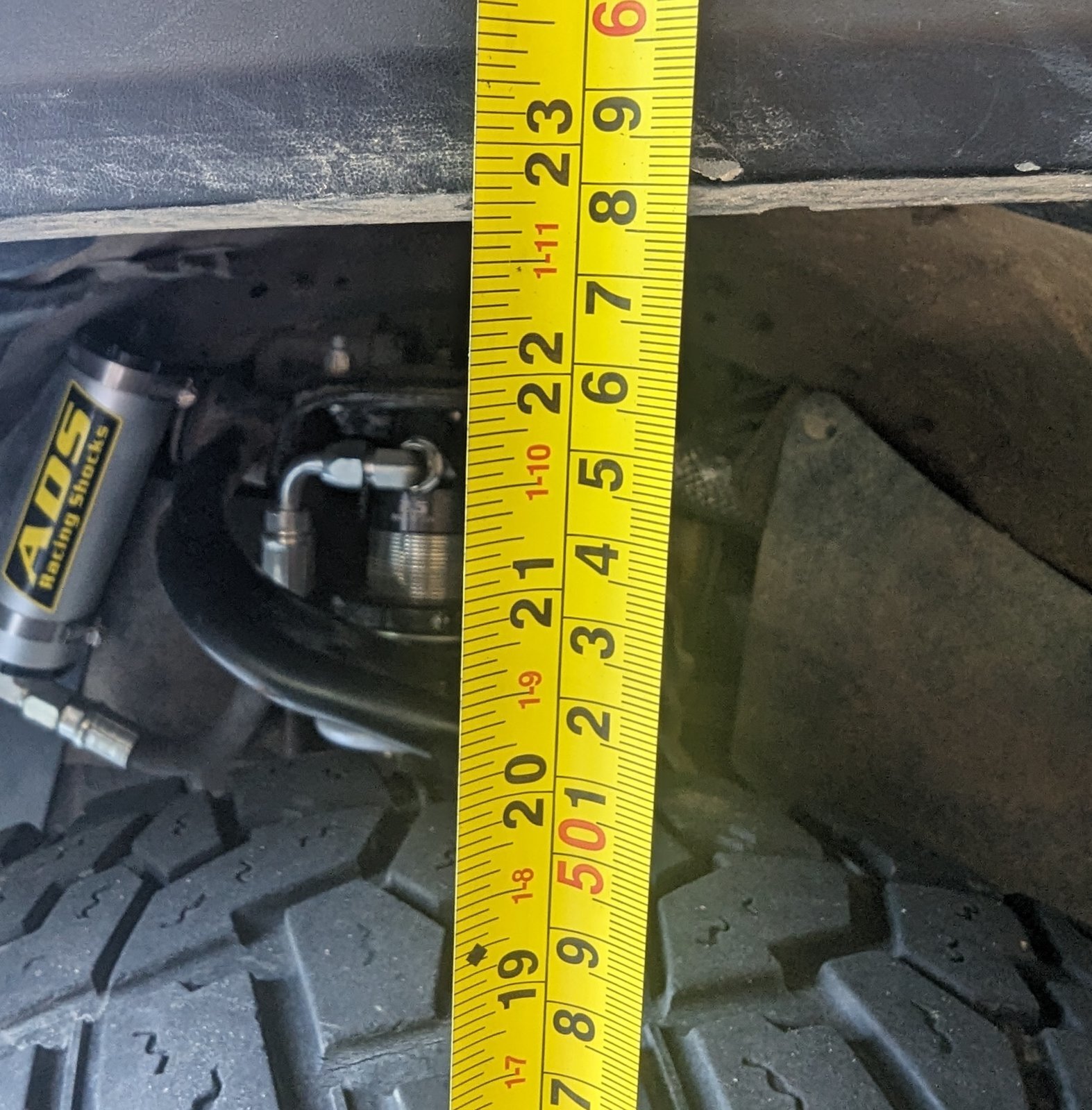

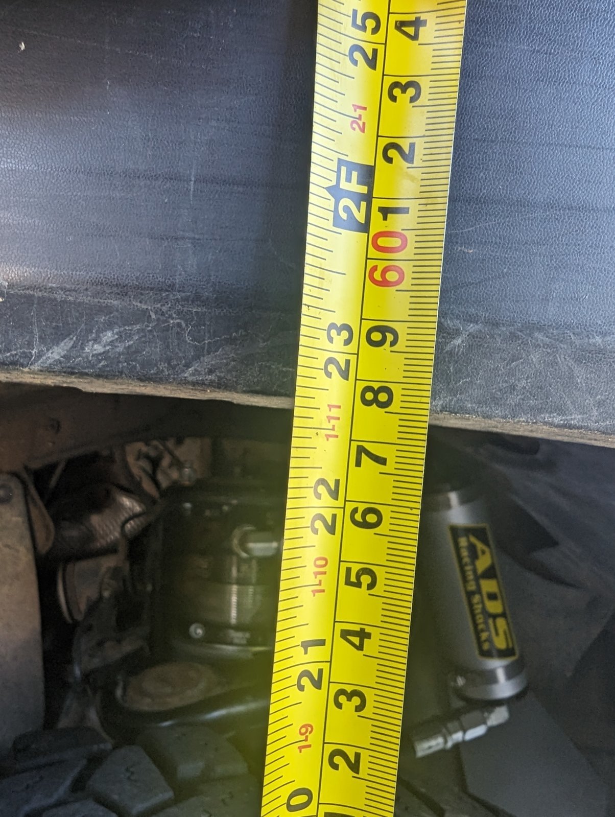

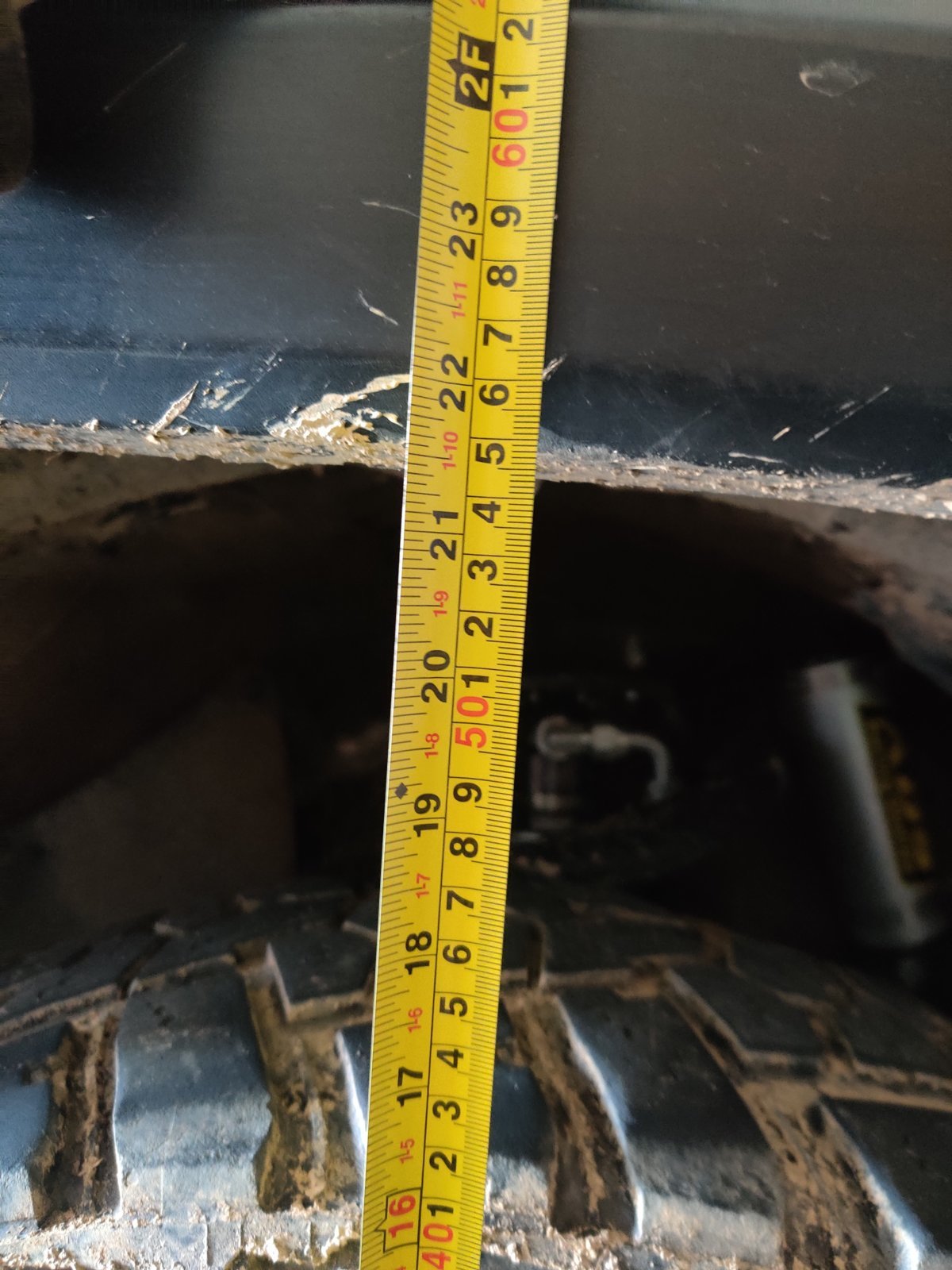

    How is this right?
    Driver hub to fender
    Passenger hub to fender
    That's like 1" and they haven't settled. I have alu skid, steel sliders and that's it

    That’s right. You have 1/2” of threads showing. Another 1/2” of threads will almost another 1” of lift.

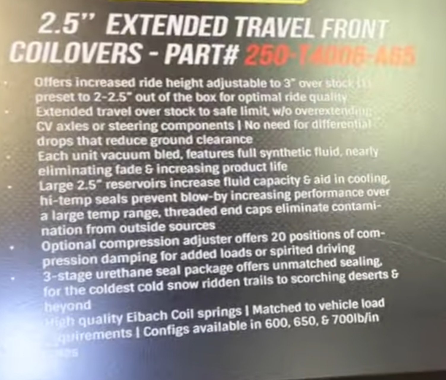

    I thought they were supposed to be setup for 2-2.5" from ADS. At least according to this. Screenshot_20240418-214325__01.jpg
    Am I able to unweight the truck and adjust them?

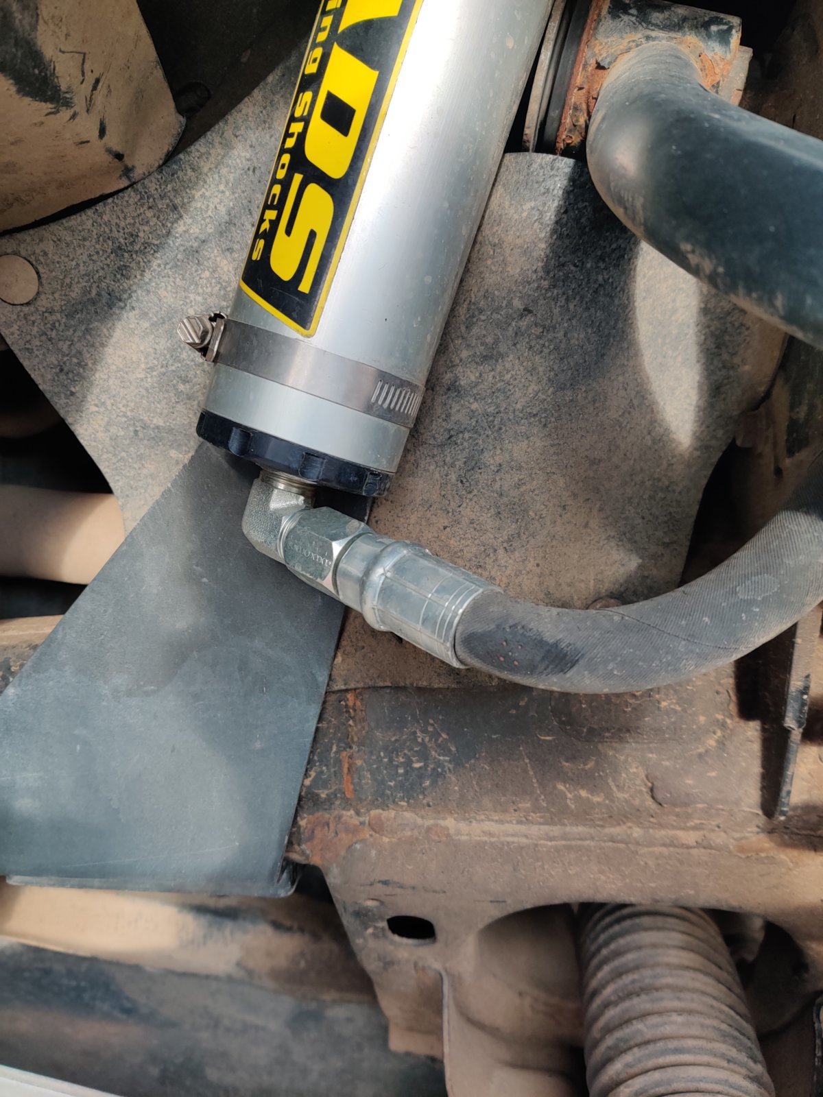

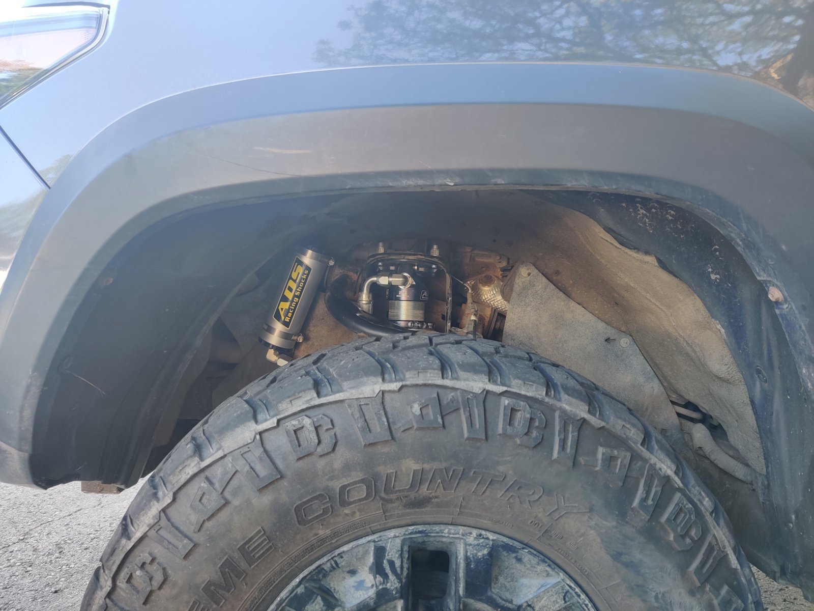

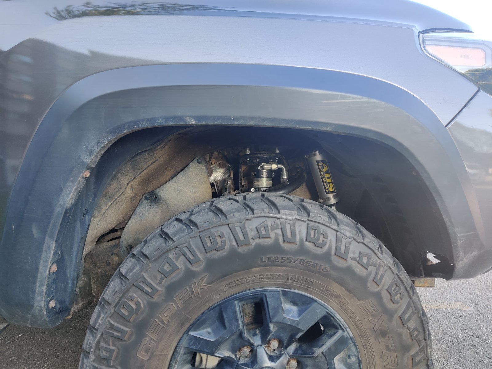

    Am I able to move this hose inward? I'm obviously rubbing

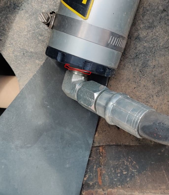

    Yes. Lightly loosen the silver nut I circled in red. By lightly, I mean only turn it like 30 degrees, less than a "flat." Then turn the 90 degree fitting to where you want it pointing and then retighten the silver nut.

    Loosen the Resi hose clamps and roll the entire resi in a little, it looks like it won't take much to clear the tire. You can also get some 3/4 ID heater hose, spilt it lengthwise and slide it over the resi hose, hold it in place with some zip ties.

    This is what I did. Although it's essentially just the hose clamps holding the position so if they loosen or vibrate, the resi will turn back outwards

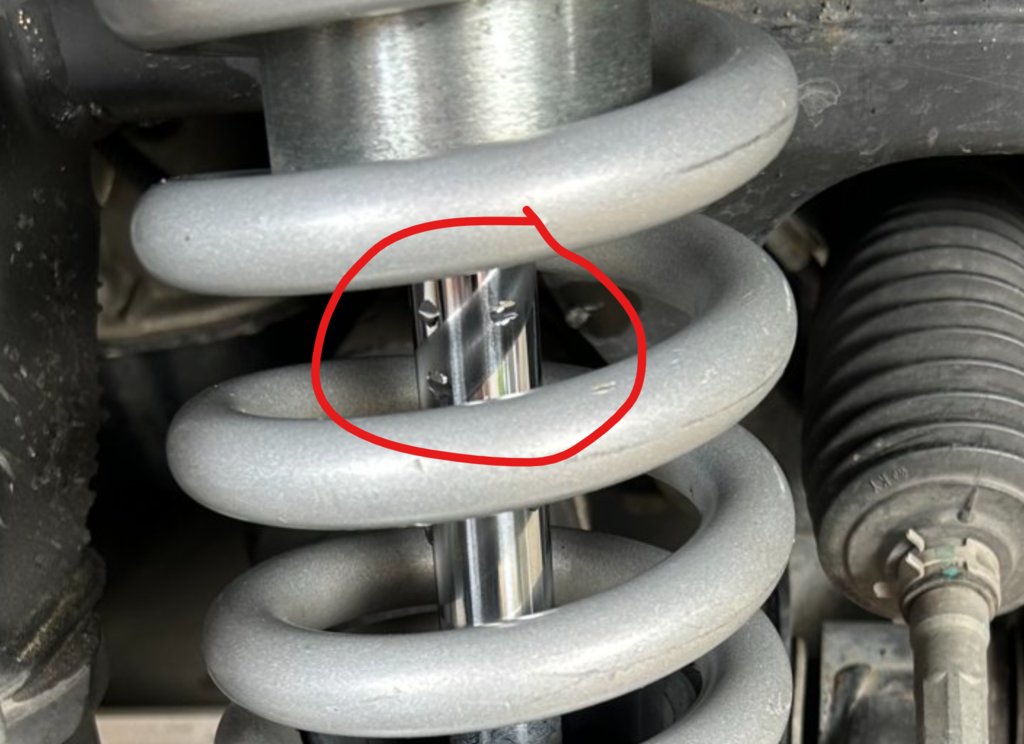

    Hi Dan, Is this just a reflection or is there damage on the shaft? If that is damage you may want to get it rebuilt soon. It will tear up the seals and oil will leak. I had a little scratch on the rear and it acted like a zipper to allow the oil to leak out.
