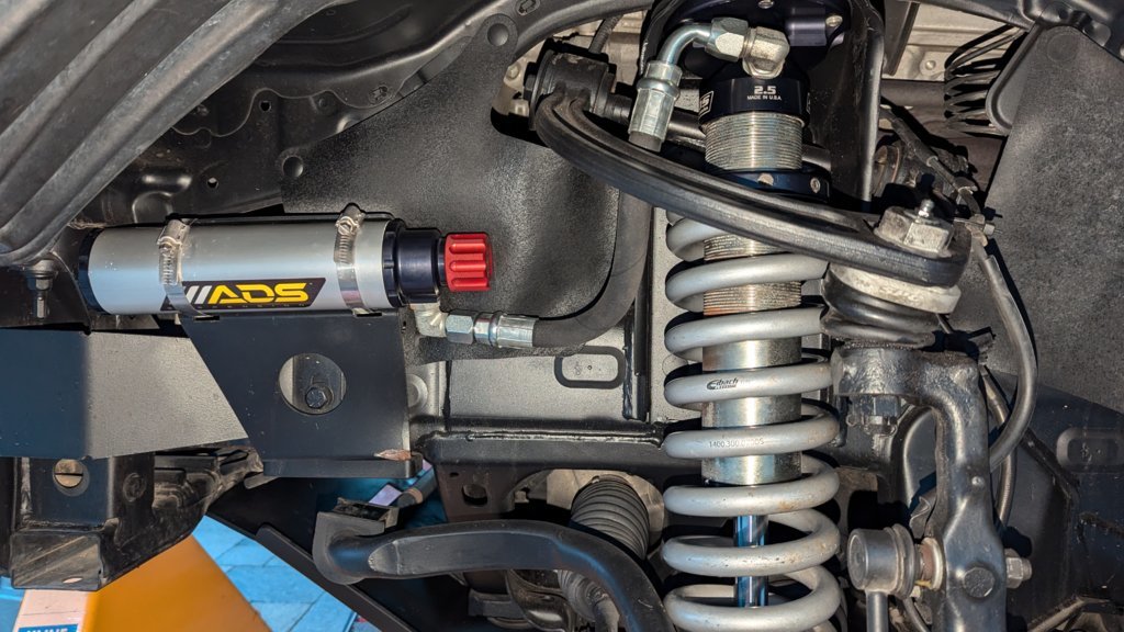

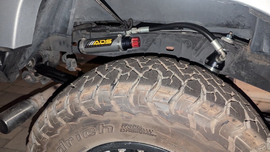

    Here is my front and rear setup after the refresh and some paint touch ups, works well for me, next rebuild I will go with longer springs... Thanks for the tips

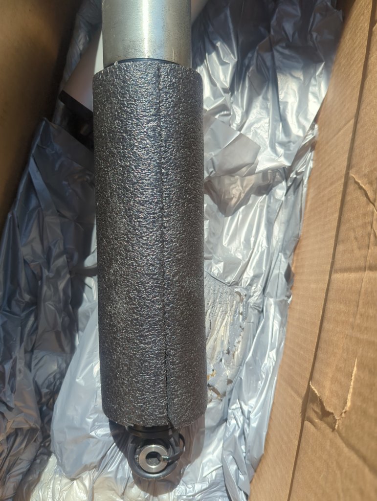

    Trimmed to about 4 inches but used the PTP to not get a new ding on the shaft during install.

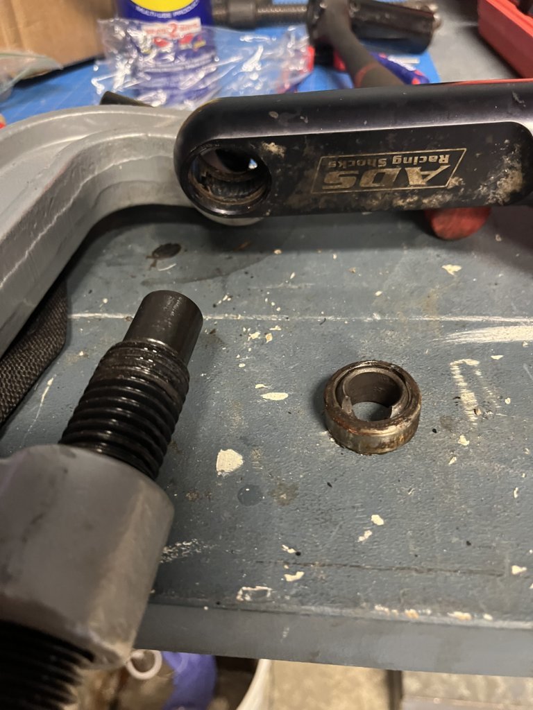

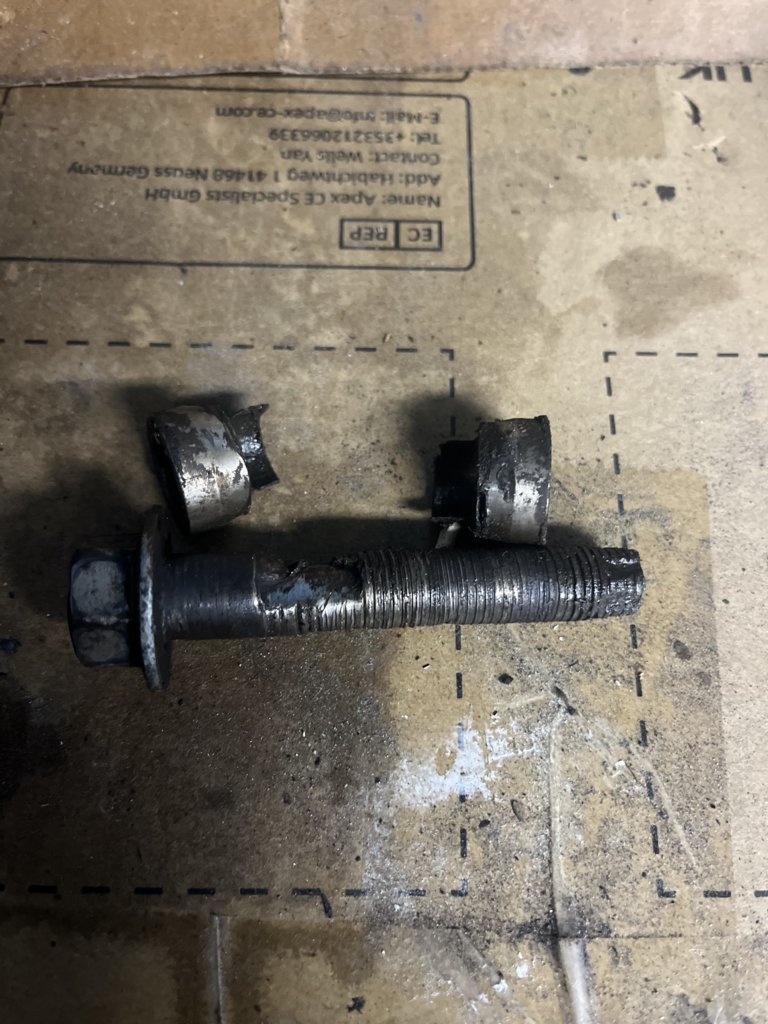

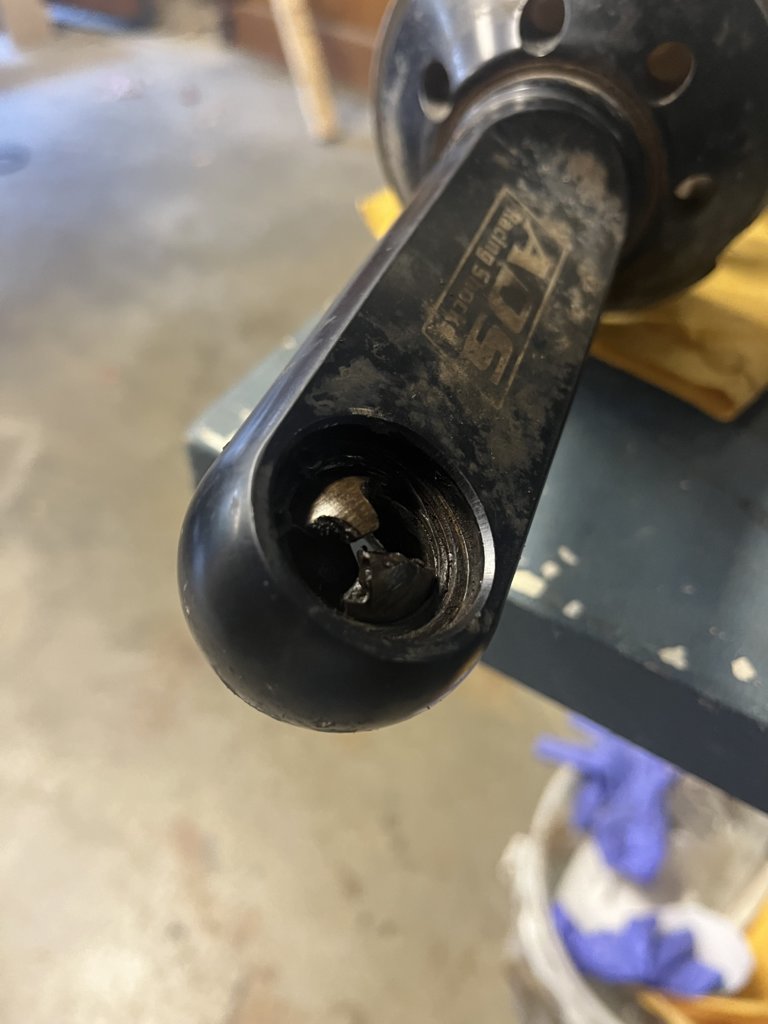

    Definitely highly recommend 303 shock services. I wasn’t planning on doing my spherical bearings until this winter but when I discovered how bad they were, I had to do something about them. Tim had everything in stock and overnighted what I needed to get everything put back together. 100% recommend the lower shock bolts he carries too. The straight shank just fits much better than the OEM tapered shank.

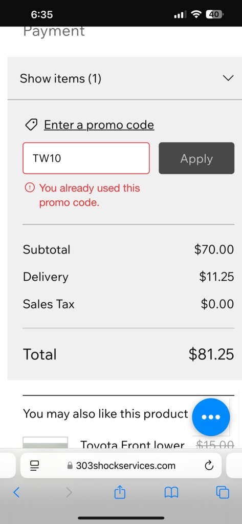

    I tried that and it didn’t work. Said I used it already.
