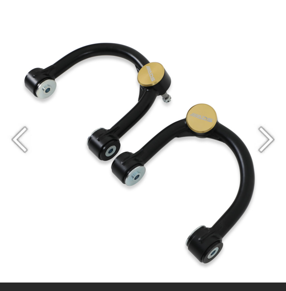

    I was checking those out too. The price is right and they look awesome. I'm also curious about how they positioned the balljoint for caster, and how those delrin bushings do.
