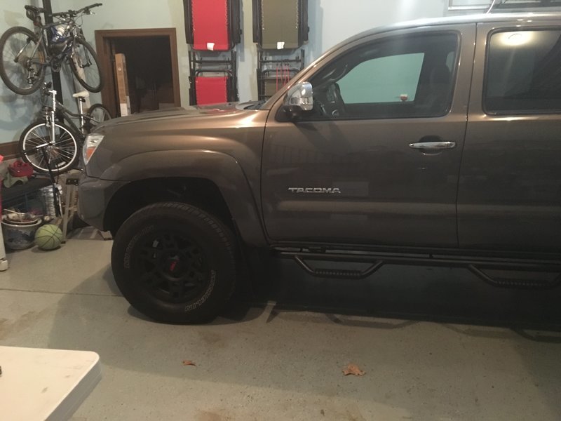

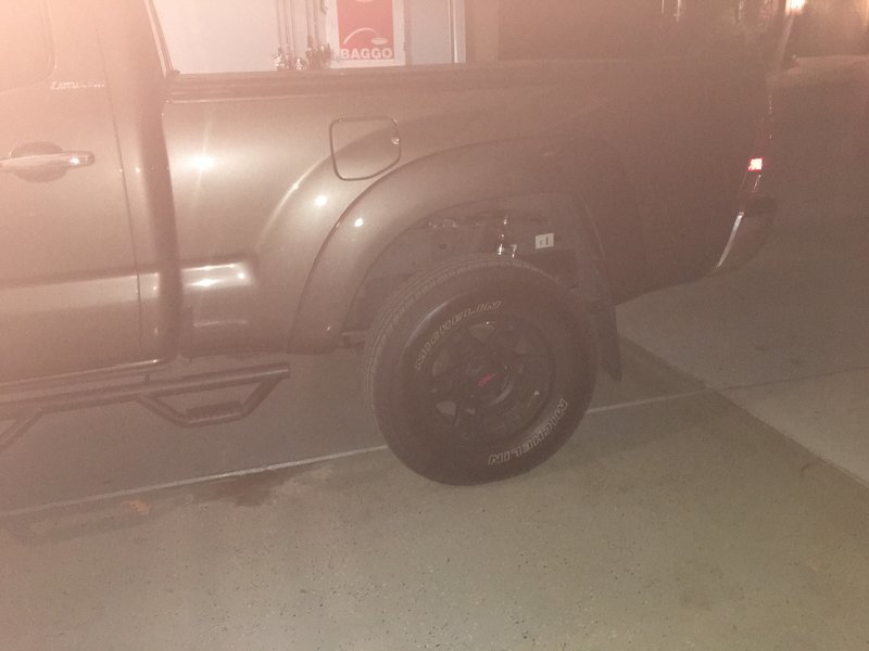

    rmepilot
    rmepilot Well-Known Member
    Jun 22, 2013
    #106798
    11,006
    Rob
    Huntsville, AL
    '23 LR DCSB TRD OR 4x4 Premium Pkg
    2019 Jeep GC Summit 5.7l '15 DCLB S/C 4x4 Limited Pyrite Mica - Deceased
    Poor quality pics, but it's Stella time.
