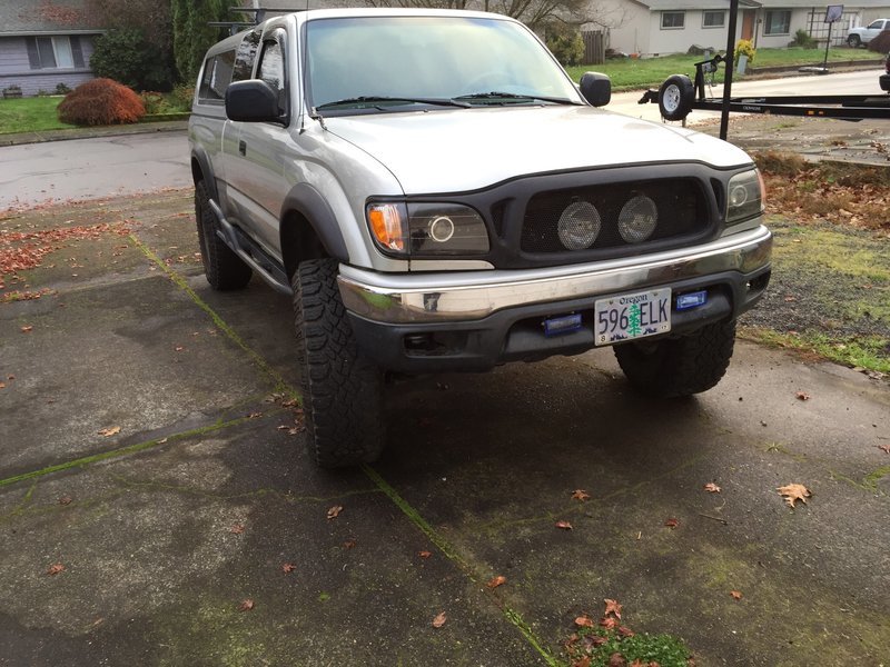

  5. Nov 10, 2016 at 8:26 PM
    #725
    Bennett707
    Bennett707 Station707
    Apr 28, 2012
    #77793
    33,223
    Oregon
    No more taco life for me
    wrapped on the mounting brackets that were provided.

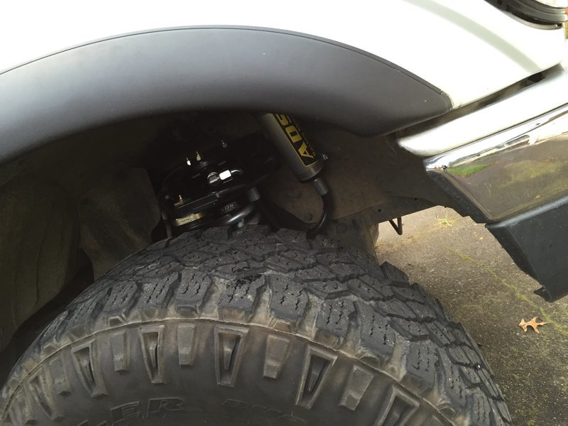

  6. Nov 10, 2016 at 8:28 PM
    #726
    Bennett707
    Apr 28, 2012
    #77793
    33,223
    Oregon
    the mounting brackets came with some self tapping screws
    i tossed em
    put a small bolt through an existing hole on both sides, and blamo. mounted.

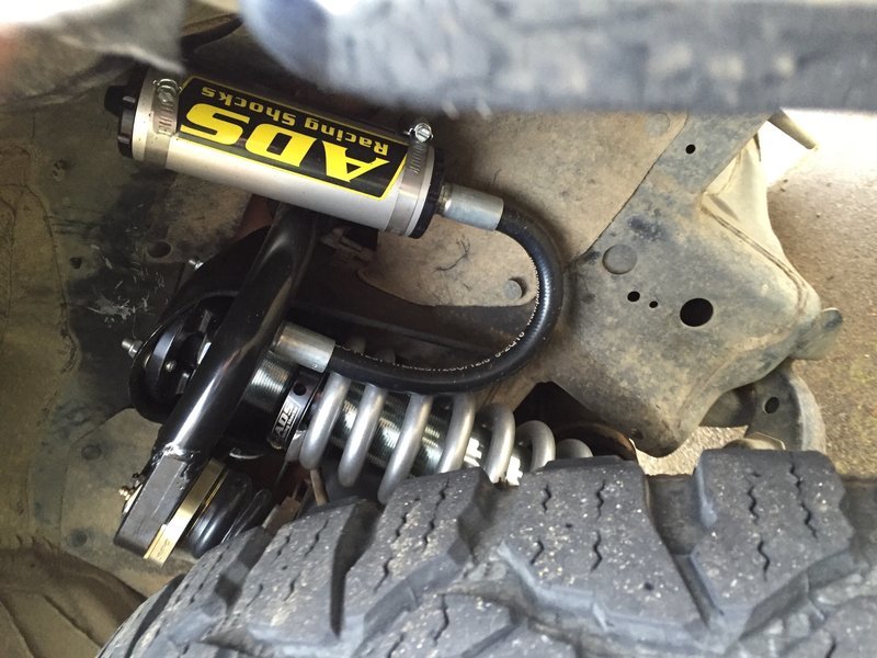

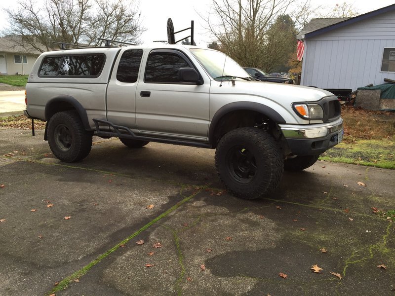

    2000 Sr5 xcab 4x4 v6 auto
    Hey Bennett u mind getting pics from the front to c angle of cv's and control arms and also measurement center of hub to bottom lip mid fender plz.
    Also how's the ride?

  9. Nov 11, 2016 at 7:24 AM
    #729
    Shortman5
    Shortman5 Well-Known Member
    Mar 30, 2013
    #100952
    2,725
    Supercharged TRD
    TRD S/C, ADS coilovers.
    Looks like a solid 3"...did you happen to measure hub to fender?
