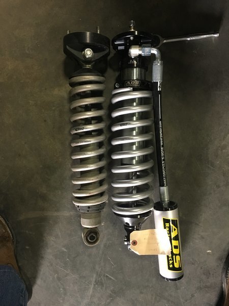

  13. Nov 12, 2016 at 3:31 PM
    #753
    Shortman5
    Shortman5 Well-Known Member
    Mar 30, 2013
    #100952
    2,725
    Supercharged TRD
    TRD S/C, ADS coilovers.
    IMG_1528.jpgHere's a side by side with BOSS COs
